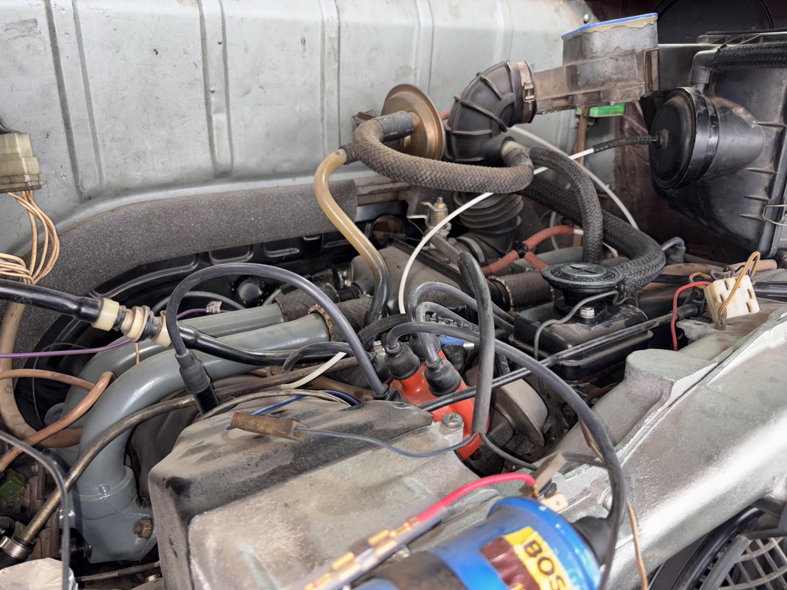

Six months indoor storage, with a full tank AND stabilizer? Post a picture so we can show you the vacuum leak already…

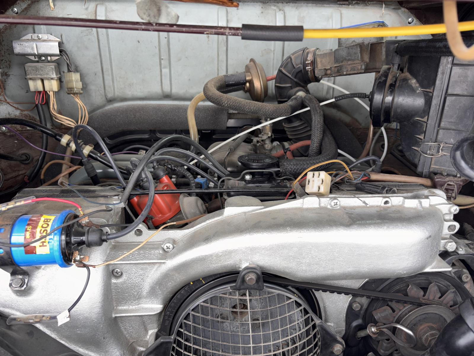

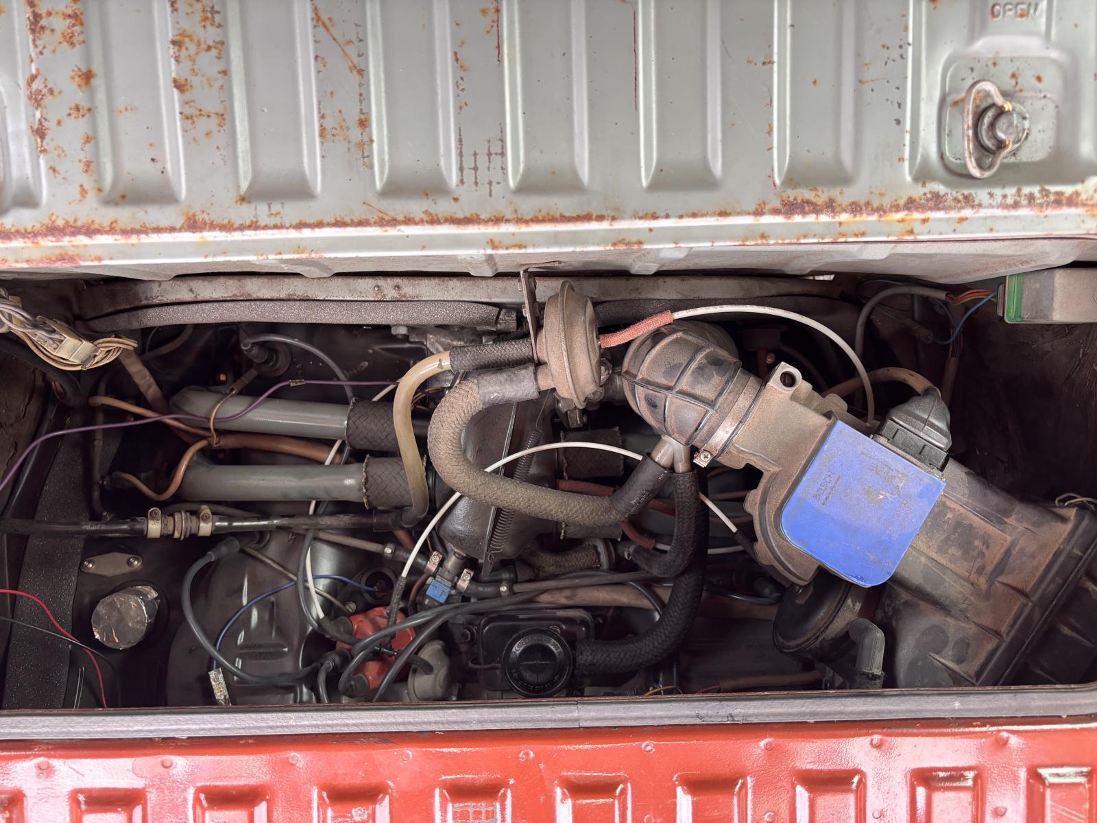

Some pics of the engine. Everything looks tight except for the large hose it was a bit loose but not detached. Bus started up and ran, then died. Didn’t smell any gas.

PostPosted: Tue Jun 10, 2025 2:59 pm    Post subject: Re: ‘78 CEII gas smell, rough running, no power…now dead Reply with quote
the hose on number 3 intake pipe looks out of place

PostPosted: Tue Jun 10, 2025 3:37 pm    Post subject: Re: ‘78 CEII gas smell, rough running, no power…now dead Reply with quote
Eagle eyes saw that.
yes, even if it is not leaking there, put a little silicone grease or spray around it and slide if back up so it is firmly on. If it is barely on.

PostPosted: Tue Jun 10, 2025 8:08 pm    Post subject: Re: ‘78 CEII gas smell, rough running, no power…now dead Reply with quote
Did not see that! Nice grab will check that tomorrow

PostPosted: Wed Jun 11, 2025 1:06 pm    Post subject: Re: ‘78 CEII gas smell, rough running, no power…now dead Reply with quote
Hose on number 3 tight
'78 Champagne Ed
