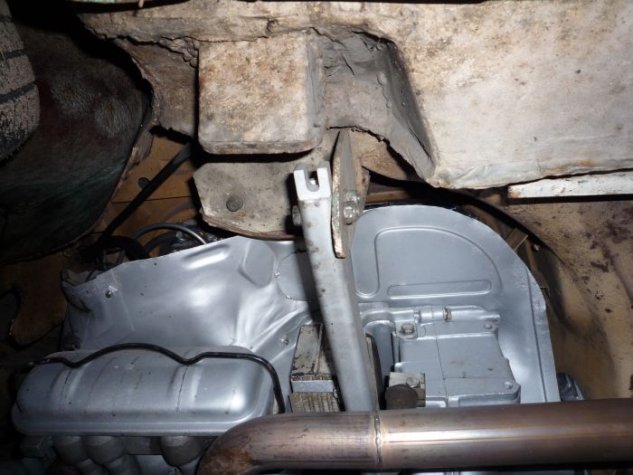

Angelo Amato
Joined: January 22, 2005
Posts: 83
Location: Wirral, england
Angelo Amato is offline
PostPosted: Fri Oct 15, 2010 4:44 pm    Post subject: Re: type 4 in a type 3? Reply with quote
OF COURSE IT DOES Wink
http://shoptalkforums.com/viewtopic.php?f=1&t=...3#p1030723
http://s836.photobucket.com/albums/zz283/Angelo_Amato/Fastback/
lupin..the..3rd wrote:
Anyone know if a type 4 engine will fit neatly into a type 3? Specifically, a squareback? Any examples / photos of this? I tried doing a forum search, but am not finding anything.

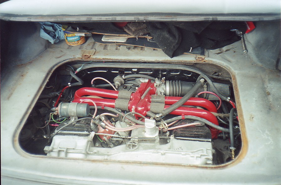

Bobnotch
Joined: July 06, 2003
Posts: 23358
Location: Kimball, Mi
Bobnotch is offline
PostPosted: Fri Oct 15, 2010 5:25 pm    Post subject: Reply with quote
blankmange wrote:
supaninja wrote:
Bobnotch has a clean install on his notch.
I thought it was tomnotch...
No, I have one in my Square-vert too. It's a 1.7L 914 engine. I still have the 2.0L that I took out of it though. Wink Mine's running D-jet. If the OP does a search of my screen name in the Gallery, in the Squareback section, he'll see a few pics there. Cool
It does fit very nicely, only slight trimming of the engine tin (on the left rear corner), and goes into the car almost as easily as a regular t-3 engine. Cool

Her's pics of my type 3 with type 4 engie
/Stefan
very nice

PostPosted: Sun Feb 05, 2012 3:03 pm    Post subject: Re: type 4 in a type 3? Reply with quote
That is a work of art!

PostPosted: Sun Feb 05, 2012 4:02 pm    Post subject: Re: type 4 in a type 3? Reply with quote
Delaware Dave wrote:
looks damn-near stock, eh?

PostPosted: Sun Feb 05, 2012 9:19 pm    Post subject: Reply with quote
Like a GLOVE!!

Bobnotch
Posts: 23358
Bobnotch is offline
PostPosted: Sun Feb 05, 2012 9:37 pm    Post subject: Reply with quote
Yup, fits right in. Here's an old shot of mine.

PostPosted: Thu Feb 09, 2012 1:34 pm    Post subject: Transmission Support Reply with quote
Nate M. wrote:
Like a GLOVE!!
How long have you been running this configuration? I ask because I see you are running a stock IRS sub rather than doing the conversion. Any issues with flex?
