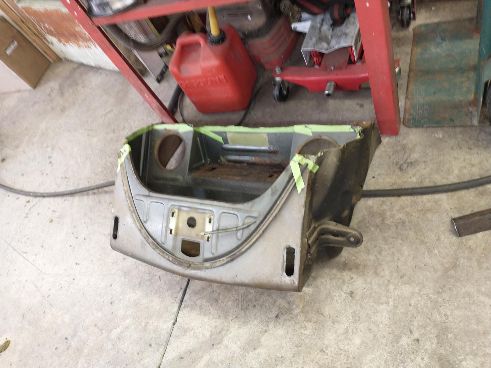

PostPosted: Sun Jan 23, 2022 8:22 pm    Post subject: Re: 1960 Front Apron Reply with quote
I have a 1960 that is chassis number 274**** and has a 4 finger front apron, and it only has 47,000 original miles.
dasbulliwagen
Joined: April 18, 2022
Posts: 9
Location: North Carolina
dasbulliwagen is offline
PostPosted: Thu Sep 28, 2023 4:20 pm    Post subject: Re: 1960 Front Apron Reply with quote
I recently cut the front apron off of my 1960, with vin 276****. It is a 4 finger, and I have no reason to believe it has been replaced, as it's a very clean car. Here's a pic.
