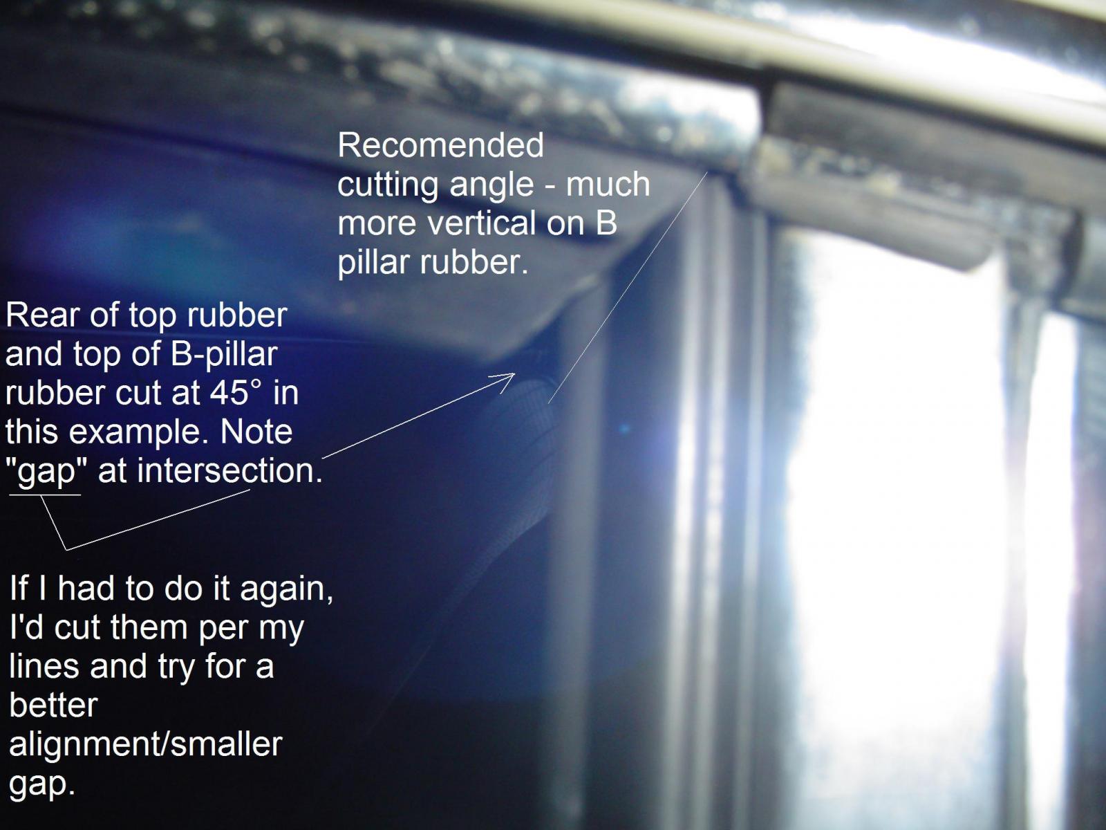

7)Rubber installation - You're going to be tempted to cut the rear of the long A-pillar/roof rubber and the top of the vertical B-pillar rubber at 45degrees. Don't do it! The long piece is thicker than the B pillar piece and a 45 degree cut on each will cause a triangular gap to form. The angles are more like 30 degrees on the vertical and 60 degrees on the thicker horizontal piece. This will require careful observation. Each piece is a little long, so you will get a few attempts. A tip for fine tuning the cut rubber edges is to use a sanding block and approx 150 grit paper.
Cool Once the angles look good at the rubber intersection, the bottom of the B-pillar piece is a square cut so that it goes across the top of the door. The bottom of the A pillar piece should be lined up with the upper edge of the door. The temptation will be to cut the rubber parallel with the bottom of the aluminum channel. Don't do it! The rubber will actually need to be slightly longer than the Aluminum channel, about 3/16".
