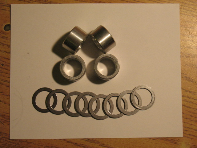

Heard a loud tapping when starting up my '76 2.0L FI bus with hydraulic lifters. I've had a lifter collapse before, so removed the valve cover on the loud side. I found that one of the exhaust valve push rods had slipped to the side and the top part of the rocker was striking the edge of the valve spring: the rocker had shifted to the right and was not centered. There's a hole in the push rod tube where the push rod was wearing against it at an angle.
I removed the lifter and it appears to be fine. This has happened twice to me over the last 2-3 years.
Only thing I can think is that due to not changing the oil for several months (I know, I know), the lifter got jammed with crud and did not pump up, allowing the push rod to shift. Any other ideas?

Hydro rocker shafts don't use springs, they should have solid spacers and thin wavy spring washers, who converted it to hydros?

PostPosted: Sun Feb 27, 2011 1:14 pm    Post subject: Reply with quote
Really?! Hm. Springs all round. That's how the bus came.
Anyone with pics of the solid spacers?

PostPosted: Sun Feb 27, 2011 1:45 pm    Post subject: Reply with quote

Ok. Wow. So should I replace the entire rocker assembly, or just the spacer?
Thanks much for the picture. Very enlightening.

Thanks for the help everyone. I've since put everything back together and the bus is running fine.
I asked at my local shop/junkyard, Austin VeeDub. It appears that the solid rocker spacers in EZ Gruv's picture are an after-market item. I was also shown a bug catalog illustrating that it's a fairly common modification on performance bug engines, but not so much for the Type IVs.
At any rate, from what I've seen (a stock '78 hydraulic lifter engine we looked at had springs) and been told, solid rocker spacers are NOT a factory-installed item - hydraulic lifters came with spring spacers as standard.
Could be wrong and definitely open to debate! There always seems to be a lot of surprising year-to-year variation with the buses. Just hoping this helps someone out down the road.

At any rate, from what I've seen (a stock '78 hydraulic lifter engine we looked at had springs) and been told, solid rocker spacers are NOT a factory-installed item.
Nope, its factory.

Well lets split some hairs, what you refer to as "solid" VW rocker spacers really where not "solid", VW still used spring washers, better than just having the single spring but really not solid. This kit makes a set of solid rocker spacers.
VW went to the solid spacers with the hydraulic valves exactly to prevent the problem you are seeing from occurring. With solid lifters the rockers has a moment to recenter each time the lifter ran over the base circle of the cam and there was momentarily a little lash. With hydraulics there is always some compressive force on the valve train even when the lifter is on the base circle, so the rocker can be pushed to the side over a number of revolutions.
