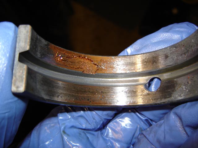

Number two bearing shells, now I know where the copper in the filter came from. Would overheating cause this?

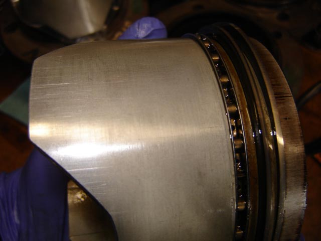

The pistons look good to me though this one has some scratches, will measure them up to be sure. The cylinders still have the cross hatching and don't look worn at all. Reusable?

All your bearings look like they have had metal bits run through them, maybe the oil cooler for full of crap after the first disaster and should have been changed out then.
Your piston looks very low mileage.

Based on what you have told us, I'm of the opinion that the "over heat" by the Previous Owner really trashed the bearings..... thus the copper showing with the lead babbitt all but gone! HEAT

Thanks for the replies. The oil cooler is definitely going to be replaced with this rebuild. The pistons only have 12000 miles on them so I am planning on reusing them as is after cleanup and checking the rings for wear, hadn't considered re-ringing but maybe I should at this point.
