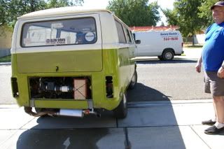

ej20 G in a 78 bay my husband did it all himself. Has the kenedy adapter, but he welded many pieces from scratch. Has the subaru heating system and the subaru a/c. This is a picture of me pulling it out for it's maiden voyage around the block. And yes this has the turbo
[/img]

| rick_spiff wrote: |
ej22 in a 78 bay my husband did it all himself. Has the kenedy adapter, but he welded many pieces from scratch. Has the subaru heating system and the subaru a/c. This is a picture of me pulling it out for it's maiden voyage around the block. And yes this has the turbo
[/img] |
i wanna see more pics of this install _________________ proud owner of a defunct 1979 sunroof kombi

rick_spiff Samba Member
Joined: August 13, 2008 Posts: 31 Location: Richland, Washington
| Back to top |

Posted: Fri Jan 09, 2009 9:32 am Post subject: |
Umm... bad link, you may have to sign out of your site before you get a url that non members can find. _________________ Rust NEVER sleeps and stock never goes out of style.

Posted: Fri Jan 09, 2009 12:47 pm Post subject: |
fixed! sorry about that.
and I was corrected by the husband. It's an ej20 G with turbo. Pulled from a 94 wrx japanese wagon.

Posted: Fri Jan 09, 2009 1:05 pm Post subject: |
Still not linking to your thread, opens the main forum page only. I'm assuming you are Dilly but can't find any build thread. What's it titled as and what section is it in? _________________ Rust NEVER sleeps and stock never goes out of style.
