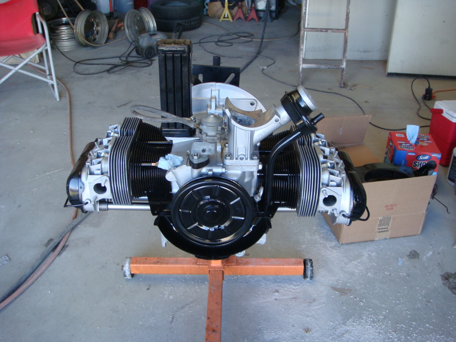

I used some cleaner called purple power and then used heat paint for the final. The only thing I replaced was the push rod tubes.
Before:
After:
Before:
After:
Really, for the case and the heads the ONLY thing you did was wash it with Purple Power?!?
IF this is true, this is absolutely AMAZING!! I've never ever seen a cleaner get any engine this bright and clean and even! It looks like it was blasted.
You painted the silver right??
It is 100% obvious you painted the black.
Please confirm, Purple Power ONLY ?

analogmax
Joined: September 27, 2006
Posts: 161
Location: Chandler, Arizona
analogmax is offline
PostPosted: Tue Dec 14, 2010 10:14 am    Post subject: Reply with quote
I just used purple power and a brush then painted the case and other parts with heat paint.

PostPosted: Tue Dec 14, 2010 10:53 am    Post subject: Reply with quote
Thanks, that's what I suspected, it was way too clean to be just the naked case and heads in that photo!
We won't get into the argument extolling the pros and cons of painting these components. It's been done.
