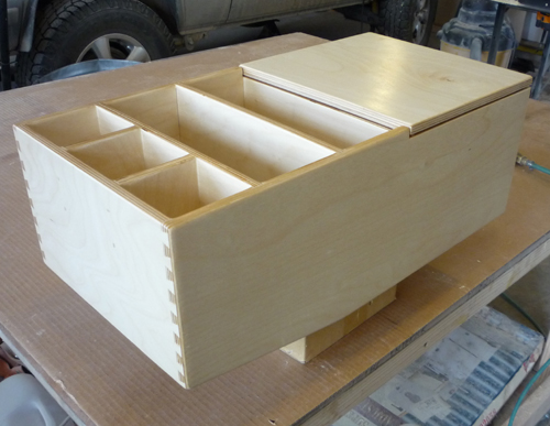

My vans' PO had built a center box for the walk way. He brought it to me a year
after I purchased my van. I have used it tough, it seems too big for what I'd like.
He constructed it out of plywood and he did a very nice job with the jointry.
He even routed a groove into the side of so the box can stay in place while the
passenger seat is being swiveled. I thought about covering it with that cheepo
carpeting for speakers and make it blend in better, but then it's the whole can't climb
over it to get to the back seat. I don't want my vans' interior to be any more of an
obstacle course than it already gets

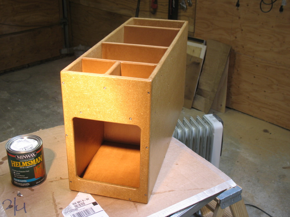

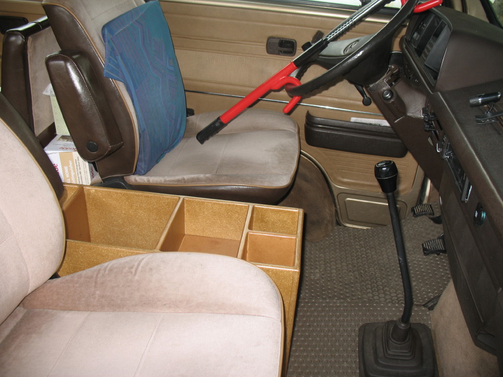

I built one last Spring:
I looked at several store-bought consoles first for ideas. One complaint many had is that not all potential space was utilized, particularly under the cup holders.
So I designed a front horizontal access bin, right behind the shift lever, under the cup holders, for seldom used stuff.
In the rear, accessible from the main cabin area, are two little cubbys for lighters, keys, headlamps, lip balm, etc.
All those cubbies have a curbed shelf so stuff can't go sliding off.
We had a number of design criteria, it had to accomodate:
coffee and other beverages in a variety of containers
a six pack
tissue box
thermos
small waste bin
have some "secret" storage
easily portable
I suggest making it narrow enough to:
1.easily reach seatbelts (both sides!) and e-brake, and aisle power socket.
2.swivel the seat without rubbing
I like the idea of an open aisle but:
1. where to put all that little stuff, and my coffee
2. we have a dog who wants to be underfoot, the console keeps him in back.
3. Ours is easily moveable.
Good points on potential projectile. While I like that ours is easily moved from the aisle, I will consider rigging some sort of attachment/quick release. We already have the GW eyebolt seat belt bolts, maybe I will make use of them with a strap.
I added about a 7/8" shim on bottom towards the back of the console to make up for the downsloping aisle floor. It doesn't slide around on the rubber aisle mat. I have also since added "drawer liner" type material to dampen vibration and rattling of contents.
Overall we find it very useful for keeping organized on road trips and in camp. In the interest of research maybe we should "forget" it on a trip to test out the open aisle experience.[/img]

I've built a few of these, always tweaking it to make it better. I angled the bottom to match the floor and stopped it just forward of the seat belt bolt to preserve the walk thru ability. I can step over it just fine and the seat still swivels.
This is my current setup with the dash mounted unit, the black disappears which I like. The material is 12mm baltic birch with a lacquer finish, dovetailed at the corners with a PC Omnijig. Bamboo would be a nice choice because of looks and it dovetails nicely but it is 200$ a sheet vs 30$ for BB.
With a lid:

I have used this low profile console for a few years - works for us. Cup holders and a small tray for miscellaneous stuff. Still allows easy movement to the back of the Westy. And it's easy to move out of the way when we're at a campsite and want the space for other uses.
I have the cup holders facing the other direction than what you see in the photo above - i.e., facing towards the front. It has "teeth" on the bottom of the unit - so it never moves when driving...
We have cup holders in the doors as well (covers old power window switch slots), but I'm uncomfortable with a hot cup of coffee so close to the steering wheel.
With a lid:
sweet setup! How'd you do the jointery on the console?
do you have a detail shot of the dash cupholder?
