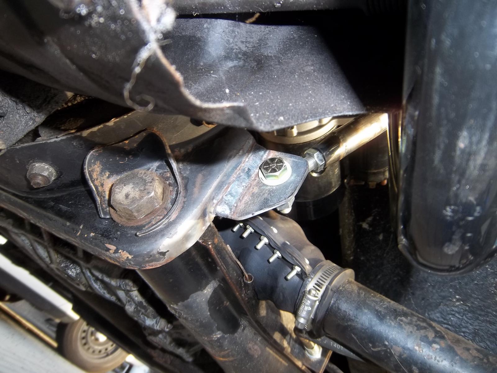

Thanks BL3Manx. I always look forward to your advice and posts. My build was hung up by the slight rear body sag and came up with a kafer bar style as you suggested to others. Made posts to the thread for rear body spacer as it seems like this is somewhat of a common problem with some buggies.
I did a test fit of the windshield with the gasket but it looks like it won't flatten down enough at the edges. Plastic surgery may be needed.
I know the Manx has a separate dash but mine is one piece to the hood. How close is the windshield usually to the wiper shaft openings?
Here are some pics of support and the area where the rear seat was rubbing on trans. Also check out the custom alteration the previous owner did to accommodate the doghouse cooler.
All comments are welcome.
