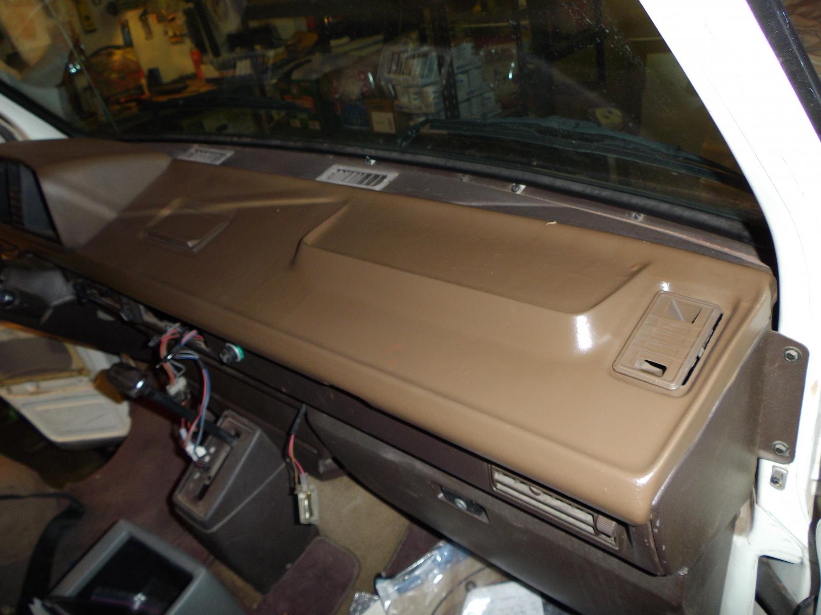

Remember back when I got that weekender from down in Phoenix? Remember the dash that was sun damaged and cracked like the floor of Death Valley? Remember how The Missus laughed and called me the patron saint of lost causes? Remember that 10 bucks you borrowed from me in that joint down by Matamoros? (Okay, all but that last one...)
Anyway, here's what it looked like 'before'.
And, after a few months of messing around with it:
Now ain't you sorry that you took up sides with The Missus? I told you that old bat don't know nothin' about Westies. In fact, she is simply the worst dunder headed....
"Uh, what Darlin'? No, no; I was just chattin' with the usual deadbeats in the garage. Yeah, I was just sayin' how smart you was, and how much help on the Westies. No, I said that was Jazzydog that don't know nothin'..... OH, Uh, just pry her jaws apart a little, willya and I'll get the iodine..."

Okay, since you are begging to know how I did this, and since you now suddenly remember that 15 bucks you owe me...
First, I got some bodacious mean sandpaper and smoothed the surface as much as I could. Then I tried the SEM vinyl repair stuff in a tube. I didn't like it none at all! It worked okay at filling the cracks, but it didn't dry static. Rather, it was rubberish, and I couldn't sand the stuff well at all. Plus, it didn't dry smooth, but had little pits in the finish.
Then, I figgered that even though the dash was vinyl and 'padded', it wasn't exactly soft. In fact, it was hard as a rock. So I filled the cracks with red glazing compound, like you would use to repair rock chips on the paint. I used a very thin layer, and rubbed it in vigorously with my finger until all the cracks were filled. Then I used the rough sanding block again and got it all smooth. In fact, the hardest part was smoothing the filler, but leaving the texture of the original vinyl cover. Then, I used SEM vinyl paint and gave it six coats. If I'm lucky, the vinyl paint will help bind the filler and keep the surface somewhat flexible.
But most of all, I didn't have to remove the dash to do the job. In case you haven't had the pleasure, removing a westy dash is just about as fun as trying to pry a donut away from Patty Preameaux, the 300 pound hoochie coochie dancer over at Bubba Boudreaux's Bait 'N Booze.
And I know it's a different color. My carefully thunk out plan was to match the tan of the upholstery panels and the door cards. It'll be easy to go back to the darker color if I want, but I'll see what this does for me first.

Well, I'll keep the forum informed about the results. I worried about using a rigid bondo-like material to fill the cracks in what was originally a flexible surface. However, I think it held well and the vinyl paint should hold it together. There were still small cracks in the surface and you can see the imprints of some of the larger ones which were filled. Still, it only took a day and about $30 worth of materials. And I avoided taking the dash out, which was a job I wasn't looking forward to tackling.
