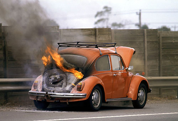

Cool car, congrats to you (I'd rip off all the Herbie stuff, but that's me). You will want to get that fuel filter out of the engine compartment, too. They can leak and then you end up with this:
Best spot to relocate it is either underneath the fuel tank or in the rear as the fuel line exits the chassis. Technically the car already has a fuel filter in the tank in the form of a mesh screen that is around the tube that exits out the bottom. Good luck with it! I like the wheels, too.

+1 on relocating the fuel filter. I even replaced mine with a solid metal one.

Looks like the AD cases started in 1970 and were the first of the dual oil pressure relief valve cases and were 1600 engines 60 hp. Trans sounds normal. If it grinds going into second the syncro's may be worn make sure to use a good GL-4 gear lube for it's brass parts. Gear lubes that are too lightweight cans cause problems shifting. If it just does not want to drop easily into second, that is a miss aligned shifter stick. Just loosen the 2 bolts at the bottom of the shifter and position it better. "A bit tricky" You want it to shift nice between 1st and second without hanging up on either one. Make sure not to get it so you can put it into reverse without pushing down. While adjusting things make sure it is also shifting between 3rd and 4th nicely too. VW beetles to have a bit of play in the stock shifter. I like it. It could have some worn parts but they last forever. Good advice on the metal fuel filter and putting it under that hot motor instead of over.
