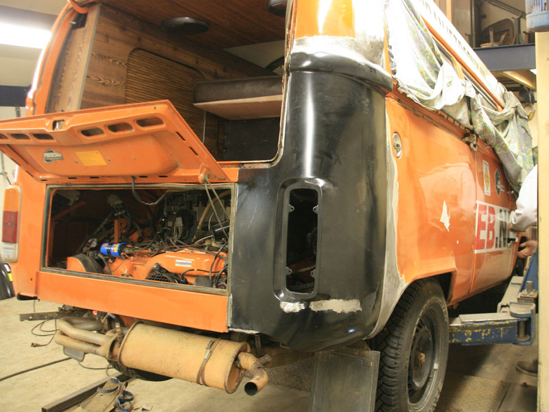

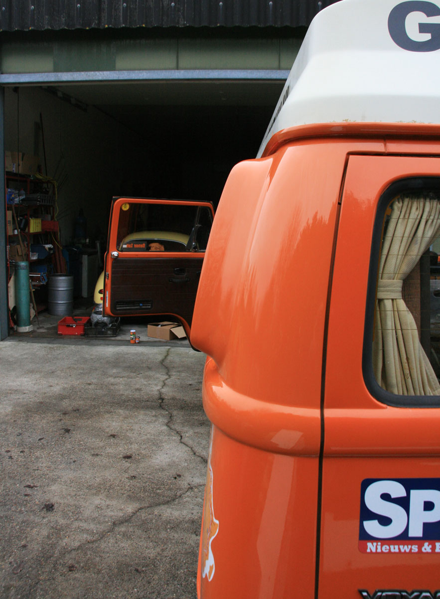

Once we got our bus back in Holland it went to the body shop to repair the damage that was done by a truck in Nairobi, Kenya. They also fixed up the bent chassis member (at the left front beam mount) and cleaned up some rust around the wind shield. While they were at it they also fabricated a little air scoop to aid airflow through the secondary oil cooler.
After the touché
Rear corner removed
The old panel clearly shows a PO hackjob repair.
New panel in place
Windscreen removed and rust removed, there hardly was any rust actually, but the windscreen had to come out anyway since it cracked due to some flying debris.
All done here!

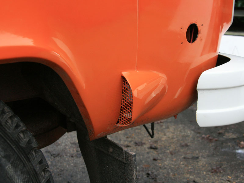

Oil cooler air scoop
Close up of the air scoop
There is one more body mod, I wonder if anyone can spot it Twisted Evil
busdaddy wrote:
Nice work on the upper cooling scoops too, very subtle.
We have a winner! Thanks
Should aid cooling, we'll see what happens
