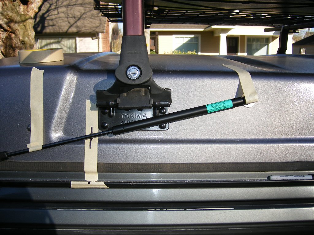

PostPosted: Fri Feb 04, 2011 10:21 am    Post subject: Reply with quote
I want to mount my rack as far back as possible, as per JackBombay's recommendation for easier lifting and also to one day make access with an awning easier.
While trying to use the rear bolt of the rearmost rack mount, to double as the attachment point for the Pop Top Shocks, it appears to mount the rack about 6" farther forward. Is this a big deal?
Also, the strut ball mounts in the kit are a little too short to double as the rack bolt so I would have to source slightly longer ones. I see many are pulling this off, so how?
Combined with the relative position of th rack and the shorter bolts, I'm tempted to drill the third hole and be done with it.
Feedback? Thanks.
Feedback? Thanks.
Be very careful when you do this. I mounted my rack first, then the pop top shocks years later. I bent a pair of shocks because my rack mount bolts interferred with the shock travel. If you don't have them figured out ahead of time, you could be in trouble. My rear mount was almost back as far is you could put it too. You can see in the photos below what happened with the bent mount for the shock. When the top closed, the shock would hit one of the mount bolts. My rack was mounted long before pop top shocks were available so I didn't consider this in the placement of the rack. That's why now you can combine function of one of the bolts if you place your rack properly. I had to take out a bolt for the mount and seal the hole. Plan ahead!
89 Westy 2.1 Auto
singler3360
Joined: February 25, 2009
Posts: 1191
Location: Corvallis, Oregon
singler3360 is offline
PostPosted: Fri Feb 04, 2011 11:11 am    Post subject: Reply with quote
Thanks for the caution and photos PDX. Are you saying that the ARG mounted to the rear of the strut mount is NOT a good idea then? I have drilled and mounted the poptop shocks but stopped short of drillling the second (or third) holes for the ARG until I can source longer strut mounts or get this relative positioning figured out.
