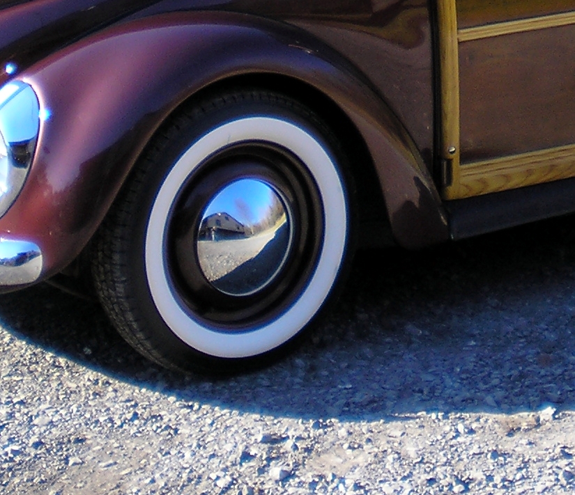

I searched and was amazed I couldnt find anything. I need to run pretty high offest wheels and stock seems to be the way to go. (already lookes at aftermarket options - to wide and/or too deep. The end result is to be a simple painted rim that looks like 5 bolt smoothies. No hub caps or trim rings.
Is there a REASONABLY easy way to do this? Obviouslye I can cut out 40 metal ovals and weld them in, grind, bondo etc. But wondering if I can do the "shortcut" like with just tiger hair and a backer? Any ideas? Thanks in advance.

If you do that, they will all fall out. The wheel flexes a lot as you drive. Have you ever seen a hubcap on the side of the road? Flexing wheels spit off hubcaps all the time.
Weld steel.

Thats what I was wondering - Didnt think about the wheel flexing at all.

Check here for pics of metal trims that cover the holes
http://www.thesamba.com/vw/forum/viewtopic.php?p=4873383&highlight=#4873383

THATS EXACTLY WHAT I WANT - Just PM'd you. I had seen Fonzy's idea, but was not nuts about plastic and was thinking about starting to look for metal bowls. Thanks!

Got these disks from Spinster -
I used seam sealer to glue them to the wheel and fill the seams around the edges. In retrospect, I really didnt need to do it. Depends on the color you pick, but the seams are pretty small. Real happy with them. There are aftermarket 4 lug smoothies, but I needed to kick my front wheels in as far as possible because of my dropped spindles. So I found a set of stock wheels with the correct offset.

i got a set of spinster's rings last year, and am almost done restoring some o.g. wheels to put em on......... anyway i also was curious about the disk brake question so i asked here:

DONE!!!!!!!!!!!
I am really pleased with the look. the class of smoothies but the practicality of keeping it 4 lug. big props to spinster
