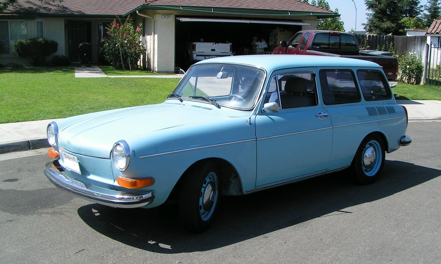

Got ya, that is the semi current picture
This is what it really looked like when I got it (cleaned and paint buffed).
I was originally given my 73 auto Squareback by a gentleman who was getting too old to work on his own cars. My 8 year old son and I were walking up to my T1 and he approached us and said “I have this old Squareback that has been sitting for years, and I would like to give it to someone who appreciates VWs. He gave me his # and address and told me to call him. I’m thinking, “Yeah right, what do you mean by give”. After a couple of days I called him up and asked if I could see it. So, I drove over and it looked in pretty bad shape. It had been sitting for years under a tree and the whole back section was stuffed with spare parts. However, it was sitting there idling. I told him that I would have to check with my wife. He said” here is the pink slip, go talk to her. I ran the VIN through DMV and it had fallen off the record (no back fees), so I drove it home the next day.
My original plan was to fix it up and sell it for money to trick out my Baja Bug. However, after I kept driving it and no one wanted to buy it for $ 2000 I decided to keep it, fix it up and give it a little more power. From my experience with the type 1 and heating issues, I decided to put a Type 4 engine instead. It took about a year and a half and when it was done I took it back to show him. At first he didn’t recognize me, then I retold the story and he came out to look at it. I thought that he was going to cry. It turns out it had been his wife’s car, and that’s why he was so emotional. He went back inside the house and got his video camera and kept going around the car for what seemed like 20 minutes of filming. All the while saying, that he wished that she could see it now. I am so glad that I didn’t sell it and I now know that the T3 is a far better car then the T1.

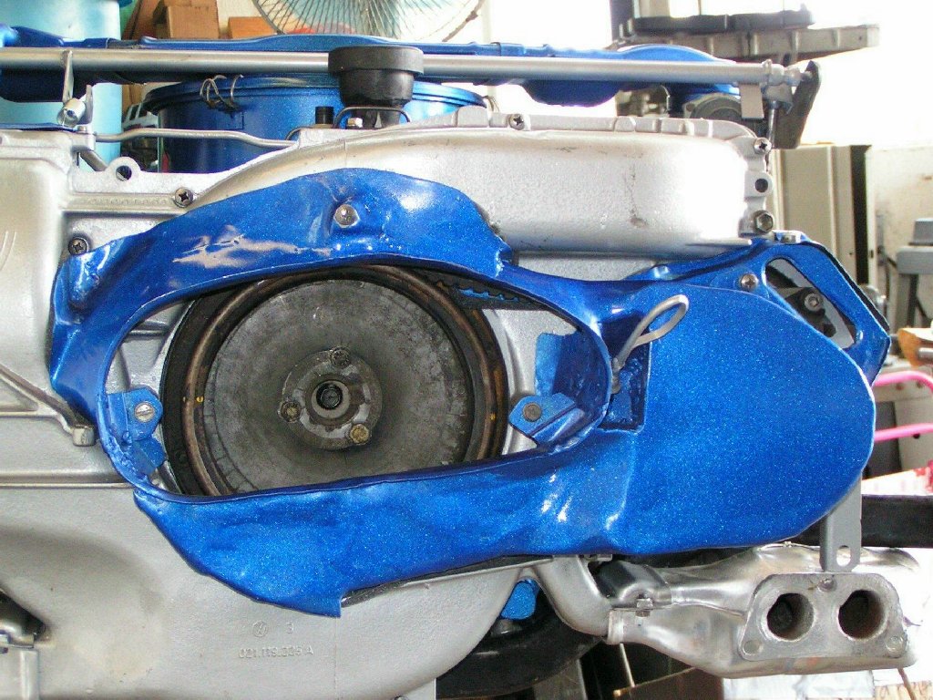

It seems that there is no “right” way to do a type 4 conversion into a type 3. Each one that I have noticed tended to do it their way. My conversion is no exception, it is a little different then the others that I have seen. Probably the most important part of the conversion deals with the cooling air flange. Since I didn’t have a T4 flange or boot, I stuck with all T3 components. The main difference between my flange and the others that I have seen is that it is a sealed unit similar to a type 3. This took quite a lot of work, probably more work them most people put in the whole conversion. However, I am now pulling all of my cooling air from the outside, just like the original T3 engine did.
You can’t tell from the photo, but every mating surface to the fan housing has a flat surface (some internal). I then used high heat foam to fill in any gaps. There are also six screws that hold it on around the perimeter, so it has a pretty good seal. The only warm air that it brings in is the air from the alternator. Here it is installed. It is a little bit harder to change the belt now, but I feel the tradeoff is well worth it.
The next difference in the conversions is the motor mounts. Many use the T3 hanger bar, but air conditioning is in the future and the T3 bar was in the way of the compressor belt and mounting brackets. I then used the stock bus mustache bar and rubber motor mounts. I then fabbed up some mounting brackets using square tubing and flat stock.
For the mid mount, I welded some heavy channel to the shock mount area on the car. I then made a cross bar that mounted to the transaxle and the used the stock rubber bus mounts to suspend the bar from the channel. This is the modified version.

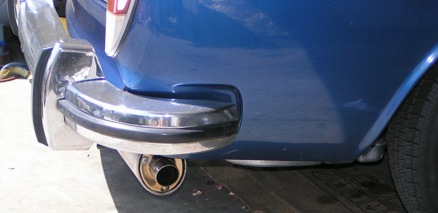

For the exhaust I used 72-74 bus heater boxes and a modified Thunderbird type header. I then cut the flange off of the header and welded on a flange to accept a Suzuki Hyabusa muffler. I also made a support hanger to take some of the muffler weight off of the mounting flange. Here are a couple of pictures of those.
My main goal was to build a conversion that looked like it belonged in the car. My engine did not have the fuel injection so I went with carburetion. In one of the header photos you can see the PSDITs. However, I could not get these carburetors to work right. The engine ran great cold, but as soon as it got hot it would barely run. I tried to adjust the carbs per the Bentley, and also from some directions off of the web, but they just wouldn’t work right hot. A friend had picked up some Brazilian Webers for nothing off of the bay so I tried them and they worked great with the only adjustment needed was a larger main jet.

wow, that was some serious shroud work. nice job!
may i ask? are those regular bus intake manifolds or are they shorter? i ask because i would like to put carbs on my 412's 1800 as the FI system is filled with very brittle wiring and i'm a carb guy, not a wiring guy...

I like it. Nice clean install. Did you have to cut down the bus intakes? Just asking, because I've got a set of carbs and manifolds for a t-4, and that would give me an option if I don't like how the FI works on my t-4 engine. I mean the FI works ok, but it is an older set up. Wink

To be truthful, I "think" that they are short bus manifolds, I still have these manifolds and they measure approximately 4-1/2” high. If anyone wants them cheap, send me a pm and we’ll work it out. One of the “Biggest Misconceptions” in doing the T4 swap is that you need some “Ultra Short Intake Manifolds” (it depends on the carbs you use). This is one truth that I learned from the T1 side.
A lot of people put bus transaxles in their Baja bugs. Currently, mine is a 5 rib, but the first one I put in was a 3 rib (too low geared). There are two ways to do this: the cheap and easy way (wrong IMNSHO) and the right way.
The easy way is to buy cheap solid motor mounts that lifts the transaxles higher in the frame horns. You then cut a hole in the tunnel and weld a shift box on top of the tunnel. The shift rod then is on top of the tunnel and you loose the e-brake.
The other way is to either buy very expensive motor mounts, (or like me) make your own. Then the nose of the transaxles is tilted down so the shift rod is still in the tunnel. When you do this the engine and transaxles are tilted about 15°. This is a very common practice and I have never heard of an engine or transaxles failure that was brought on by doing this.
So I used this method to setup my conversion, I set the engine height by the type of intake system I was going to use. I was a little concerned though, since I was going to be using an auto. So I talked with Ray G about this, and he felt that a couple of degrees would not hurt the auto either.
So I assembled an empty long block, put on the manifolds, carbs and air cleaner and made my motor mounts to give me the clearance I needed. However, I did pay attention to the force that was being placed on the front transaxles mount since they are NLA. The one problem I ran into was when I swapped over to the Brazilian Webers. They were a taller carb, but I found some shorty manifolds for the baby Webers. They bolted right up and were the same height as the stock carb and manifold setup.
Now in VWFYE’s and Bobnotch’s situations, you already have your motor mounts made. However, if you needed a little extra room to switch your intake systems, I would probably try and make some spacer / adapters to drop the engine a little bit instead of going to the expense of getting the ultra shorty manifolds.

Thanks for the info. I'll have to check the manifolds I have here to see how tall they are. I've got them, along with both carbs (Solex), and the linkage.
Mine's currently FI, but I'm really a carb guy, so this swap may happen some time down the road.

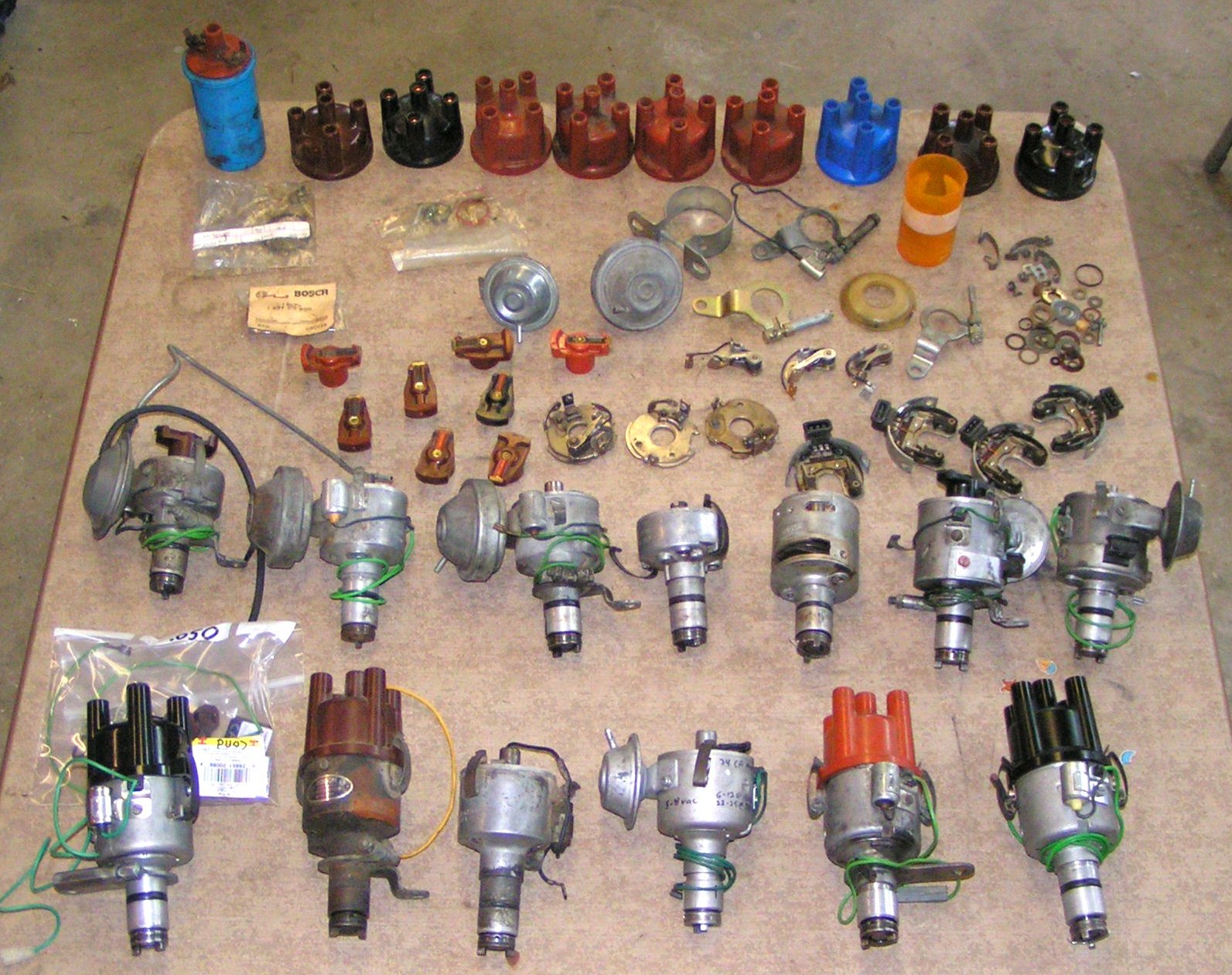

I am also a carb man myself. Since I was knee high to a grasshopper, I've been around all sort of high performance engines. From hopped up VWs & Porsches, to 2 & 4 stroke dirtbikes. If you wanted good performace, you had to know how to read the engine and jet it. Now distributers and advance curve is another story. I know the basics (well maybe a little more), but I have a lot to learn. This is one area that is kind of a dark art, and it is hard to get info on.
I have been trying to gather all the advance curve graphs that I can and it has been my latest obsession (when I have time). I have been making a few special tools for testing different compenents of the dizzys, but all they will give me is static information. I have all my feelers out for a distributer machine though.
For my setup, the 050 is far better then the 009, but it has some of its own issues. I like the feel of the curve, but I now feel that it has too much advance built into the distributer. So before it gets too hot and I can find some free time somewhere, I want to do a little playing with some different distributers and see if I can make something a little better for my setup.

I just scored an 055 bus distributor out of the 57 oval rag. It was the Only thing I "stole" out of the car Taylor! Scouts Honor! Exclamation

What are the characteristics of the 055? Is it a cast iron body or alum? Curve like a 010 or 019? Inquiring minds want to know.

It is aluminum w/big dual outlet vacuum advance.
