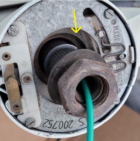

So, before I get a few sticks of TNT I thought I should see what all you guru's have to say.
68 Ghia:
I just finished wiring the horn system and pretty confident it's wired correctly. When I do a test by touching the green wire to the location in the yellow arrow is pointing, the horn sometimes works but mostly just sounds like there's a bad connection and all I hear is a click like a bad connection.
Could a bad horn relay cause this or the green wire not having a good connection on the steering column?
Any thoughts? or would it be better to wiring the horn system w/out a relay and if so how do I do that?
Thank you,
Lee

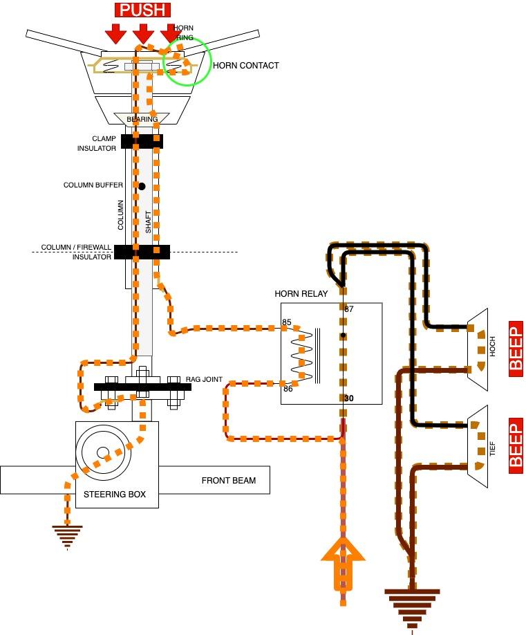

https://www.thesamba.com/vw/forum/viewtopic.php?t=566567

Nice picture to help those of us who are challenged like me !!! Smile Smile I have a few things to go check now, hopefully will make magic by the end of this weekend Smile

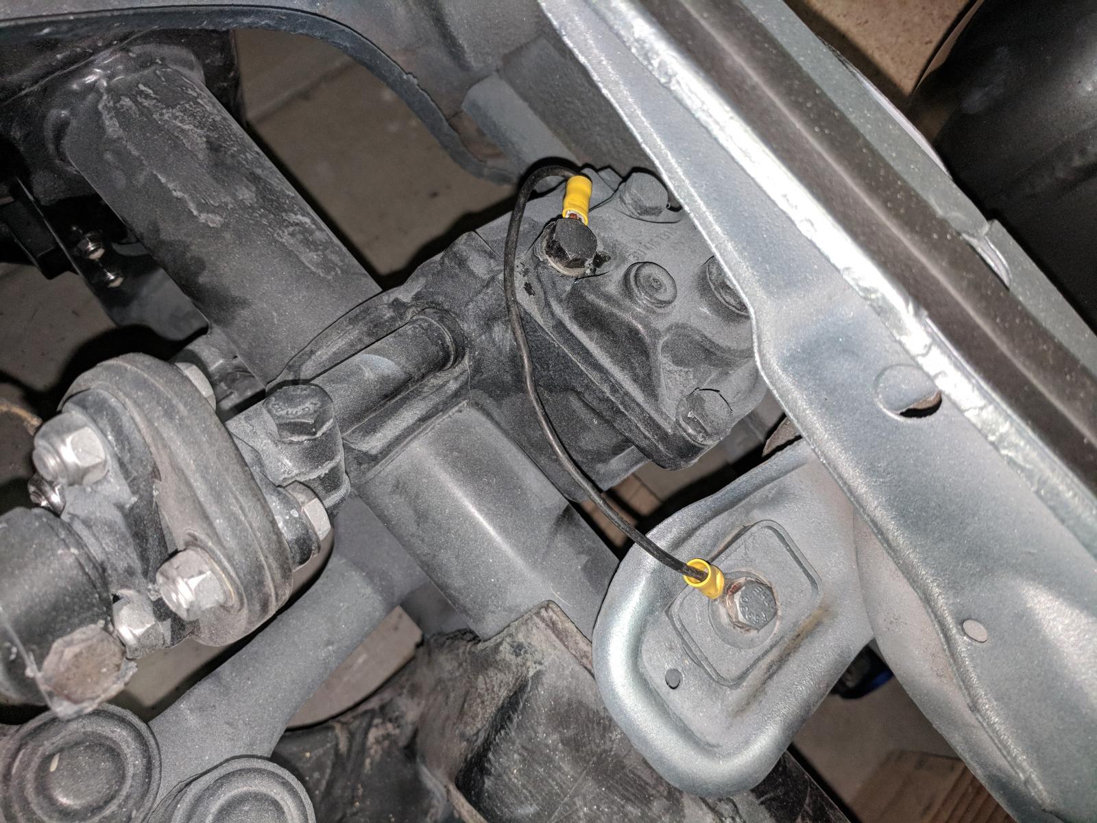

I also have a 68 I recently restored. Had issues with the horn as well. New powder coated beam, painted steering box, new wiring harness. The steering box had no contact to ground. I jumpered a wire from the steering box to ground. Here is a picture of the wire (don't mind the overspray, hadn't cleaned it up yet). Also had issues with an aftermarket horn button in a Grant steering wheel. After resolving the connection issues, my horns work great. Good luck.

On the 68 after wired correctly is the steering shaft hot?
If I touch the steering shaft with the center wire coming up from the shaft as seen in my picture above, should the horn honk?
Reason I ask is, when I touch the shaft with the center wire, nothing happens but when I touch the horn bearing under the turn lever with the center wire, the horn honks.
Fyi, the center shaft seems to move, thinking the horn bearing may need replacing so wondering if this could be the issue.
Thank you!

No! The shaft is not hot... It completes the ground. The relay is just waiting to be energized and power the horns.
Yes, touching the wire completes the circuit causing the horns to beep. Lemme look through all my pictures, I might have some of the steering column. I did have to replace my bushing, twice... The first ones solder failed and the wire fell off.

Right now I can touch the steering shaft with the wire and nothing happens. The shaft has lots of play making me think there's no connection from the horn bearing to the shaft?? Wonder if I need to replace wirh the following part or.parts
https://airheadparts.com/vw-part/steering-column-bearing-111-998-559/
https://airheadparts.com/vw-part/steering-shaft-contact-thrust-ring-111-953-535-d/

Just went through all my pictures... Nothing except the one I already shown above. My beam was powder coated, and I blasted and painted my steering box. There was no connection to ground through all the paint, hence the wire jumper. You won't be able to tell which bushing you'll need until you tear yours apart... Mine was an early 68, has the donut shaped one with the wire dangling. A pain in the ass to install for me. You will more than likely need a new bushing.
