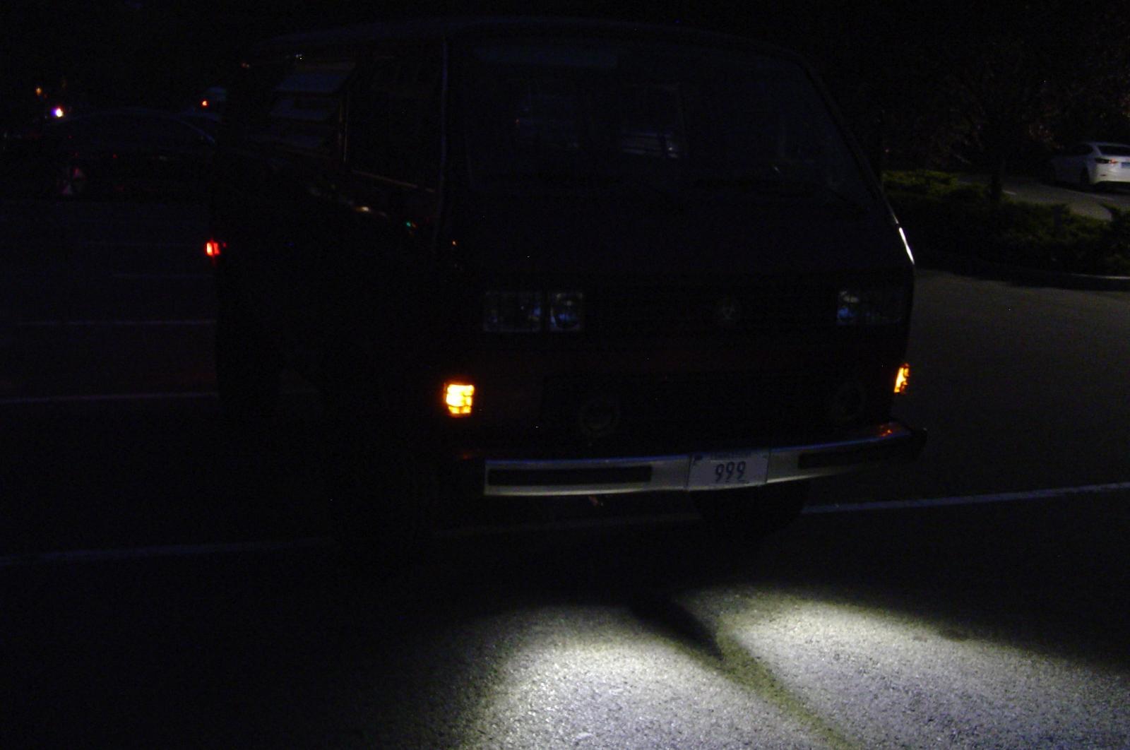

Finally installed my GW front skid plate. I came up with an idea to install a pair of flood LED's to mount on the skid plate. I bought a pair of Rigid Ignite flush mount flood beams. Link below:
http://www.rigidindustries.com/led-lighting?f[0]=field_product_family%3a5485
I originally planned to cut a pair of 1" holes on the skidplate & put the floods on either side, but I discovered that the the angle wasn't correct. I ended up making some brackets from a piece of u channel I had. I bolted them up to the most aft holes on the sides of the plate.
Here's the skid plate. It's a nice piece & heavy duty
http://www.gowesty.com/product-details.php?v=&id=4153
Here are some pics. I only got one side LED mounted. I'll finish it up tomorrow & get some nighttime pics...

PostPosted: Wed Jul 20, 2016 8:01 pm    Post subject: Re: Go Westy skid plate with flood LED's on Syncro Reply with quote
Yeah I hope. I've always wanted to get some lights mounted low for slow wheelin & hill climbing.
BTW, I think I should add a disclaimer on those "Ignite" lights. Just in case someone is thinking about using these lights as fog lights, they are way too intense (almost arc like). You will blind oncoming traffic for sure. They should only be used for off roading

I got the other side installed. For the small size, they really throw out a nice flood pattern.
Using these alone, you probably wont be able to go more than 15-20 mph. I plan on getting a Rigid Dually spot lamp to mount onto the driver mirror (I have LT mirrors)

PostPosted: Sat Jul 30, 2016 5:48 am    Post subject: Re: Go Westy skid plate with flood LED's on Syncro Reply with quote
Do you happen to have a picture taken from the drivers seat?
It's a good project.
btw. has anybody told you it looks like you ran over Kermit? Laughing

PostPosted: Sat Jul 30, 2016 8:20 am    Post subject: Re: Go Westy skid plate with flood LED's on Syncro Reply with quote
I tried, but the camera I have dosent like night photos without a flash. I'll try to adjust that setting & get a pic.
Kermit - All the green primer? It will be Waxoyl Hardbody Black soon. Cool
