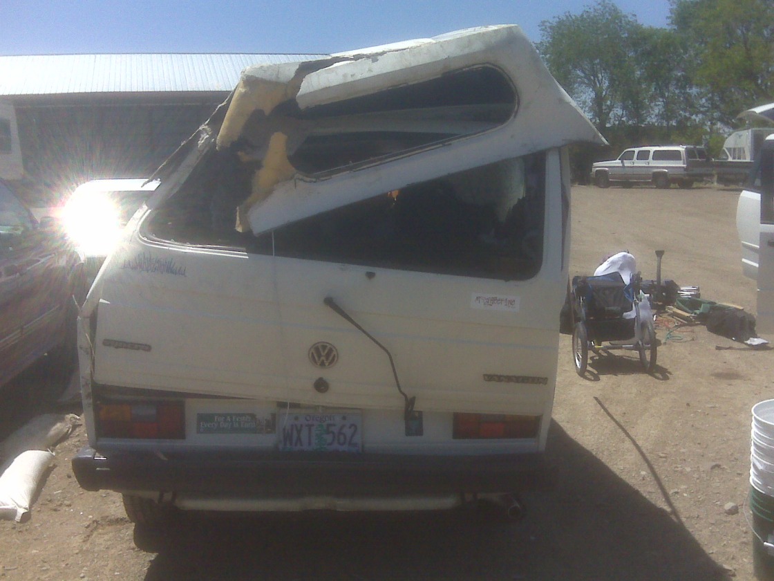

Please people, stay the f--- away from Wildcats. They are cr@p tires, even fully inflated. See my gallery if in doubt.
HOLD ME.....
my blowout at 80MPh=your rollover. I can't believe people buy this sh!t......and, I can't believe that they LEGALLY can still offer them. Thanks for having me back Wink

Here's the scenario that I don't want to happen:
I'm driving along at 60 or so.
I turn left with the road.
The front right tire folds just a little bit, because a lot of weight is shifted over laterally, so that part of the sidewall is now making contact with the road.
There's a little rock in the road, about the size of a nickel, sharp granite.
The point of the rock punctures the sidewall.
The right front then drops and the wheel rim digs in.
What happens next is not fun to think about.
