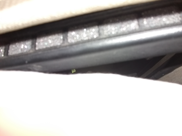

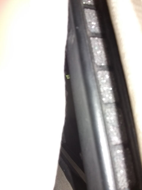

I put these in my 87. The foam, like everybody says, poofed into dust. I installed them without replacing the foam, and I haven't noticed any bugs getting in, or whistling. Then again it's so loud in my van I'm not sure I'd notice anyway, but I haven't heard any complaints from the kids.
They were VERY difficult to install. I have installed several windows in the past using the cord in the channel method and these fought me the whole way. Even ripped the rubber in a couple places. Maybe if you start with new rubber you will have an easier time of it.

I damaged a rubber seal also while installing them. This a a two person job for sure. I found having the cord cross over at the top of the window but pulling one side of the cord pass the plastic vent first make it easier. This is because the plastic vent will not allow you to pull with the cord parallel to the glass.

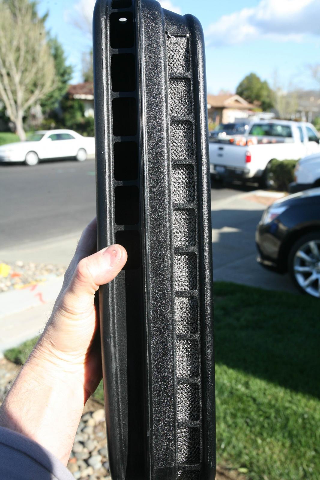

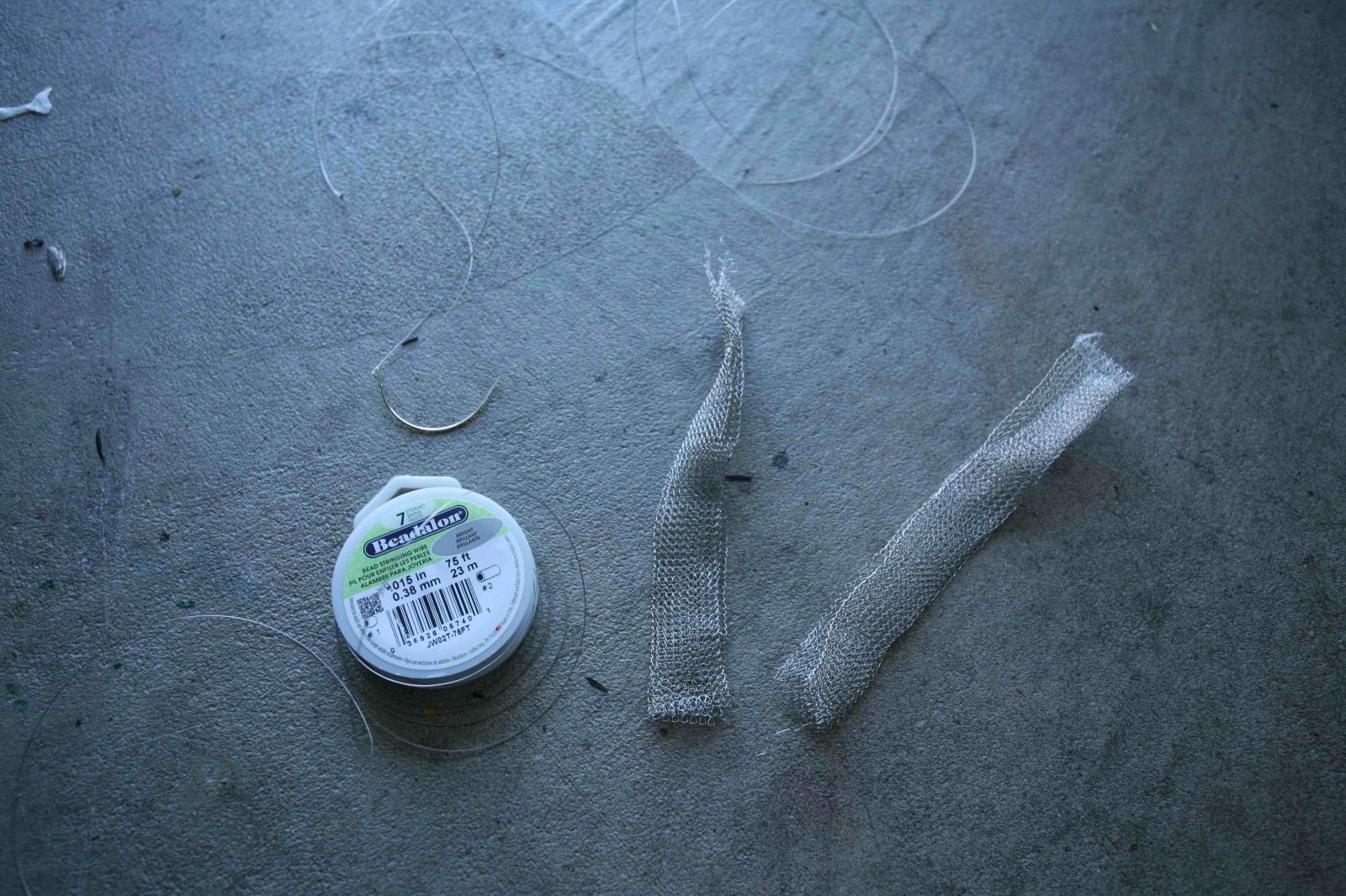

My solution to this disintegrating filter issue was to take some stainless steel mesh lint traps that are used for the water outlets of washing machines.
I used two of these lint traps per vent,( As there is one vent on the drivers side and one vent on the passenger side.) I laid one lint trap mesh flat, and folded it over itself lengthwise, in half. I then did this with another one and sewed the two folded mesh lint traps end to end so as to have a long strip that actually ends up being 4 layers of mesh in thickness.

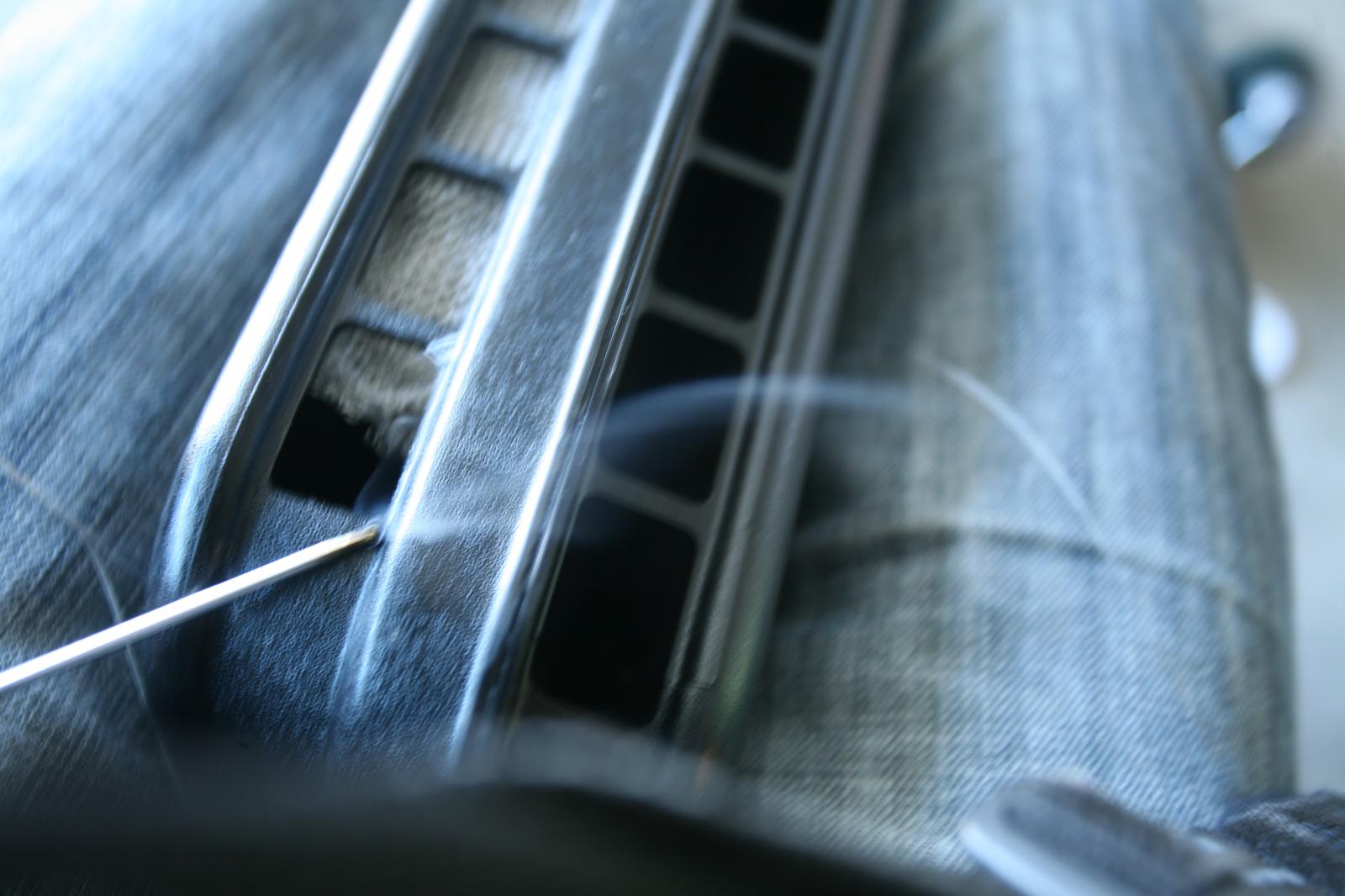

I then took a sharp picking device, similar to a dental tool, and heated it up with flame. I used this tool to make holes in the ends of the plastic vent so as to have points in which to sew/attach this lint trap mesh strip to each end of the plastic vent.
The strip of wire lint trap mesh is inter-weaved and pulled through the slotted space where the old, and now disintegrated, foam filter used to be.
I used what is referred to as an upholstery needle to sew/attach a plastic coated steel wire to the mesh and to the holes made in each end of the plastic vents. I ensured that the wire mesh lint trap strip was tight from end to end. It is kept in place, despite the fact that it is only being held to the plastic vent on each opposing end, because inside the vent there is a specific channel that the wire mesh slides inside of and rests within.
This is my preferred solution as these things are not easy to access, particularly in the cabinet side. The wire mesh is essentially rust free, and it will not disintegrate as a foam piece might tend to do so, thus eliminating the need to ever replace this filter again.
It should be noted that all of the below images can be enlarged 2x by clicking on them so as to show more detail.
After cleaning the vent, from grime and its original filter I ended up with this:
Here are the items I used:
Plastic coated metal wire, used for beading, and jewelry making, and found at Michaels craft store.
Upholstery needle
Stainless steel Wire mesh lint traps folded in half lengthwise.
[/img]
Here I am making the holes in the plastic vent:

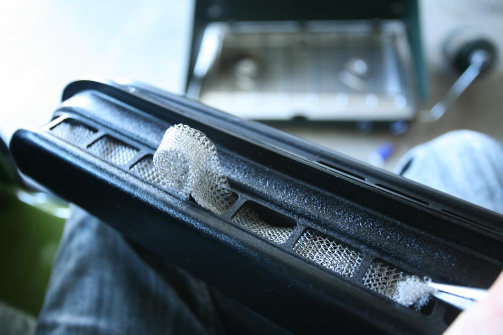

Here is an image of me Pulling the two folded over, sewed end to end, wire mesh lint traps through the foam channel after having sewn/attached the opposing end of this wire mesh strip to the plastic vent. once again, I sewed/attached this wire mesh strip using the plastic coated wire and the holes that I had made with the heated picking tool.
Here I am sewing the stainless steel wire mesh to the plastic vent using the curved upholstery needle and plastic coated steel thread.
Here is the Finished version:
1989 Westfalia Vanogan GL, 2.1
