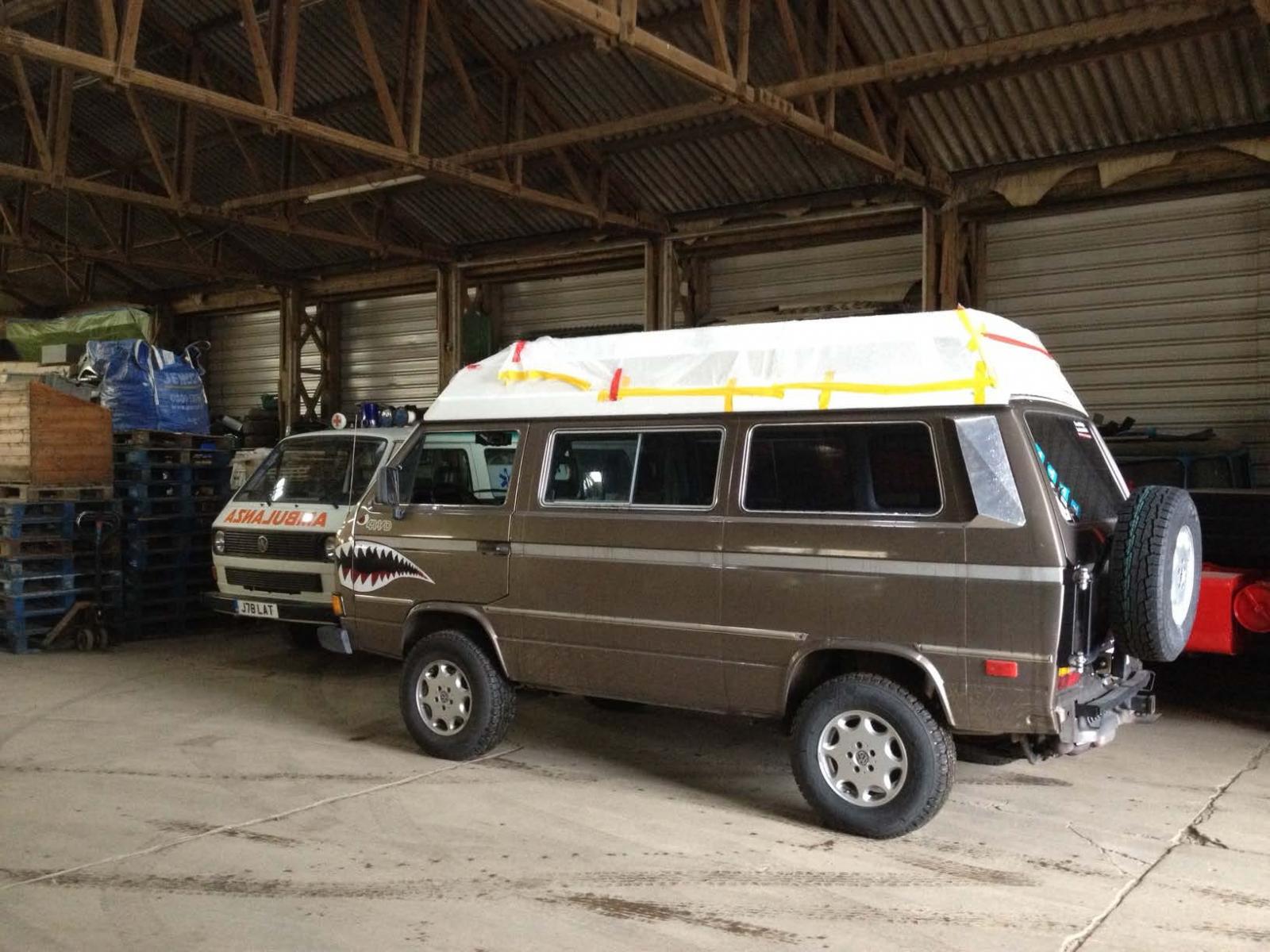

goskiracer wrote:
I visited Paul and Linda of vwcamperroof.com and picked up one of their freshly finished roofs in Norwich. Really great folks, wouldn't let me leave without a fesh coffee and biscuts Smile
Drove up to Simon at t3volution.com and started getting into fitting the roof. That syncro ambulance in the background has 47000 km on it!
Here is the top underside.
detail of the back corner.
The top...wow, the build quality is really a generation ahead of anything else out there. The roof stringers really add some serious strength and stiffness.
The pièce de résistance is the moulded flange that mates to the roof, matching the seams and creases perfectly. Folks with bonded joint experince understand why this approach is the correct way to bond a roof on...
Swabbing the deck
Decorating the cake. Here you can see the massive joint area. No messing about in the gutter.
The roof adds 13"/33cm interior height at the arch peak. Perfect for my needs.
##### The interior standing height is 180 cm #####
Wind noise/ handling? Nope/ "Full sock" crosswinds from Gothenberg, drove like my tintop normally did.
Gas mileage? Dunno, can't keep my foot out of the 10c engine.
Weight. I can lift it myself.
Cost £1250, worth the quality and fit alone. Paul doesn't work the delivery, chat with Simon at t3volution.com
86' Syncro 2.2 Vanistan, WBXhaust, ski-pole shifter for +11hp

PostPosted: Thu Aug 06, 2015 3:08 am    Post subject: Reply with quote
A few more photos of the intallation of the vwcamperroof.com top. The top was pulled from the mold just 3 days prior. Still has that new glass fiber smell Cool
https://www.facebook.com/simon.whitmore.75/media_s...amp;type=3

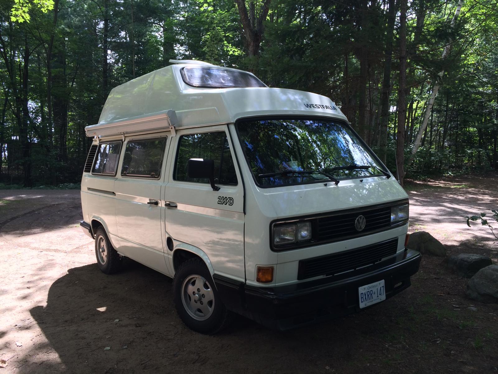

PostPosted: Wed Nov 18, 2015 8:35 pm    Post subject: Re: Official High-roof Thread Reply with quote
Here is my 1989 Vanagon Westfalia California Hightop.
5 speed, 1.6 Turbo Diesel. imported to Canada from Germany by the previous owner approx 15 years ago.
