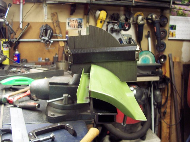

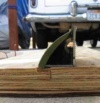

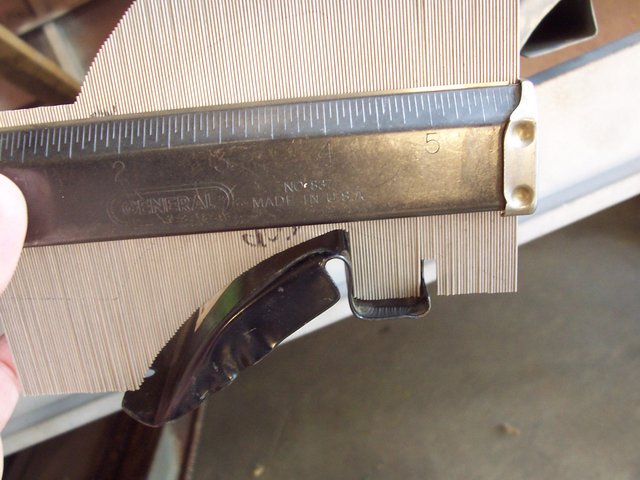

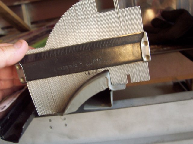

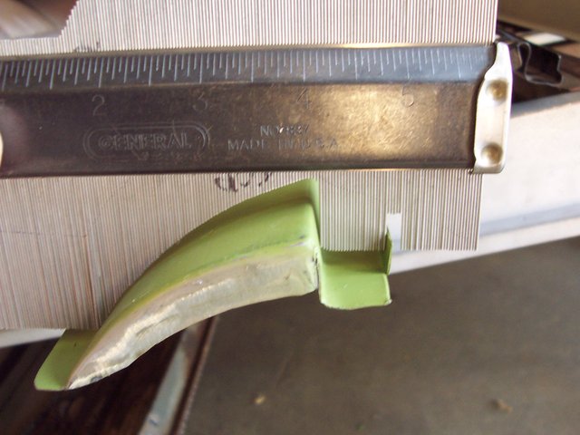

a comparison of bus rockers. i pulled the pics and comments from a different VW forum
one original and 3 aftermatket. most of you can guess which one is which by the colors
OG cargo rocker profile
The Schofield was of correct gauge but all dimensions were off by 1/8" plus the bend radius's just sucked ass
WW was 1/8" short to the gasket surface plus .009" too thin a gauge metal...sucks balls cuz it was a great looking part.
KF was crappy too but was limited to the top bend just not being broken over quite enough. Other cosmetic flaws were hammered out.
After 3.5 hours tonight I got an acceptable cargo rocker ready to start fitting
I made a jig for bending mine.
Funny that the one with the most correct end side profile is the crappiest after it is installed. There is a big sucking in bow in the profile right in the middle of the cargo doors on every WWW cargo rocker i have ever seen installed. Confused
