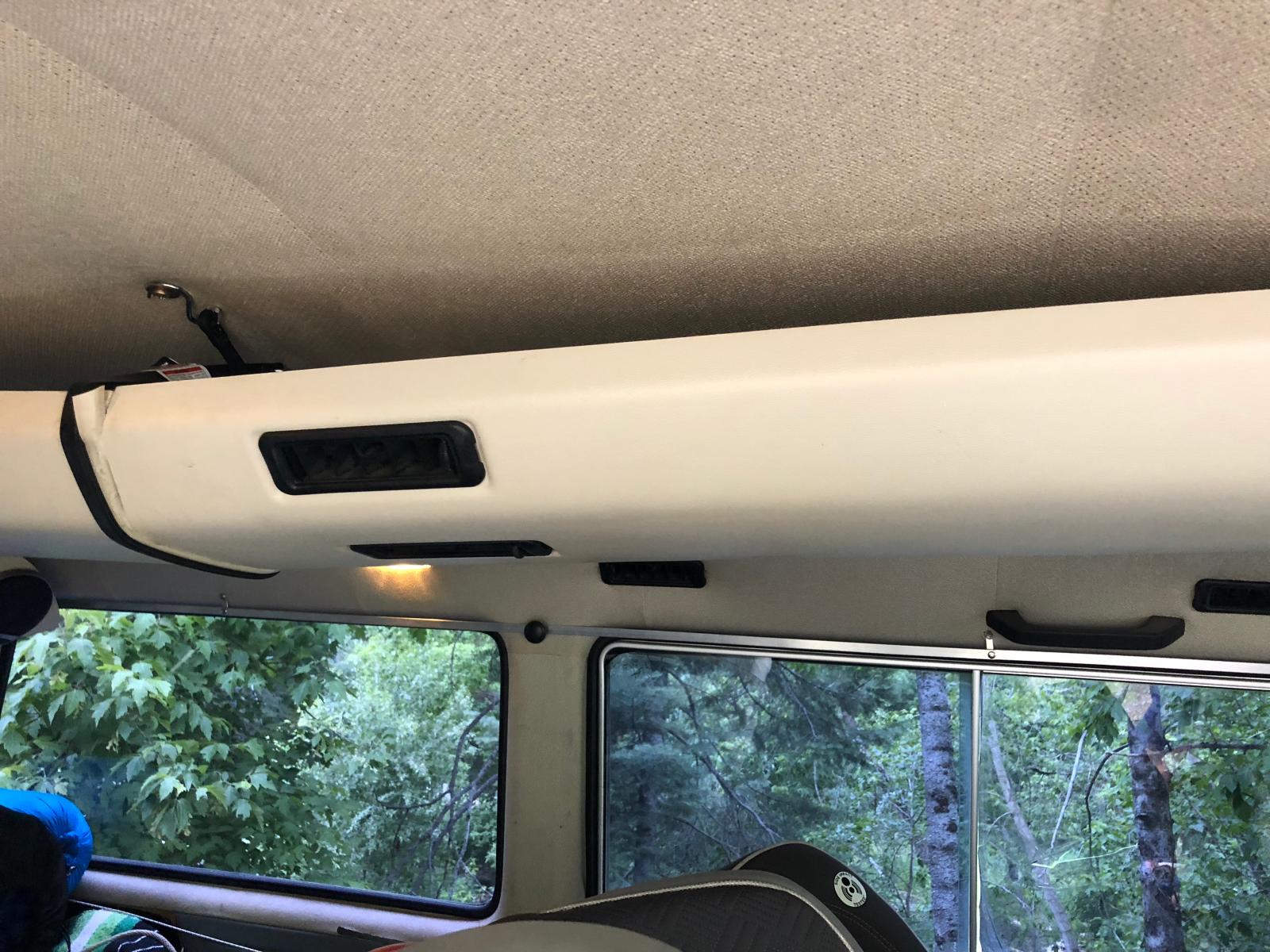

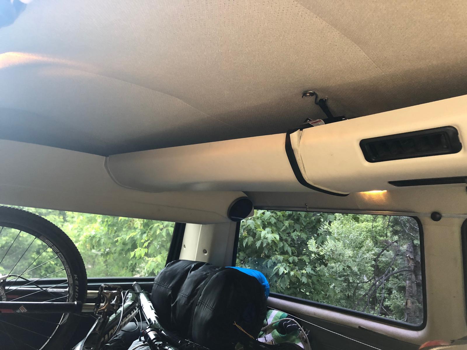

Hi there, we are new to the vanagon family! We just purchased ours and we are excited for the adventure (fixes and all). Wondering if anyone could point me in the right direction in regards to two AC fixes I need some guidance on:
1. The person we bought the van from said that the AC worked great last summer but since using it this summer it only blows air (and no I'm not talking about the fresh air system). What system checks can I perform to identify the culprit/cause? Remember I'm new but I'm willing to learn. In other words, don't jump right in with all the terminology but use the terminology and explain Smile

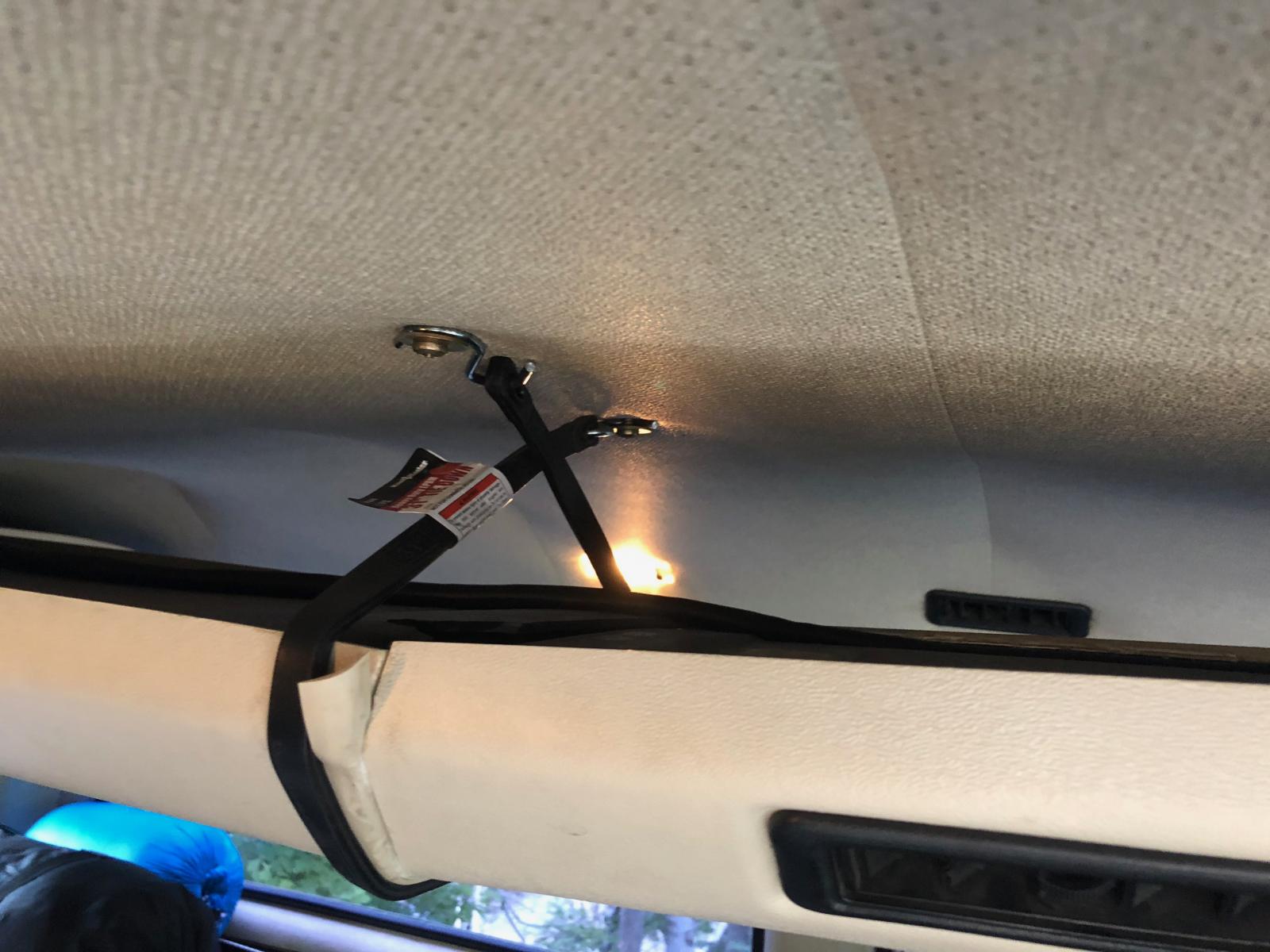

2. The AC column is sagging quite a bit and is held up by a bungee cord. Two owners ago put it up like this. What can I do or buy to secure it tight to the ceiling so it doesn't bounce? Could this be the cause of the poor AC?

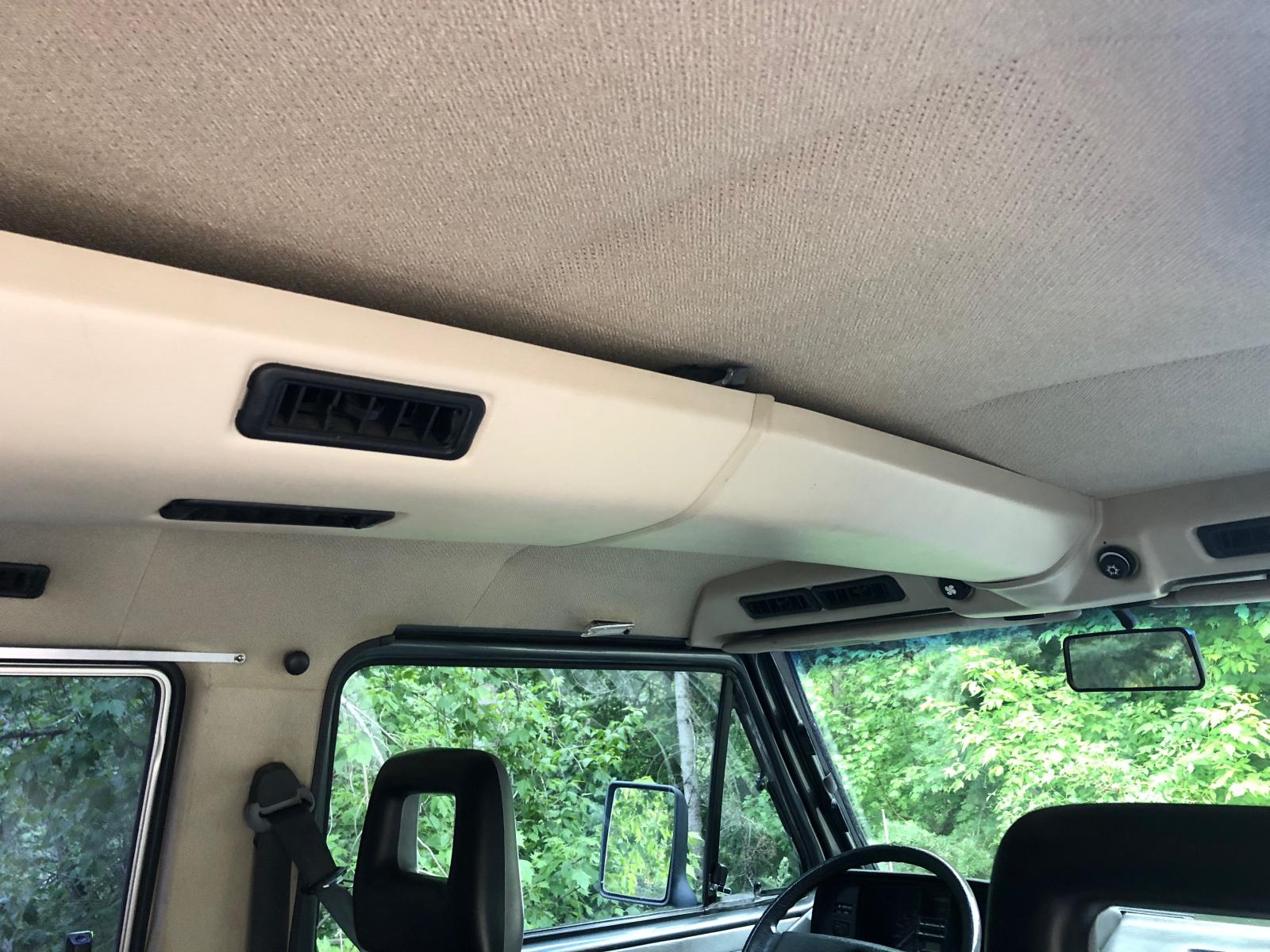

Do you know if your van originally came with that AC? Based on the control knows being in the overhead unit, I think somebody might have added it later on. Is the wiring routed through the circulation tunnel? None of that is stock.
The original tunnel anchors are made out of a special material known as breaksdownovertimeium. VW used this material for many locations as plastic anchor points; other examples include the tabs on the instrument cluster cover, AT cover, and headlight adjusters.
Anyway, looks like your tunnel is missing the anchors altogether, which again is why I think it may be a later add-on.
All this makes possible solutions quite challenging. If it was just the tunnel falling down, I'd advise you to remove it and use the rear unit like a room AC. That's what I did with my poptop conversion and it works great still. If the wires are going through your tunnel, though, that's not going to work, you'd have to relocate all the wiring and move the controls to the dash.
You're just going to have figure out how this was rigged in and if its worth fixing.

The first couple years of the rear/center tube A/C have the controls high at the front. This was later moved to the dash. There is an old RECALL for the center tubes to add additional mounting support plates and it looks like this van never got them installed, as many didn't. They eventually sag and fall without the recall supports and some do even with the recall stuff.

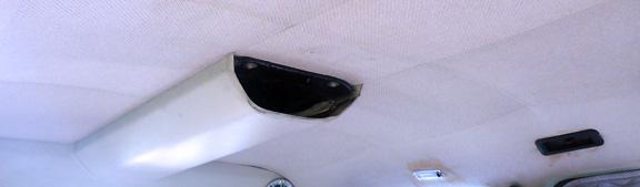

If you have a friend that can show you how do do epoxy repairs, time to call in a favour. Too bad the PO didn’t address the issue earlier. Makes me wonder about the general status of the PO’s Vans maintenance. Bungee cord just screams “ lazy corner cutter”
Once you get the ducting repaired and the A/C system refreshed and recharged the good news is that this is one of the nicest cooling systems that I have ever experienced.

If you remove the a/c ducting I think you will find that the plastic has fallen apart and even that plate will not help. You will need to use fiberglass and epoxy on the inside of the duct to repair it so it can be mounted again. Not hard to do if you have worked with glass and epoxy and not too hard to learn.

Had to do the same repair last year. You'll have to take the front unit loose and let hang with bungees or drop it completely, and the center sections will then drop down easily. The front section has to be loose to get the repaired center sections back up. I'd leave the rear unit in place because it doesn't repair easily and it is a bear to get back up since it is the heaviest & most awkward part to get back in place. Now if the blowers fans weren't working, the rear would have to come down. To repair the ducts, I used 3M hard plastic repair and was able to salvage most of the broken plastic pieces and glue it all back together and then used the recall brackets to reinforce the joints. If the pieces are lost, then fiberglass will probably be your best option. Reassemble from the rear forward. You'll have to have some help to get the frt center and frt sections mated and back in place so you can get the fasteners back in. I didn't have help so I used a telescoping hood prop from my old body repair days. This ain't the easiest task to start off with but you don't want it falling on passengers heads.
As for getting the system working, knowledge of how AC systems work, causes of failure and some common sense safety precautions are needed. An Auto AC book or course at the local Community College would be helpful. Also, look for the Redtek threads on the forum as there is a lot of good information there and that is probably the best recharge option available at this time.

Tackle the overhead duct repair first. The bungee straps are best-described as “redneck engineering” and will lead to irreversible damage. As others have said, duct repair can be challenging. With its generous windows, cooling the entire van to “ice cold” temps is not an achievable goal. But we find this system delivers cold air to our front cabin very efficiently.
