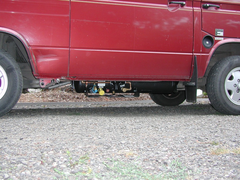

Here's a thread regarding this LARGE Bus Depot propane tank.
http://www.thesamba.com/vw/forum/viewtopic.php?t=438047
I'm hoping to get my tank mounted next week as my co-pilot wants the Propex operational for camping the following weekend. Uhhg. That means I'm doing an aux battery system too. Busy, busy....

Pictures please.

PostPosted: Sat Sep 17, 2011 10:46 am    Post subject: Reply with quote
Got 'er done
My ground clearance to the skid plate is now 7" (2WD 87' Westy Weekender)
I also got my Propex running. Toasty!

PostPosted: Sat Sep 17, 2011 11:20 am    Post subject: Reply with quote
turbotransporter wrote:
...My ground clearance to the skid plate is now 7" (2WD 87' Westy Weekender)...
...vs. 10.25" on my 84 Westy with the stock tank. Really depends on your driving & camping priorities.

PostPosted: Sat Sep 17, 2011 12:00 pm    Post subject: Reply with quote
Agreed. I understand why some folks have ground clearance concerns BUT I really don't go off-roading with my 2WD Westy.
My co-pilot/camping partner does marathons, trail runs and bicycling events (in the Pacific North Wet) so HER "support van" needs to be warm and dry... (or I'll be miserable Laughing ) We also plan to ski/camp at Smoqualmie Pass and Whistler this winter and we're looking forward to returning to a warmish van at the end of the day.
