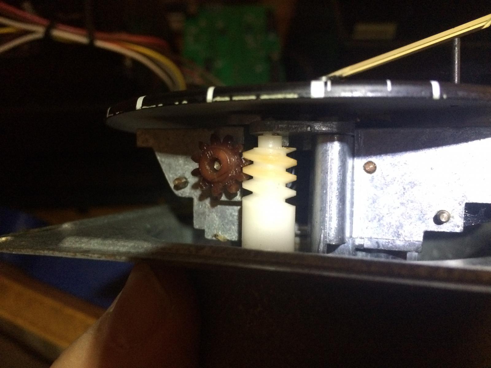

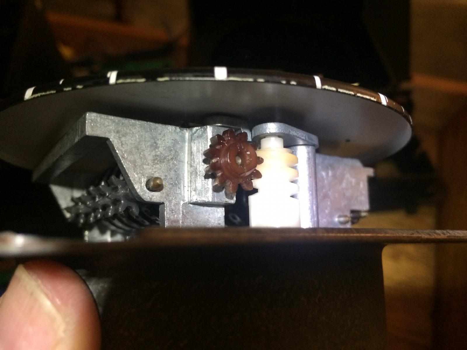

This thread inspired me to pull out a spare speedometer I had. I removed the tripmeter section. On the end near the 1/10ths is a black gear on the outside which is spun by the odometer portion of the gauge. I can spin that easily by hand and there is not any change to the resistance at any point during the depression or release of the button. The button unmeshes the gears prior to resetting the numbers. If you spin the black gear quickly while pushing the button very, very slowly, you can feel when the gears start skipping at a slightly meshed position, but there isn't any added resistance during that time. I am convinced that there is not any relationship between the odometer failing and pressing the button while moving.

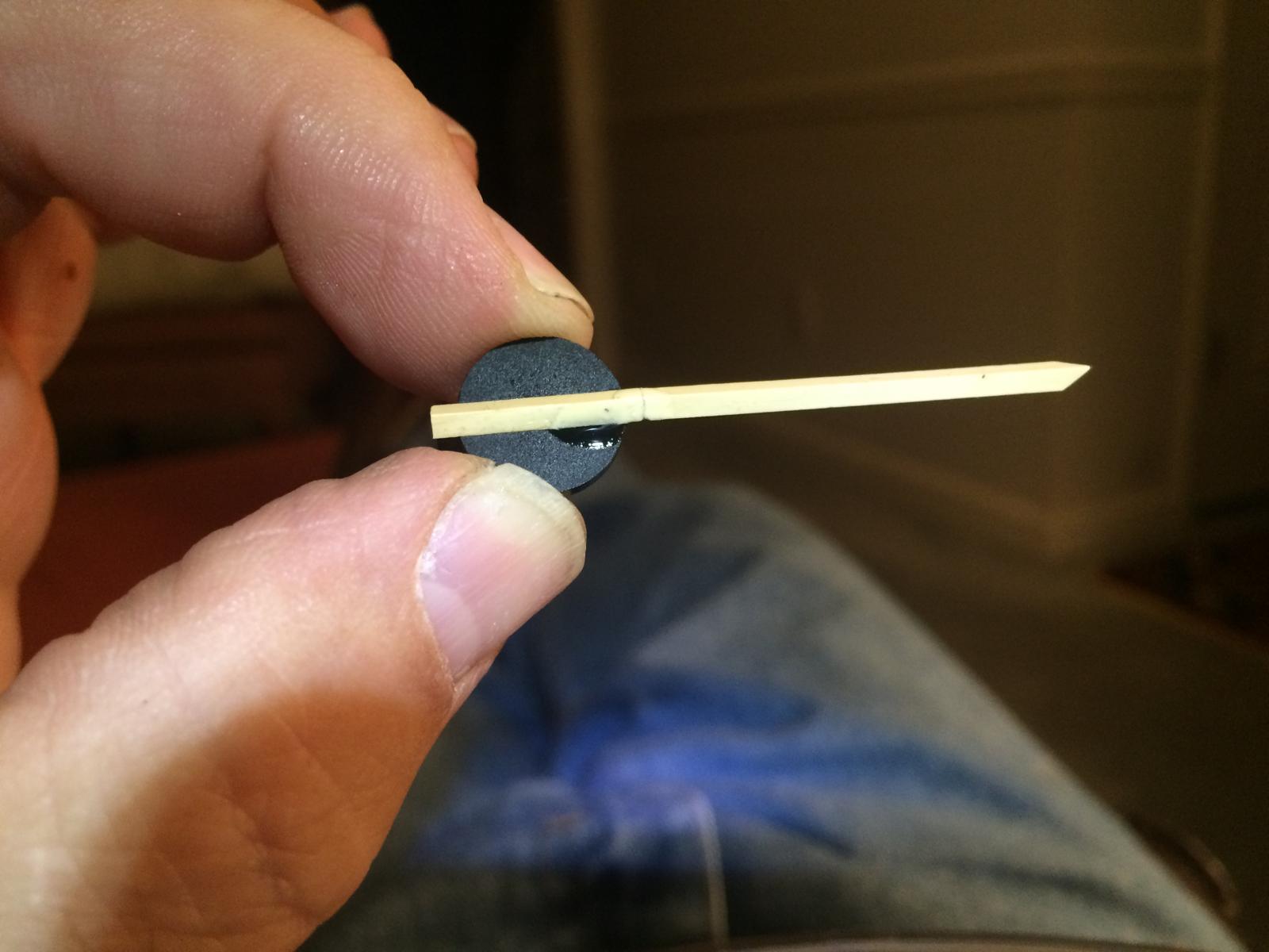

my odometer started slowly down then stopped working about a month ago.thanks to this thread I took it apart and seen those gears were just jammed together and I fixed them(I did push it while moving).when I took it apart on the back of the speedo plate was 159,235 dec. 2001(now 238,943),so was fixed before.just thought it was interesting.thanks for the info from everybody

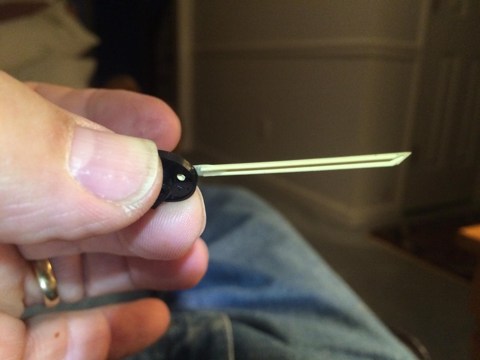

Thanks for the great photos and advice...but, I broke the needle anyway.
Superglue, deftly applied seems to be holding. I knurled the shaft with small wire snips and the little brown gear will be as hard to work itself off as the speedo needle was to get back on...without breaking again.
