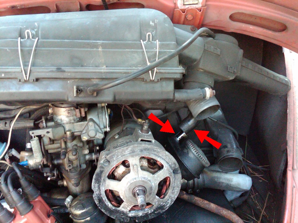

I removed the old one and need to plug some holes. What was the hole for? There is a hole on the new one. What is it for? Thanks.

PostPosted: Sat Sep 10, 2011 7:58 am    Post subject: Reply with quote
before the purists jump on and tell you to put the OE one back on, I'll give you the answer. That is for the vent next to the oil fill to hook to, same as should have been on the oe one. like below

PostPosted: Sat Sep 10, 2011 8:03 am    Post subject: Reply with quote
yea, that's where the old one went to, but what does it do? The hole on the new one is a lot smaller. Should I fit a hose to the same place as the old one? Thanks.

PostPosted: Sat Sep 10, 2011 8:05 am    Post subject: Reply with quote
yup, I just fit a hose, don't remember the size

CarlIseminger
Joined: May 12, 2008
Posts: 842
Location: Grand Forks, ND
CarlIseminger is offline
PostPosted: Mon Sep 12, 2011 12:09 pm    Post subject: Reply with quote
OK, the original PO asked what the hose was for. Not if he should or shouldn't run the chrome airfilter.
That hose sucked crankcase fumes and sent them to be burned. VW's first smog control device.

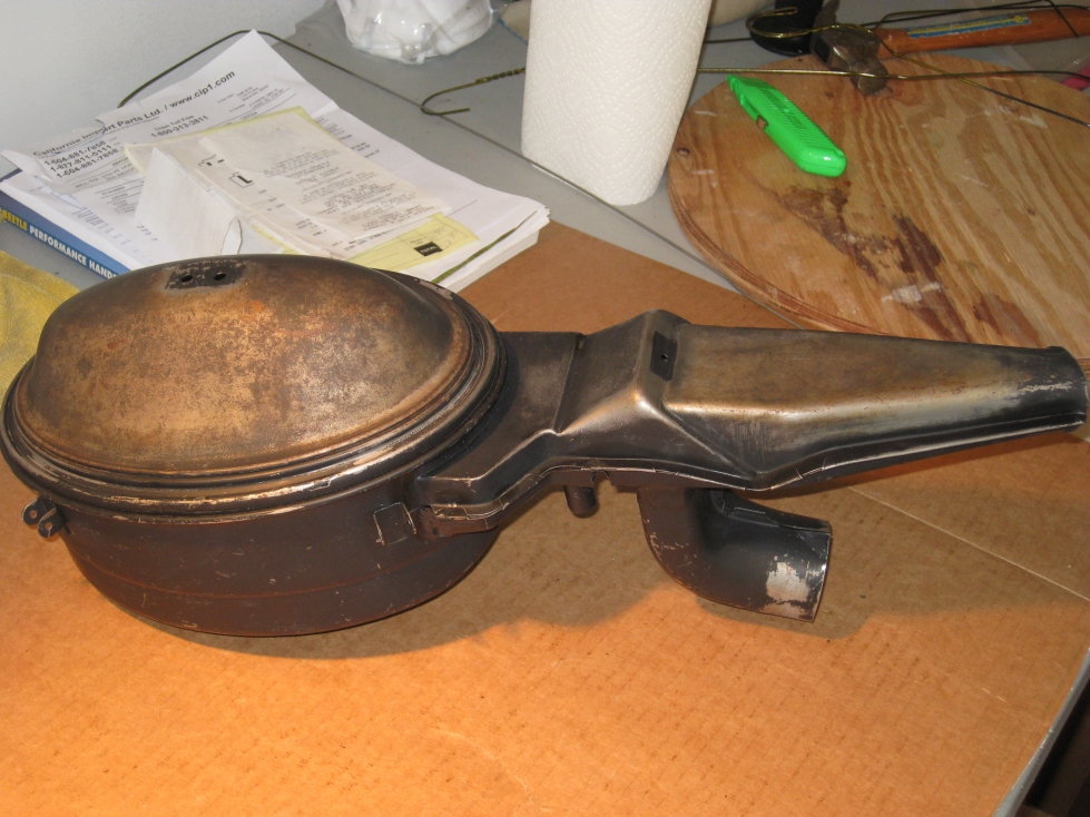

Shewster
Joined: February 26, 2011
Posts: 200
Location: Modesto, CA
Shewster is offline
PostPosted: Mon Sep 12, 2011 1:15 pm    Post subject: Reply with quote
Now that the question has been answered, I will pile on the original oil bath train. In addition to the functionality, I find a certain elegance in the design. They are just sexy to me Embarassed . I just bought an oil bath (here) for under $25 and restored it.
From...
To...
'72 Bug, One-family car, 350k happy miles (ok, a few of those miles were not so happy)
thomas.
Joined: July 31, 2010
Posts: 1366
Location: South West (Pa.)
thomas. is offline
PostPosted: Mon Sep 12, 2011 2:33 pm    Post subject: Reply with quote
That came out real nice .A beaut.

PostPosted: Mon Sep 12, 2011 4:52 pm    Post subject: Reply with quote
He got hes ancer,,, now its open season!! Laughing
From...
To...
Wow!! nice work Cool I'm with you, the oil bath just looks like it belongs on the VW motor, It's part of the 'ART' the one thing I hate about having Kadrons(no oil bath)
