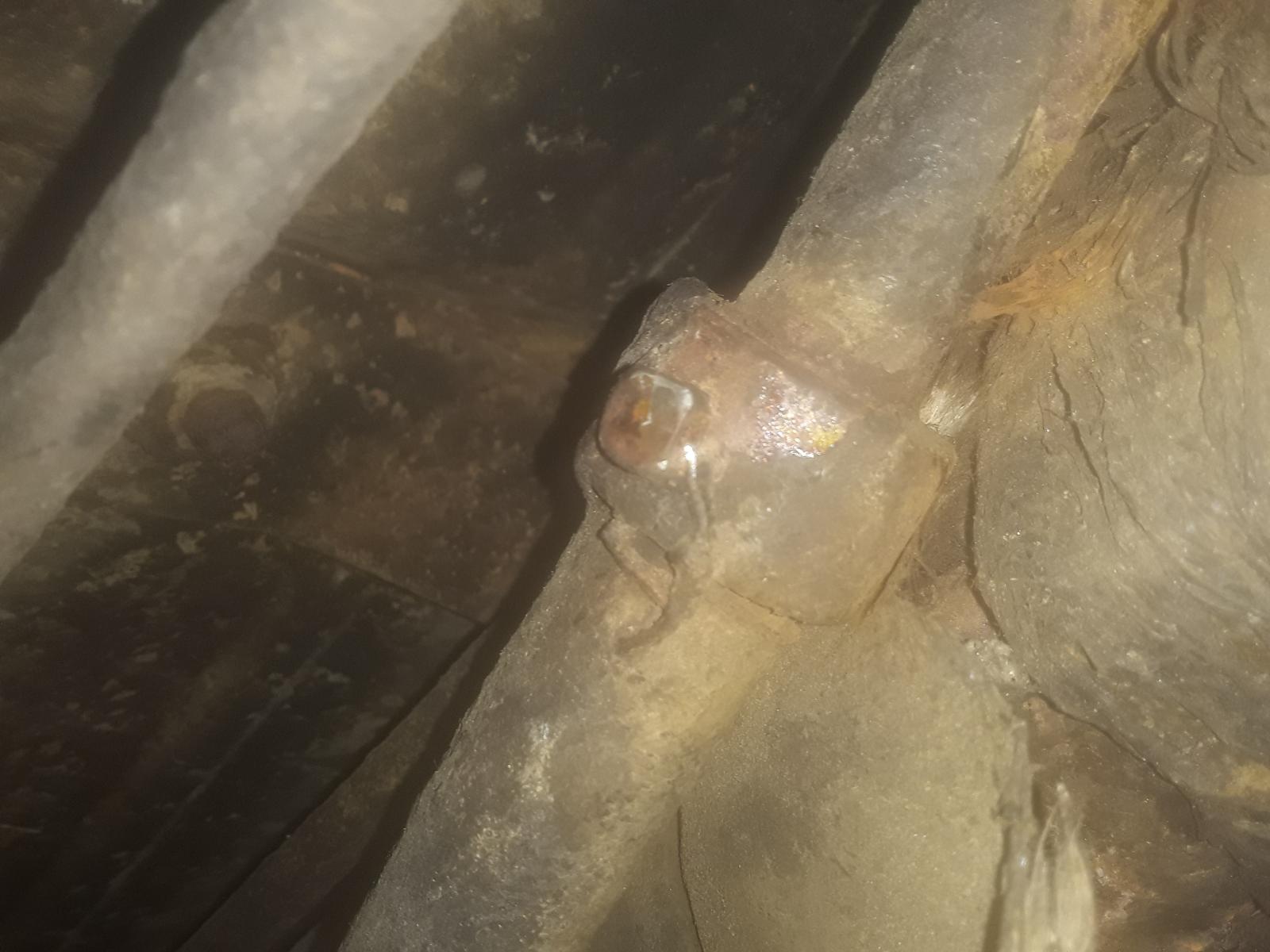

PostPosted: Mon May 03, 2021 8:04 am    Post subject: Re: Rear Shifter Coupler Reply with quote
One more question for you guys, as I just got the new coupling I was asking about and trying to get the old one off I put it in 3rd gear first then disconnected the bolts then shifted it back to 2nd, thinking this would give me the space to get it out, but there's still not enough room. Am I doing something wrong? Or on a 67 do I need to disconnect the front coupling? Which I hope I don't have to do as it looks kind of rusty Shocked And on a side note last time I did this I seem to remember getting it off without removing the front coupling.

Split 66' is offline
PostPosted: Mon May 03, 2021 5:27 pm    Post subject: Re: Rear Shifter Coupler Reply with quote
There should be another square headed bolt, further up the shift rod, behind the driver seat. Removing that bolt allows you to collapse the inner rod inside the tube, this will give you enough space between to put the coupler in.

PostPosted: Mon May 03, 2021 5:34 pm    Post subject: Re: Rear Shifter Coupler Reply with quote
Do you mean this 8mm nut split 66? Thanks

PostPosted: Mon May 03, 2021 10:21 pm    Post subject: Re: Rear Shifter Coupler Reply with quote
There should be one more bolt, other than the one in your pic, that if removed, will make the shift rod shorter by collapsing the shift rod, inside the tube. I wish I had a picture of it.
I remember it so well, because I've taken out that bolt and all the rods, and not realized what I had done, when I put everything back together, the shift rod was too short! Which meant the rod was retracted inside the shift tube, and I had to pull it back out to length, and put the bolt back in.
It's the middle section shift rod that should collapse (tube inside of tube) when the bolt is pulled. It's definitely one of those square 8mm bolts. Move the shifter too, that bolt may be hiding on the other side of the shift rod that you can't see.
EDIT: I can't remember if that bolt is under the cab floor, or under the mid section, sorry, it's been 6 years or so. That bolt looks out of place when you spot it, in the middle of nowhere on the shift rod tube as I remember, but towards the front of the Bus.

PostPosted: Wed May 05, 2021 10:47 am    Post subject: Re: Rear Shifter Coupler Reply with quote
Thanks Split 66 I got the front connection apart which wasn't easy as it was pretty crusty but I got the rear coupling off and it's ready to put back together just as soon as I get a new screw for iit that somehow stripped coming out.
