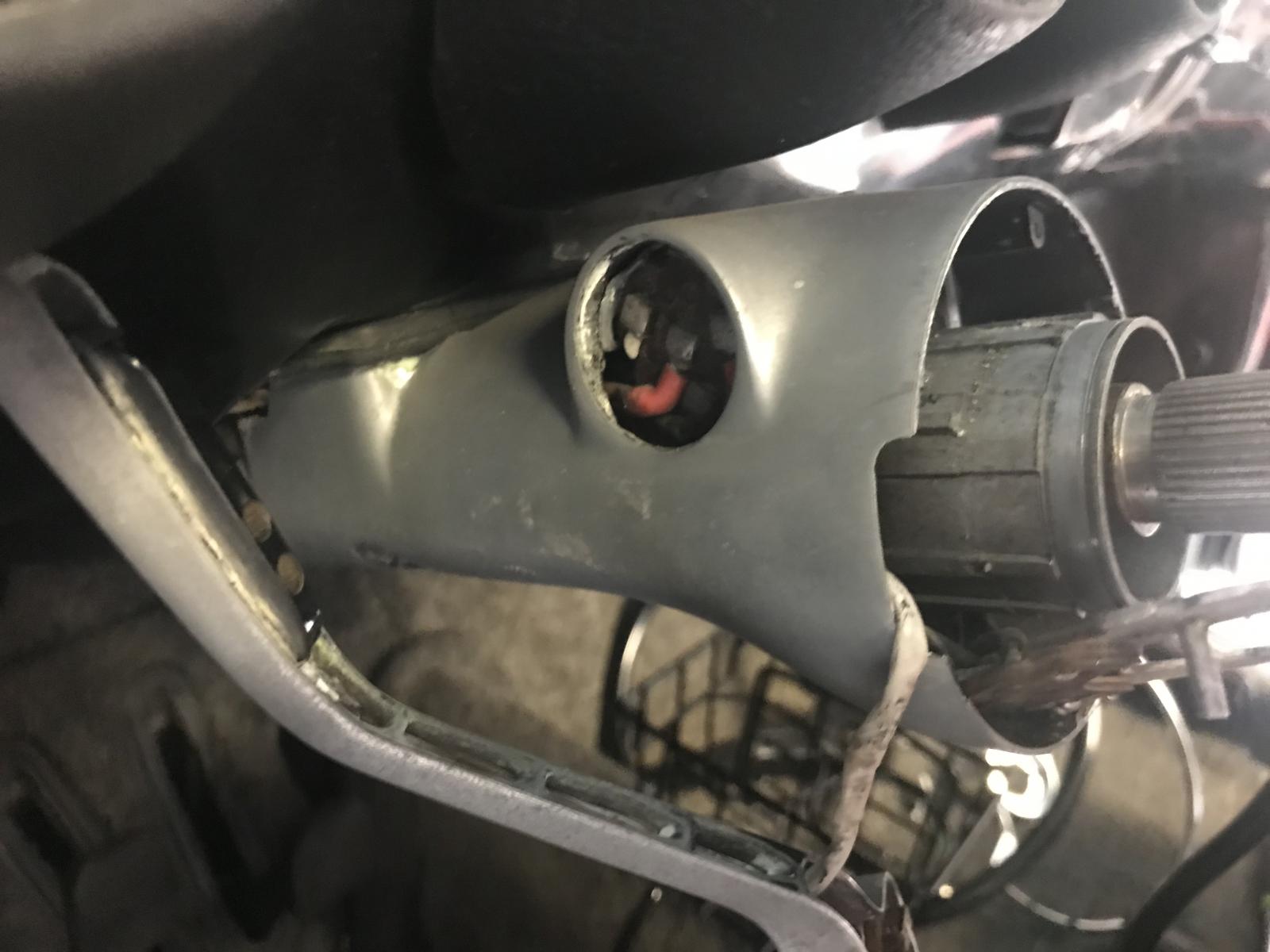

I’ve gotten as far as pulling the mechanical key switch out but the electrical switch does want to slide out. Maybe only moves a 1/2 inch. Do I need to unsolder the thee wires first?

Yes you do.

I have never unsoldered them.
I drop the column, disconnect the wires and put the wires up through the column as I slide the ignition out the right side.

I normally remove the entire column before removing the switch. It's easier to install/remove parts and see what I'm doing.

Still can’t seem the get the switch to slide out, only goes about a 1/2 inch and stops. Feels like it’s hitting metal??

Well, I put the mechanical key switch back in and turned it a bit and it’s sliding more finally.

Maybe the lock tab was sticking out?
You can see it at the top here sticking out:
I usually remove the ignition with the key in it as something to grab with my hand but also so the key is turned and not in the fully locked position where the lock tab pops out

Exactly the issue
