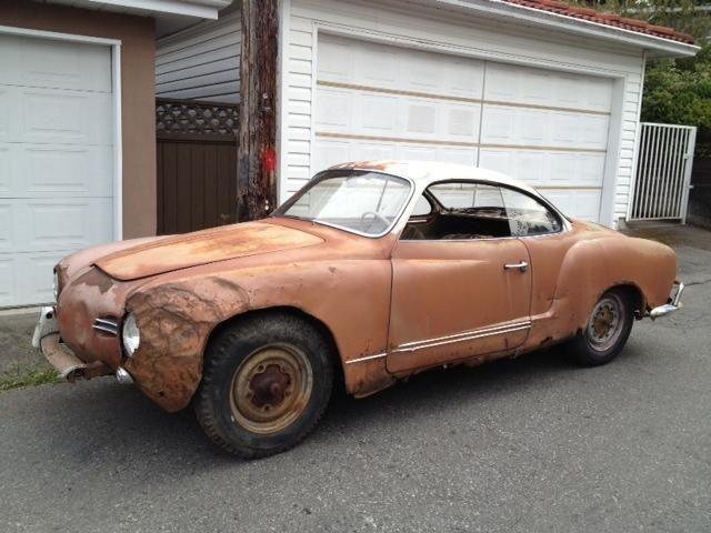

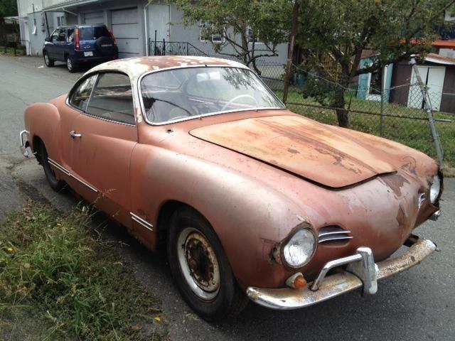

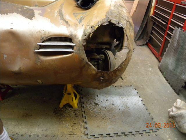

My name is Dave and I have recently purchased a 1958 low light. My goal is to restore the car and get it back on the road. I do not know the full history of the car. The VW museum confirmed that this is a numbers matching car in L352 Cognac and L472 beige grey. It was constructed on the 19th December 1958, left the factory on December 24 and headed to Vancouver BC. It's registered as a 1959 model. It was presumably sold and some time in the 70s it ended up in a farmer's field. It was moved to another field in the 1990s which is where it was when I bought it. So, it seems that for 40 years or so it was sitting in muck - I can certainly attest to that because there is a lot of mud and muck and wasps nest in the car.
Here are a couple of pics as I first saw the car:

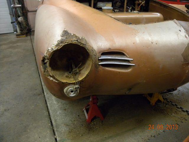

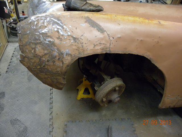

The left front fender has had a pretty hard time of it and they have cut some of the fender away. Restoring that will take some effort. The right front looks better but still not great.

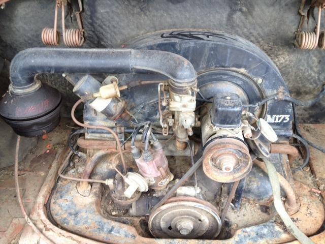

Just for the heck of it, I decided to try and start the engine. It looks like it has never been touched.
Here's a link to a couple of youtube videos ( a bit long) of the attempted start, my friend Gerry with the camera and my buddy Dave helping with the gas in the carb.
and moving the car, no brakes but we did have an emergency brake:

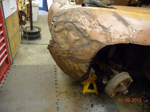

So, the car runs and it runs very well. Now for the body work. I've started with the front end. First, here are the left and right side. You can see that on one side there is a headlight bucket and rust while on the other there is no bucket and lots of crumbled metal.

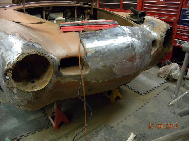

and a big dent in the nose. After much work, the nose looks much better
and the big dent is gone. I then did a lot of metal work on the left front fender and while it still looks rough at least it looks better than before
Tomorrow I will make a piece based on the right fender wheel opening to match the wheel profile. I need to see how much metal was removed from the right side so that I can make a new piece to fit.

You should try using a shrinking disk on that fender. Look them up on You Tube.

Hi I am in Edmonton and I have a 58 fender for that side. Around the headlight bucket it is really bad but it's a lot better than what you have. Best of all is the price. FREE!!!!! I love these cars and I love seeing them come to life again. If you want it pm me your number and I can text you photos of my fender. We can greyhound it down to Vancouver if you want.

Thanks for the comments and positive support. My next step is to rebuild the fender lip on the left side and see if I can stabilize that a bit more before I try shrinking the fender to shape. I'm waiting for a new headlight bucket to arrive so that I have a form to shape around. And I'm following up on the offer of a used but in better shape than mine fender from Edmonton.

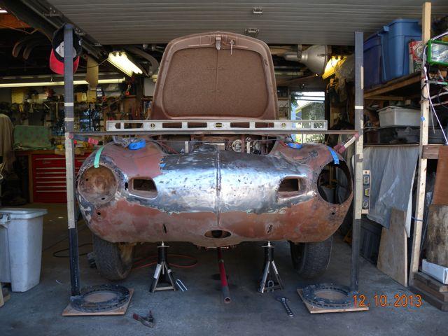

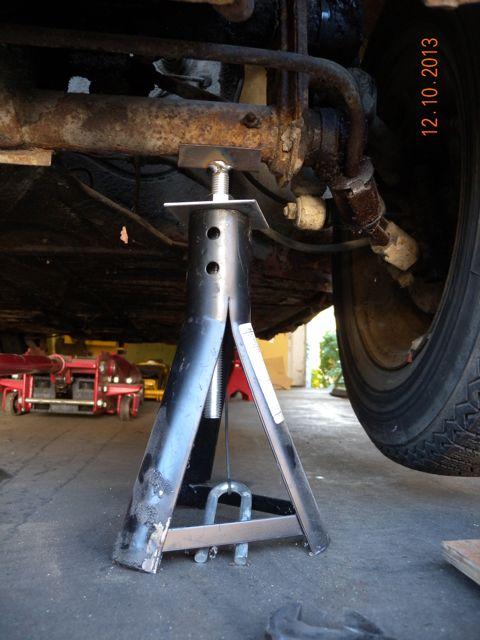

Well, here's an update. Today I made a couple of adjustable stands so that I could get the car level and begin to think about how to make the metal for the fender.
I have also got two tall posts from my friend Peter - he used them as part of a Porsche 962 project. The bases are adjustable so that I can ensure that when set up they are vertical - they don't look vertical in the picture but that's just the lens.
I am going to try and make templates from my good fender and then use them to shape the new fender or even make a new fender. If anyone else has done this I sure would like to hear about their efforts.
