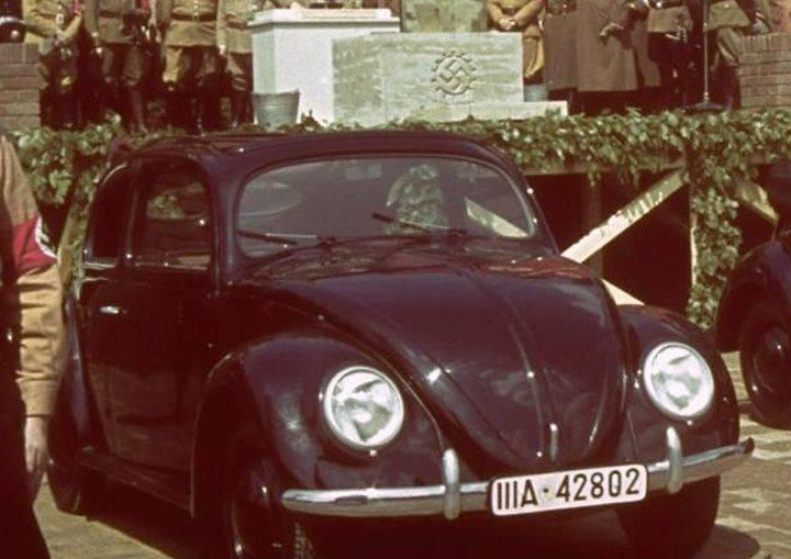

Car 42802 at the factory cornerstone laying ceremony

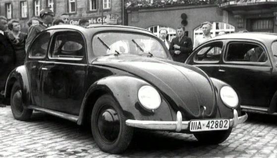

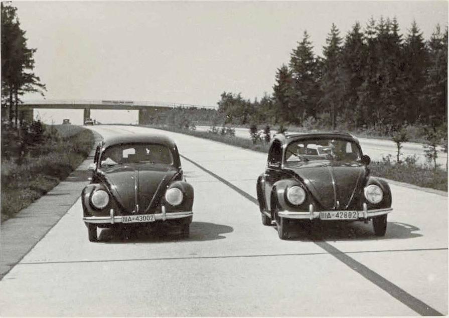

Car 42802 and a later VW38 series hardtop on an Autobahn. Not a lot of visual differences between the two.

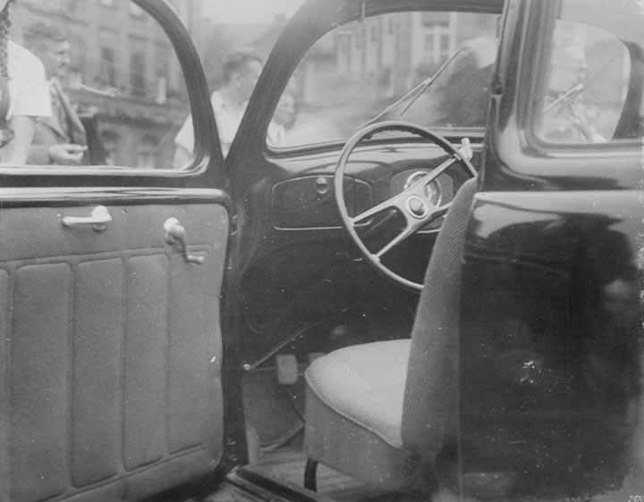

Car 42802 on one of the many promotional tours
This could be car 42802 as what appears to be a sunroof handle is just visible in the upper corner of the windshield (two handles one on each corner of the sunroof). Also check out the distinctive four spoke wheel, the transverse ribs on the floor-pan halves and the seats attached to the floor.

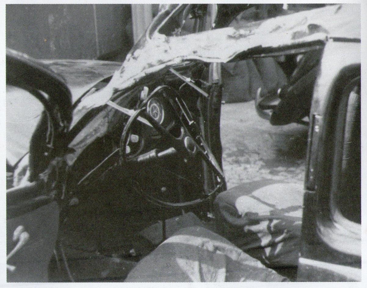

Car 42802 at the end of its short life after the crash.
