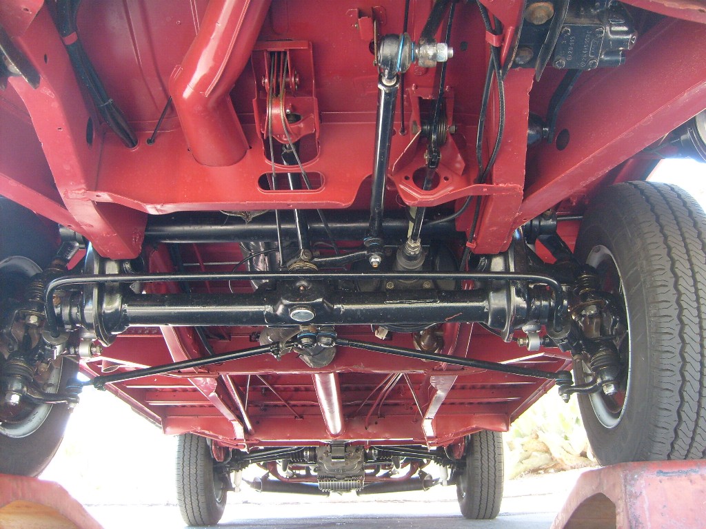

I am old school probably to a fault. My bus already has the grey undercoating on it. I am using 3M Body Schultz to spruce up the undercoating. You have to have a special gun and a compressor to apply it. But it dries hard and is paintable. And Rustoleum Semi Gloss Black out of a can everywhere else. Most of the time I apply the Rustoleum with a disposable foam brush. I love those things. Sometimes I will use my touch up gun.

I am old school probably to a fault. My bus already has the grey undercoating on it. I am using 3M Body Schultz to spruce up the undercoating and Rustoleum Semi Gloss Black everywhere else.
super nice.. love it
what product did you use for painting your axle. nice black clean look

PostPosted: Thu Sep 29, 2011 9:43 pm    Post subject: Reply with quote
The beam and trailing arms were done with Rustoleum Oil Based Enamel. Semi Gloss Black. I sprayed it on with a Binks 115 Touch up gun. They were sanded and primed first. DBM is correct in his prep but after all of that work you might as well paint everything with the same paint as the top of the bus. Like he did. And park it on mirrors. I would. I used scrapers, putty knives, big stiff wire brushes like you clean a BBQ Grill with and a Makita Grinder with a Braided Wire Cup Brush. The one that goes 10,000 RPM and will shred you in a heartbeat if you daydream. It takes alot of time and at the end of the day you look like a Coal Miner at the end of the shift. But if anything is still sticking on after that. It stays. I plan on driving the shit out of this bus when I retire. And it is the underside of the bus. I'm pretty Anal and have OCD but I'm trying to lighten up. I'm on the downside of things and I don't need it to last forever. Just 10 or 15 more years is all I hope for. I'm leaving some work for the next owner. You know, they will have to put some effort into this also. Just so they don't take it for granted.
