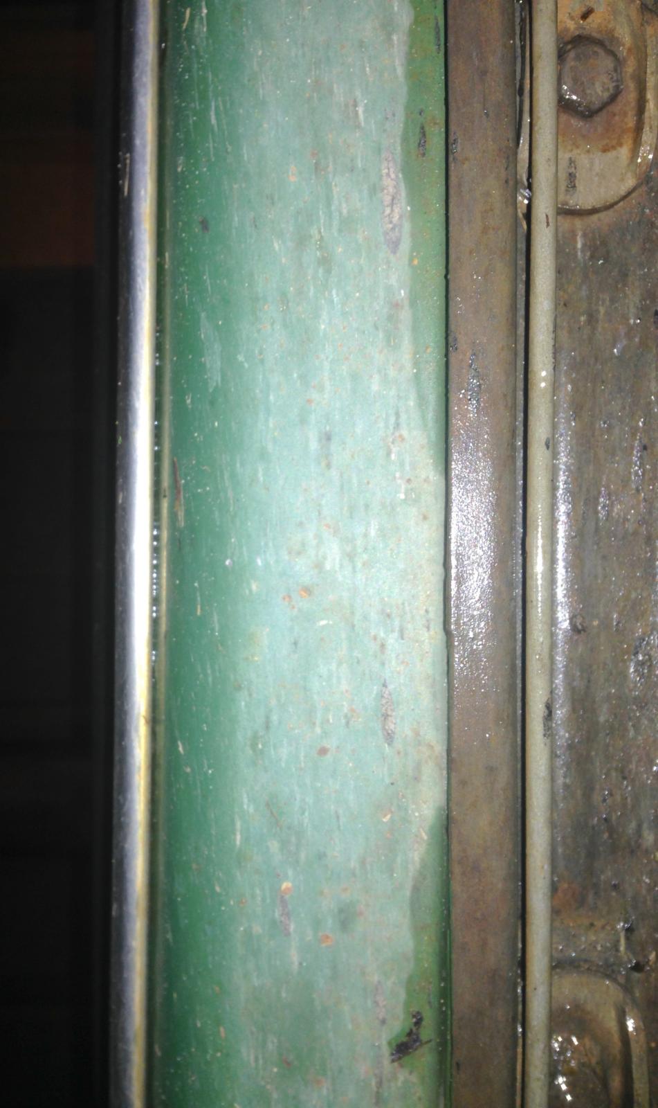

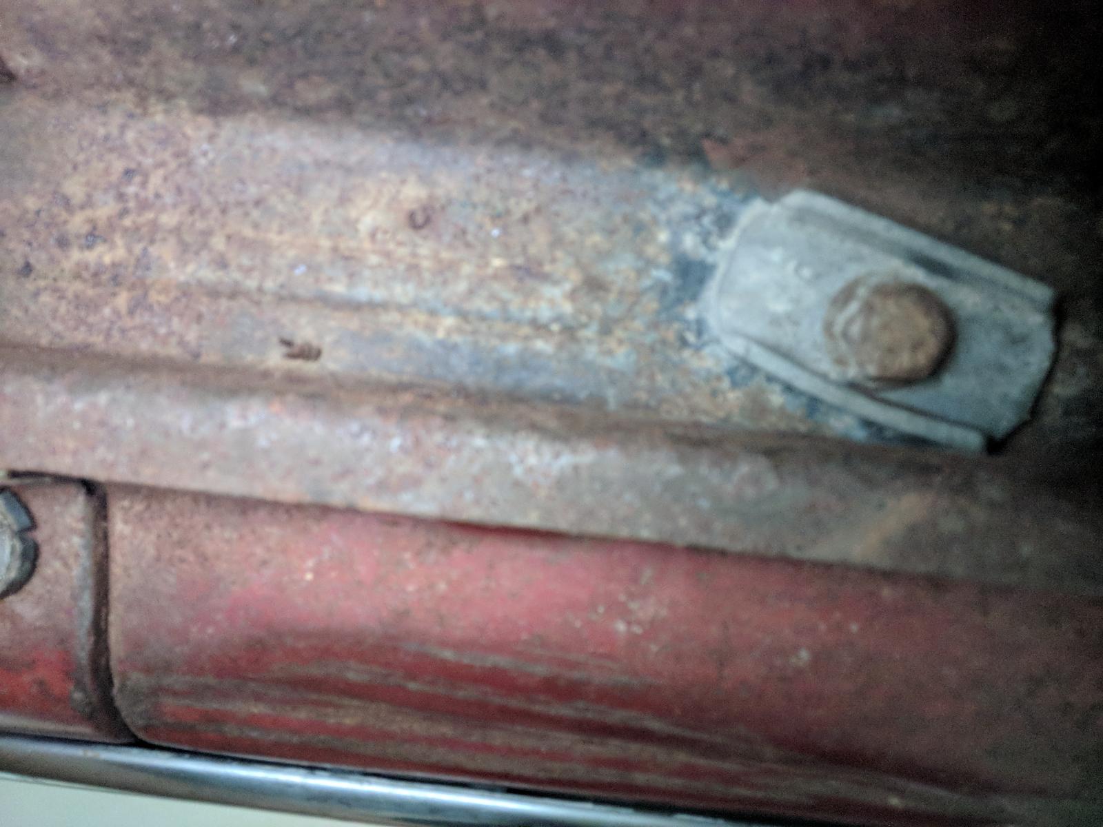

anybody have a photo of underneath their type 3? I need to see what the seam between the bottom of the door threshold and the pan itself. Should there be a gap there where you can see the heater channels?
Just wondering before I do anything stupid

PostPosted: Wed Dec 20, 2017 12:56 pm    Post subject: Re: need a picture Reply with quote
This is under the passenger's side of my 64 S:

PostPosted: Wed Dec 20, 2017 2:30 pm    Post subject: Re: need a picture Reply with quote
Thanks but I'm looking for more of a direct shot from under the car.
This is a photo directly beneath my door sill (threshold). There is a half inch gap between the painted door sill and the floor pan shoulder. I'm wondering if this should be open like this or is it a faulty sill repair.

PostPosted: Wed Dec 20, 2017 3:12 pm    Post subject: Re: need a picture Reply with quote
The rocker/heater channel is multiple layers of sheet metal. That does not look like a good repair, IMO.
I couldn't get a clear shot of the underside of my car but here's what I got:

PostPosted: Wed Dec 20, 2017 3:53 pm    Post subject: Re: need a picture Reply with quote
Here's mine, passenger side:
And driver's side (the tubing is for the evap canister):

PostPosted: Wed Dec 20, 2017 4:49 pm    Post subject: Re: need a picture Reply with quote
Thanks guys- I think my question has been answered-crappy repair
