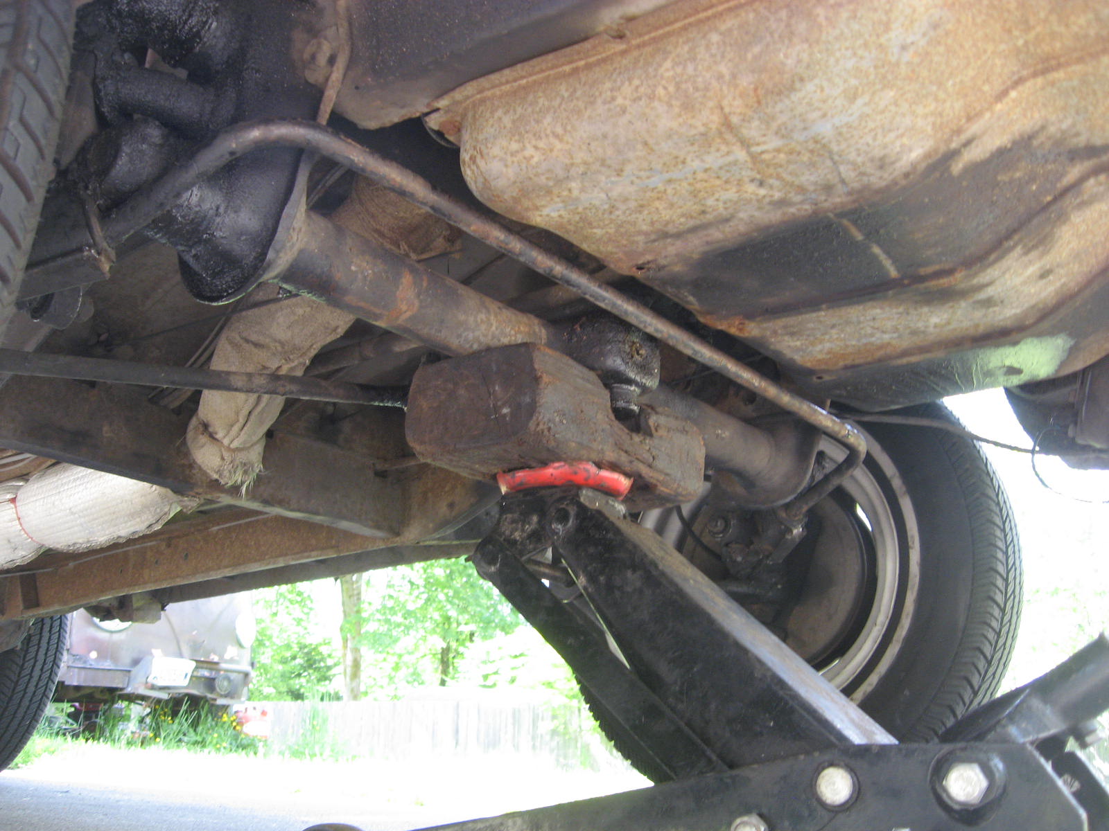

I don't use the stock jack. Okay I have, in a pinch, changed a tire with it.
That is what it is there for. If your jack points are strong it works.
It is normal for the rear wheels to sag and tuck in when you jack up a VW with the swing axle tranmission. The wheels will sit funny when you let it down. Roll the bus and all goes back to normal.
When you lift the front of the bus up, the trailing arms should rotate down when the weight is lifted off them. If they don't, something is rusted stuck or broken in your suspension. You need the flex or you get a harsh ride. Seriously, the arms can get rusted stuck to the beam, and still be stuck even after the truck has been driven from Michigan to LA, or so I've heard.
I have a piece of wood I use for the front, notched for the swing lever pin.
At every 3K miles service, I use this system to jack it up to adjust the brakes and lube the suspension. Can't lube the swing lever pin if you have the bus resting on it.
you can jack the rear up one wheel at a time:
or both rear wheels at once:

Thanks again to all, especially Clara for the wonderful pics. I wish now I had known about using the under transaxle frame member as a jack support point. It would have saved a lot of Bilstein cranking over the 34 years I have owned my bus. And yes, the big dents in this cross piece showed that it had been used before as a jack contact piece, but without the wooden block intermediary.

Great pics Clara. That's what I was looking for. I use the jack points also but need both tires off today and the block of wood is an excellent suggestion but my bus is lowered so this won't work. Any suggestions?
