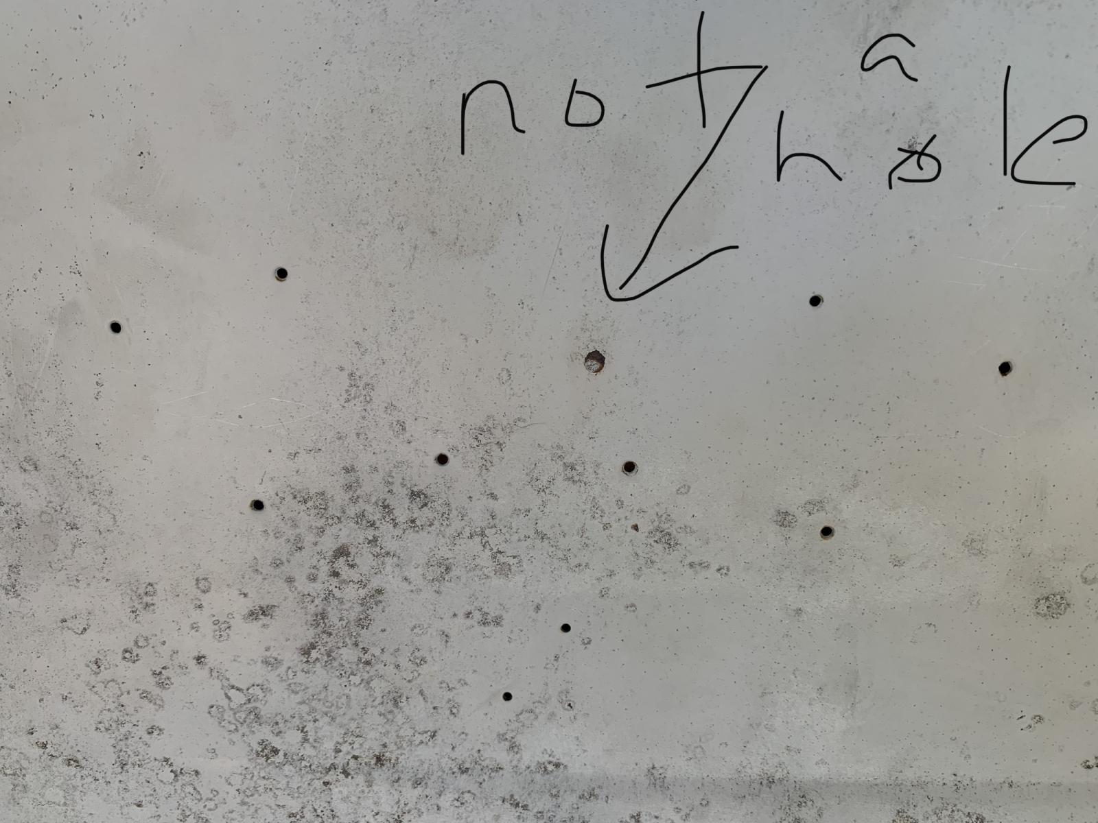

Thanks. I just got it home yesterday and I'm looking closely at everything. First type 3, you know. I have noticed some on some '65 threads that they don't have the side markers. I understand from earlier reply that all '65s were imports. So, they all didn't have the side markers? Mine does. Is it a different model?

Some '64 & '65 models have no side markers as they were built for the Canadian market. The '64 & '65 models with side markers were built for the European market. Usually the hatch script is 1500 for the Canadian market & Variant for the European market.
Good point. Here's the hatch script on my '65 (with side markers)

Then I guessing variant S given the holes on hatch.

The S was the twin-carb version.

Those small holes are for the correct emblems. Top Volkswagen script uses 4 holes (2 upper & 2 lower). Middle Variant script uses 4 holes (2 upper & 2 lower). Bottom 2 (upper towards right side lower towards left side) are for the S badge. That larger hole in the middle was added by a previous owner maybe for a different badge. Later engine cases are commonly used for all models as they are more common.
