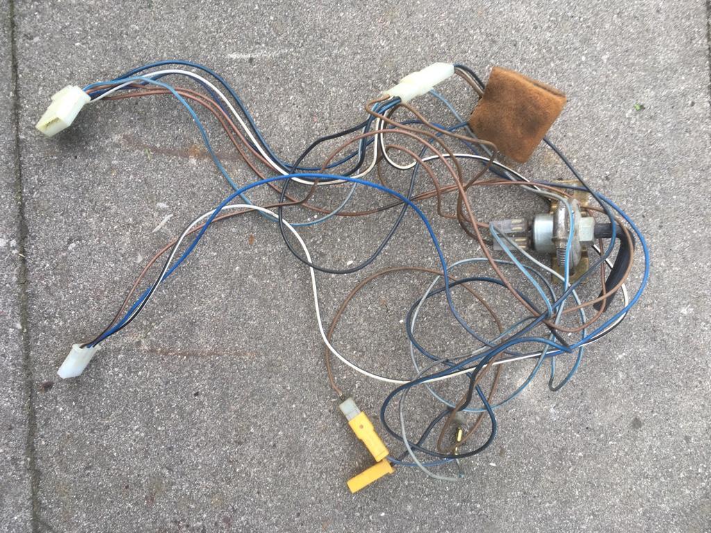

I am looking to purchase this setup so I can have the front locker light blink while it's engaging. It looks like a vacuum pump, wire loom and a PCB board. If anyone has one or a source for one that would be awesome. Thank you.

I wonder if a turn signal relay could be adapted. Instead of turning the light on, the locker switch would ground the flasher relay and would be wired to the indicator light to flash it vs being on full time. You could even add a buzzer if you needed something audible.

The intent of the flashing indicator for the front locker is to warn the driver that front locker engagement is imminent but has not happened yet. This is a safety feature, a flashing warning BEFORE it locks the steering.
The metal item above with a hose and some wires looks more like a vacuum switch than a pump. That switch would be what tells the circuit board that the front locker control has been set to LOCK.
