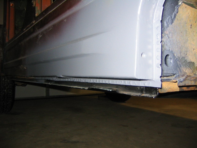

Clues that may lead to a larger rust problem:
No top or windows. These aren't great at keeping out the elements, but they're a heck of a lot better than nothing.
Flexing windshield, glass and gasket falling into the frame. These are signs the lower frame has rusted out - a complex part that isn't easy to fab and is fairly expensive to replace.
Missing body seal caps at the top of the door posts, above the front door hinges and near where the top hinge pins reside. Water doesn't drain from these voids and rust follows.
Missing body seal caps in the wheel wells - one in each. These cover a round opening into the rockers and without them, the wheels can easily splash water into the rockers.
Missing one-way valves at the base of the rockers or the holes are sealed with non-valved caps. The rockers are designed for a bit of water to flow through them. There are a series of dimples in the base of the door frame to allow water to flow in.
(top-right little hole in this photo)
Then there are three holes at the base of the rocker with one-way flap valves in them. If you run your hand along the bottom edge of the rocker, you'll note there are three bumps, each is a small drain hole - verify that you can gently peel open the rear of the cap with a finger nail.
(you can see one of those bumps here on the new lighter-grey panel, middle-left, and the round hole that should be capped in the rear wheel well.)
If these holes are plugged, water splashing around the door or into the door will collect in the rocker and rust will follow.
