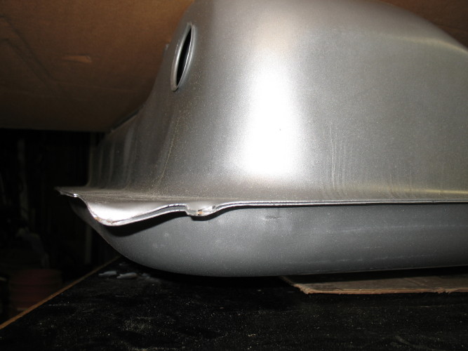

1. Poor packaging--shipping damage

First tank arrived having been banged up in shipping. On the tanks-to-pans website description of the tank, they state that the tanks would be foam wrapped, stretch wrapped, and then boxed. That helped sell me. Alas, not so; tank was loose in the single box, with no edge protection.
Decided I did not want to install it, so contacted them for a replacement. That went OK, but be prepared for dealing with second and third parties. Apparently tanks-to-pans is owned by coast2coastwheels.com, aka coast2coastinternational.com, aka a division of LKQ corporation, aka LKQCorp.com. There was also an email from Spi Distribution Center in the mix. That said, they were responsive to the damaged tank, I ended up talking to a customer service guy in Florida. It seems tanks-to-pans is a new acquistion, they are still trying to get the warehouse packaging and shipping correct, and I was told I am not the first person reporting a shipping damaged tank. They covered return shipping and sent out a new tank before receiving the damaged one.

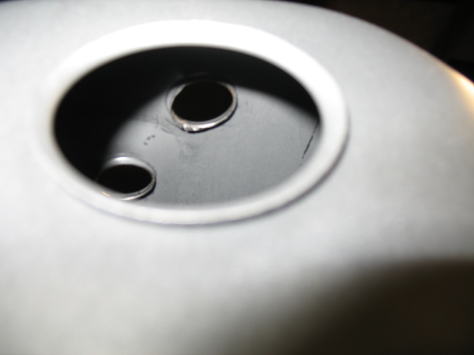

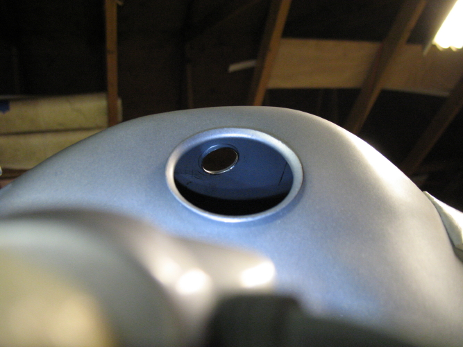

Second tank arrived one week later. I would suggest inspecting the rolled edges of the grommet holes: One had a huge sharp underside burr that prevented proper grommet seating. The pic is blurry but the burr was roughly half the circumference of the hole, and extended down approx. 2mm.
Couldn't afford to wait anymore, so did some fussy Dremel surgery. The cutoff wheel was larger diam than the hole, so had to reach in through the filler opening and poke the shaft of the wheel through the bad hole and chock it from above. Vacuum nozzle then poked through filler hole, taped in place, and running during the operation to catch debris, that sort of deal. Repeat with small grinding wheel to dress the cut. Seemed a decent fix, here is the after pic:

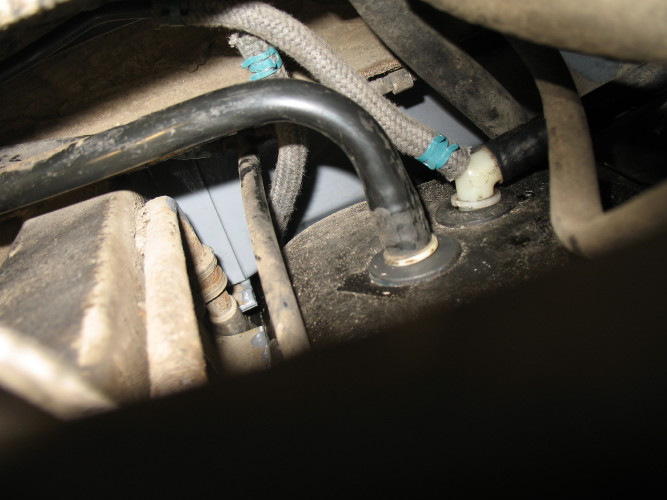

Tank went in reasonably well, it is a tight fit. Reinstalled the OEM rigid plastic crossover assembly, new 2 years ago, which I had left in place on the hook. It seems the distance between these crossover grommet holes may not be exact to OEM. I did not think to measure first to compare to the old tank, but there is some strain suggesting they are slightly further apart. Probably not a concern for those running soft rubber fuel hose for the crossover balance line. This is what I am wondering about:
I say wondering because it was late, cold, dark, raining, I was spent, and if it leaked on full fill-up I was not prepared to deal with it so I have only put 8 gallons in so far. I will do the full fill up probably today for the true test, hopefully no issue here but there it is. There was no such strain on the old fittings when I removed them.

I realize the tank is in etc., but is the crossover tube running over top of everything? Thinking cockeyed crossover might be due to it being pushed down ~ mid point by e brake cable or ?

Thanks Neil, yep, crossover tube is routed correctly, I had read about the need for this. It was actually never removed from vehicle, it is routed correctly and in it's hook. Over e-brake cable, etc.
Filled to about 15gal. today, but did not allow auto-shutoff to engage. So far so good as far as leaks. I can also report that the fuel pump seems a little quieter now. I also went through the EEC system and installed a new charcoal can as part of the service. I am thinking that rusty old tank plus old slightly compromised charcoal can was leading to a bit of fuel pump noise.

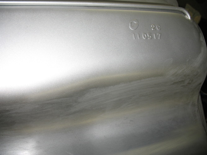

Thought I'd add one more pic showing the manufacturer marking:
This trademark is the same one I've seen in other posts for tanks purchased from van-cafe and bus depot. It seems bus depot is correct in their assertion that all of these aftermarket tanks are made at the same factory (Taiwan, I think I read somewhere) and just sold under different brand names.
That being the case, it really comes down to vendor choice, price, shipping practices, and getting the size outlet you want. Seems the quality control issues would exist across the board, so ability to quickly resolve a bum tank might also be a factor.

you may want to replace the vapour hoses (the ones that go to the plastic over floow tanks) with lined 30R9 hoses. the new fuel formulations will rot out the standard non-lined hoses even though they are not regularly immersed in gasoline, they will still rot out, cuasing fuel smells and eventually leaks. the cloth wrapped hoses you have in the photos are likely not lined.
