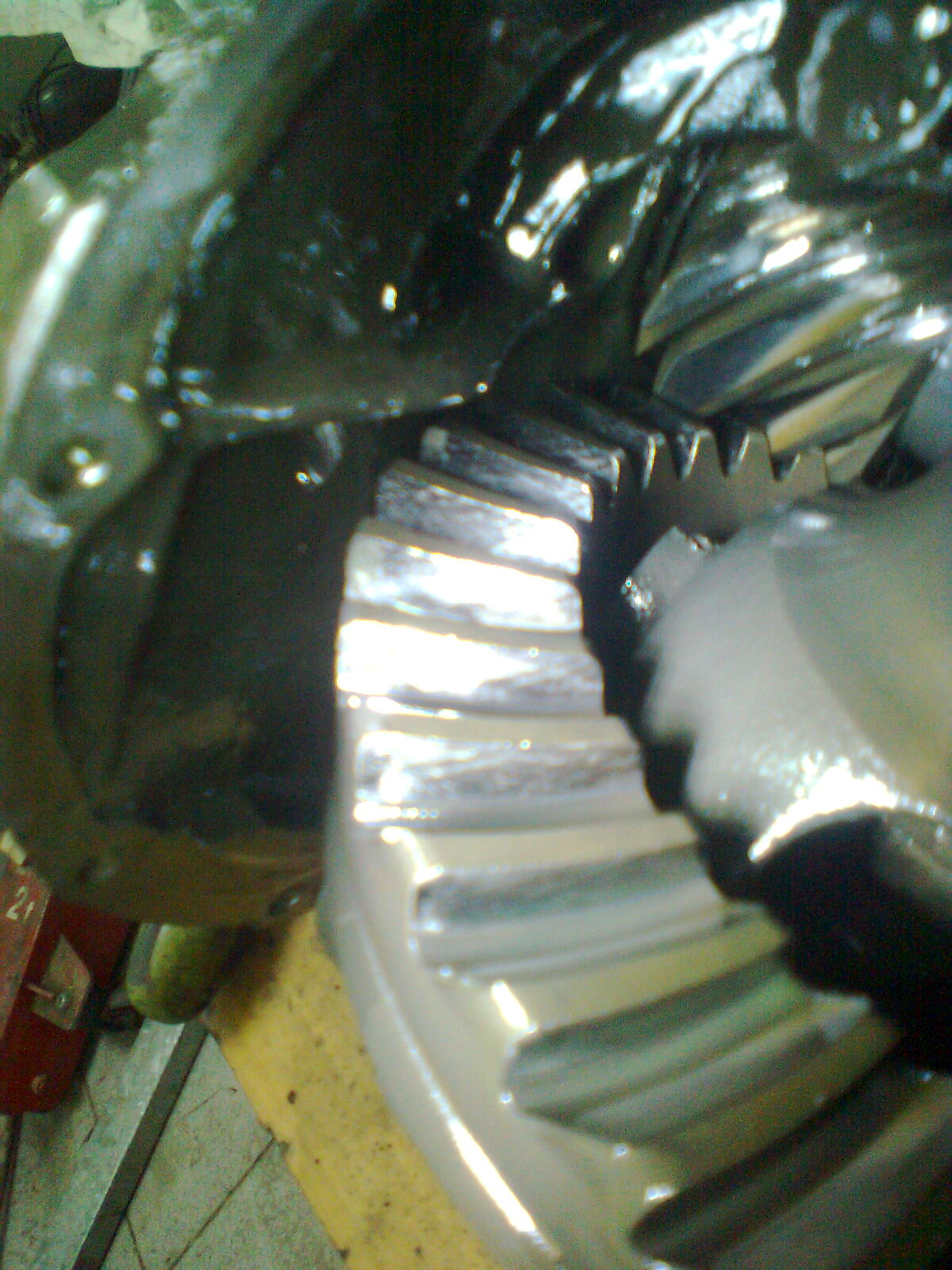

Can you guys tell me anything about that wear pattern? I know it's a blurry picture, I'll try to come back with a proper camera Laughing
I didn't see any obvious damage to the bearings like seized rollers or blueing so I don't really know what to think Confused Confused

ok, better pictures now:

I really don't see any wear. Since you've got it cleaned up, you could always paint the teeth with some dykeum (or use a sharpie or other type of magic marker) and then rotate the parts to see how they interface with each other (the teeth will remove the marker, showing the wear pattern).
You might have gotten lucky and caught it before any real damage happened. You should get a magnetic base, and a dial indicator, and check the back lash too, since the specs are in the Bentley.

I brought the diff unit to a transmission shop so they can check it and change the bearings if necessary, I happen to NOT have a 3-ton press in my kitchen (sadly! Laughing )
still I'm curious if the pinion nut is supposed to be handtight? something tells me it shouldn't Confused (I'm guessing that' means the rear bearing is gone?)

well, it turns out the ring and pinion ARE worn out
