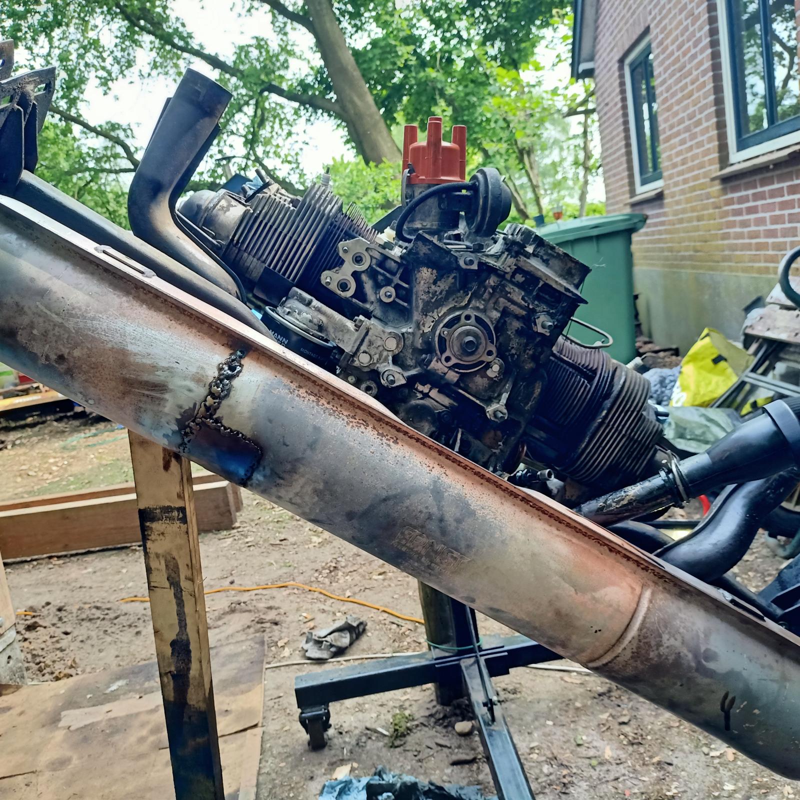

I have een hughe oil leak, last summer we dit a 4000 mile roadtrip and lost about 1,5 gallon oil on the road. Crank and fluwheel seals are oke, saeling oilcooler are oke, new pushrod o-ring, cilinderehead cover gasked are new. Oil pressure switch is new.
There a lot of oil dripping from the deflecter plate/tin. And oil on the cilinder studs.
And on top of the right side of the blok oil.
I'm out of options where to look for to solve this oil leak problem, please help.

The block code is GE, there is no oil comming out of the hole between the push rods. I think it is aa blind hole, the feul mointing is also een blindhole. This calllifornia FI engine has standard a electric feulpomp.
I will investigate the oil gally plugs, where do I have the look, is there a diagram?
And how to test? the enigine is out of the car.
(I had the suspection that the cranck seal was blow but ik looks oke no wearing marks.)

I have checkt the oil gally plug but nothing exeptionals to see. (https://www.thesamba.com/vw/forum/viewtopic.php?t=671543&postorder=desc). But when a flip de engine the right side down (cilinder 1 and 2) nothing happens bu when the left side is down (cilinder 3 and 4) the push rods on the cilinderhead begin to leak oil. I have change the o-rings 1 year ago on both sides. The cilinder head on the left side is a different manufactor AMC. Would that be an explenation?

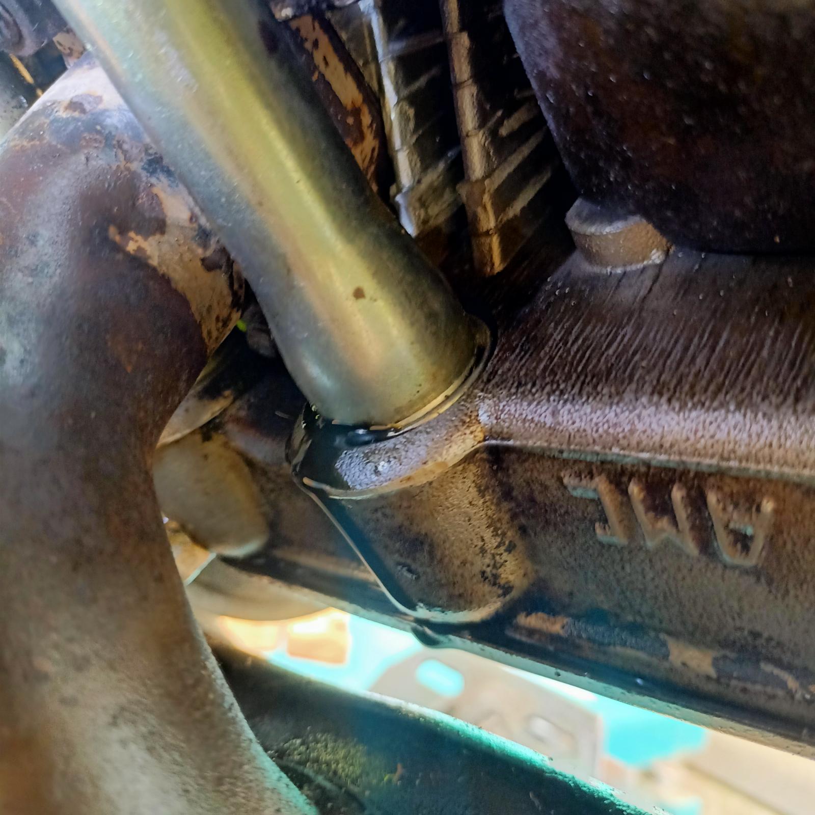

It looks that the oil gally plug above the push rod tube on cilinder 4 is sticking out or it just a burr?

two years ago I replaced the o rings on the pushrod tubes. Upon closer inspection I discover that the o rings on the head side are flat on the outside. And they broke in two when removed. I don't understand why they wear out so quickly.

usually when buying the O rings for the tubes, get the 'Viton' trade marked ones. They may still split when you pop them out years later anyway....
