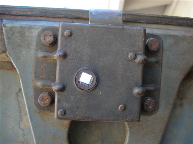

Yes, the actual latch.
Photos of key code 4E6:

On the BUM locks the only number I have found i here.

PostPosted: Tue Dec 13, 2011 6:26 pm    Post subject: Reply with quote
Thanks Everett that's exactly the pic I needed. That's where my WV 345 is stamped. I just need to get a key cut for this old girl now. Very Happy

The lock and BuM key pictured a few posts up is my lock.

Yes, this is exactly what I used for my '55.

PostPosted: Mon Dec 19, 2011 8:02 am    Post subject: Reply with quote
4E6 means taylor 62VE or V68K key blank. the wafers in lock should be 45441
