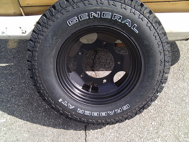

Has Anyone had success installing the AC Industries on these style 14 inch rims?
Just spent a busload on tires and rim repair.

It says in bold type below the description that 15" wheels must be used. I know your 14's aren't stock but I would assume that they wouldn't work with the AC kit.

Yup Capt. saw that. I just remember reading a post somewhere where a guy mentioned he had luck making the caliper fit with a 14 inch after-market rim, searched and can't find it, was just hoping to get a few opinions.

Got the AC kit on mine. I really do like them. I originally had them with my stock beam. I've since gone to a type 1 ball joint beam that I both narrowed and installed adjusters on. The brakes swapped right over to the stock bug spindles...no problems.
I do know that the calipers seem to barely clear my 15" wheels up front...can't see how they would work with 14's.
