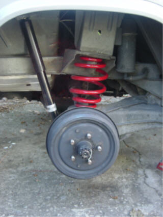

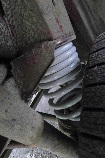

PostPosted: Sun Jan 01, 2012 4:29 pm    Post subject: Reply with quote
My ears were burning!
Here's some pics of the rear springs installed. Any feedback is appreciated.

PostPosted: Sun Jan 01, 2012 5:12 pm    Post subject: Reply with quote
Shocked Shocked Shocked

PostPosted: Sun Jan 01, 2012 5:18 pm    Post subject: Reply with quote
Is it that bad?

PostPosted: Sun Jan 01, 2012 5:20 pm    Post subject: Reply with quote
Gold bars in the back?? Very Happy Shocked Whats the set up on your van when that pic was taken?

PostPosted: Sun Jan 01, 2012 5:25 pm    Post subject: Reply with quote
Stock syncro westy with nothing else inside.

PostPosted: Sun Jan 01, 2012 5:27 pm    Post subject: Reply with quote
Ya WTF are you packing around in your van? !
If that's a unloaded van I'd say something is amiss. Caution with gw, if you talk to them about this & you have a engine conversion they like to say they are designed around a stock vehicle weight so the engine you installed that weighs 2lb more is the issue.

PostPosted: Sun Jan 01, 2012 5:35 pm    Post subject: Reply with quote
No, completely stock. Haven't done the alignment yet either.

PostPosted: Sun Jan 01, 2012 5:51 pm    Post subject: Reply with quote
Yeah... that did settle quite a lot since yesterday. I'd send a pic to GW if I were you. Maybe they have a comparison photo handy.
I don't think they're open until Tuesday, though.
