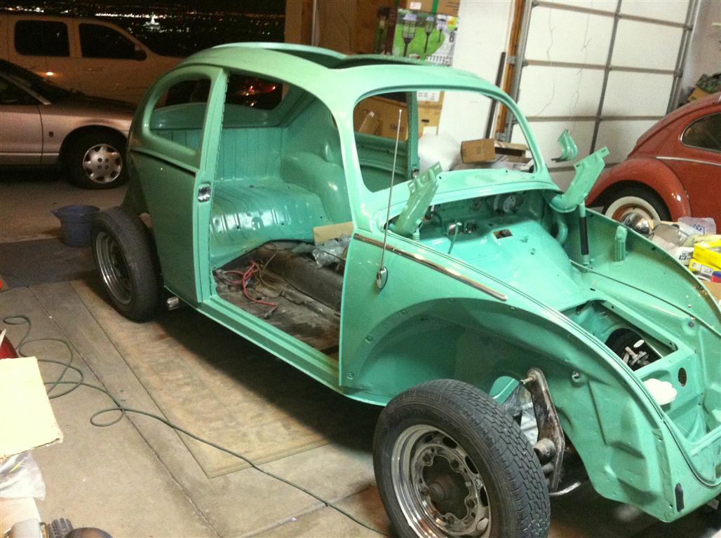

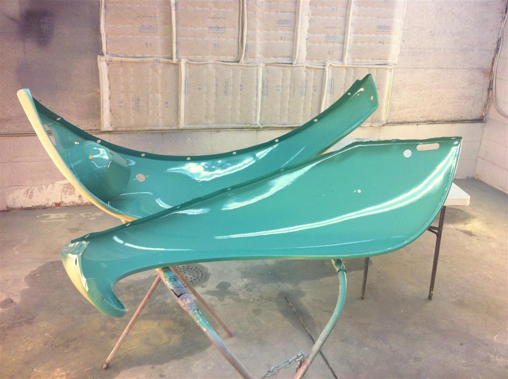

Paint is so close to being done. It wasn’t ready and waiting in the garage when Wade got there Friday like I’d hoped, but I did take him by the shop and let him see paint on the backsides of the decklid, hood, doors, and fenders. All the small parts were also painted, and we took them home with us. Trent was planning to spray the front sides of all lids and fenders Saturday night, and finish the body shell last night, so it may be done right now - fingers crossed! I’d love to have it back in my garage tonight.
Here’s a few shots from our visit Friday night.

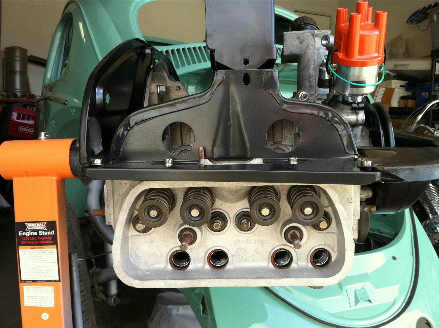

Rome wrote:

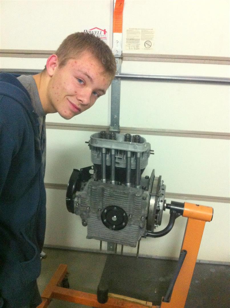

Appears that your connecting rods for cylinders #1 & 2 (the tow for the right side of the engine) are installed upside-down. IN the crank photo with the cam drive gear on, those two rods (closest to camera, then the 2nd furthest one) should have the small rectangular "pad" on the shank facing upward. This pad can be clearly seen on the rod for #3 which is the farthest one from the camera (closest to flywheel). If my observation is correct on your engine, hope you can correct that before you close the case.
Stock-type connecting rods have this pad to clearly indicate the assembly orientation, due to a very slight offset of the rod.
X2 Please revisit this... nice build, a shame to have motor difficulties at this stage.
Check the shop manual for correct connecting rod orientation, you will kill yourself when you try to install the cylinders. This was bothering me from the get go.

Already fixed the issue, thanks. This is why I love the samba - so many people willing to jump in and help out.

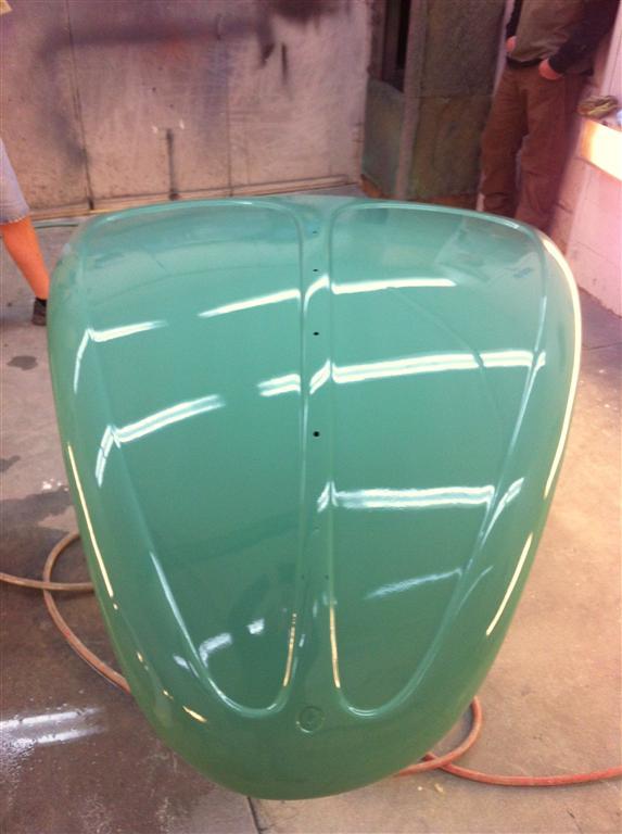

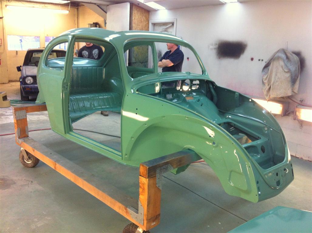

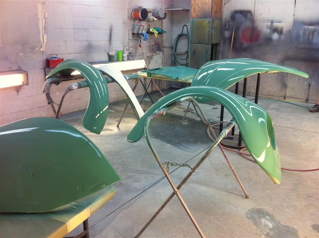

Stopped by the paint shop last night to check on status. Trent was in the middle of spraying first coat of paint on the fenders, doors, hood, and decklid when I showed up. It looks so good!! Very Happy

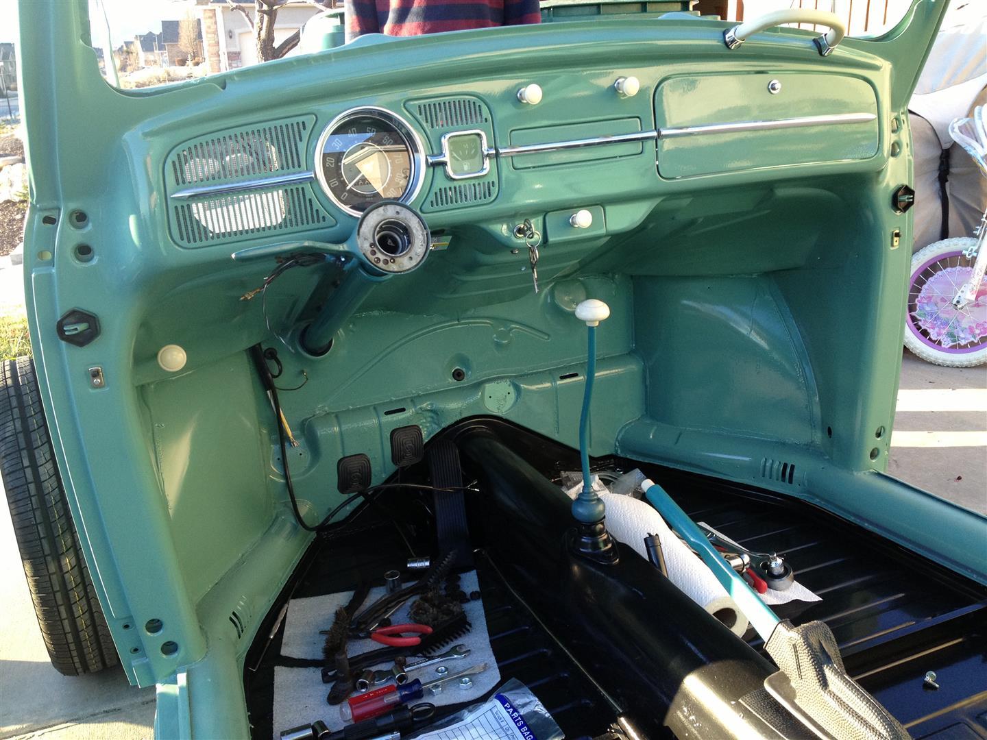

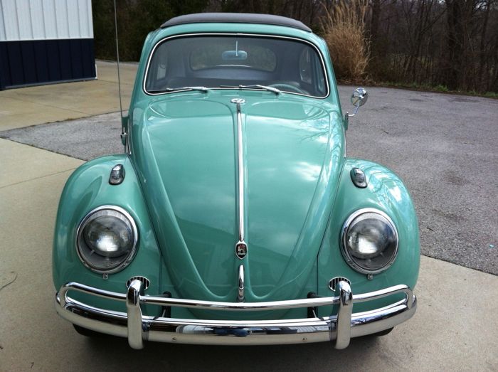

Our painter finished spraying the shell last Wednesday, and immediately began color sanding & buffing. By Saturday, the shell and decklid were completed so I took them home and began the reassembly process. I have to say, I'm more than impressed with our painter, Trent, and his skills. Every panel is like a mirror, and he's been so good to work with. I wouldn't hesitate recommending him to anyone that may be looking for quality body & paint work.
One of the first things I installed was a clear-needle 90mph speedo I picked up from Ryan Ousley at Orange Empire Speedo a while back. Although early 61 models actually came with a white needle speedo, these clear needle 90's were built from May - July '60 so they're period correct, hard to find and definately cool.
Also mounted an original Dehne fuel guage that I have. Unfortunately, it needs some $$ parts to be operational so we won't be running it initially. Once I'm done hemorraging cash to get it running & driving, I'll come back to it.
Also installed an NOS ignition and NOS 1-year wiper switch & pump, side trim, and the antenna. It's starting to look like a real car again!

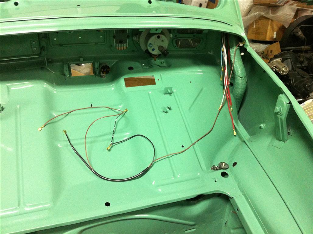

Got the new wiring loom installed last night

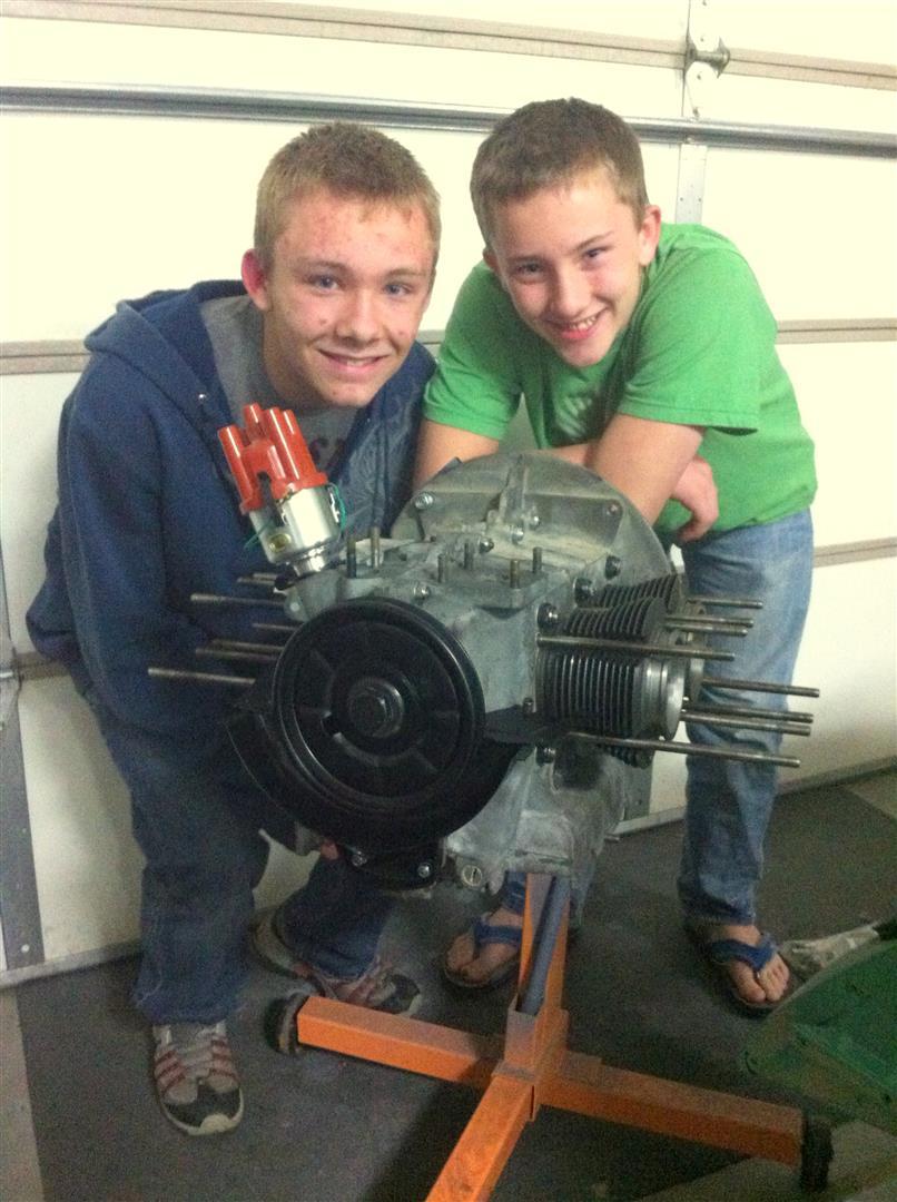

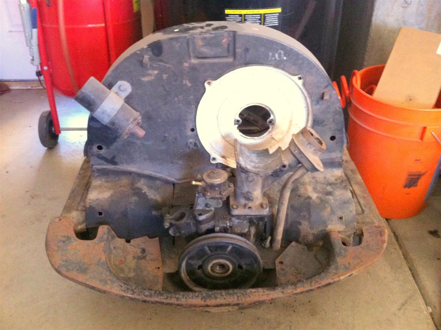

One cold night in February, the boys and I stayed up late and finished assembling the stale air 40hp engine. We had a local VW machine shop set the end play, but we did everything else.
Here’s what we started with:
Here’s where it is now:

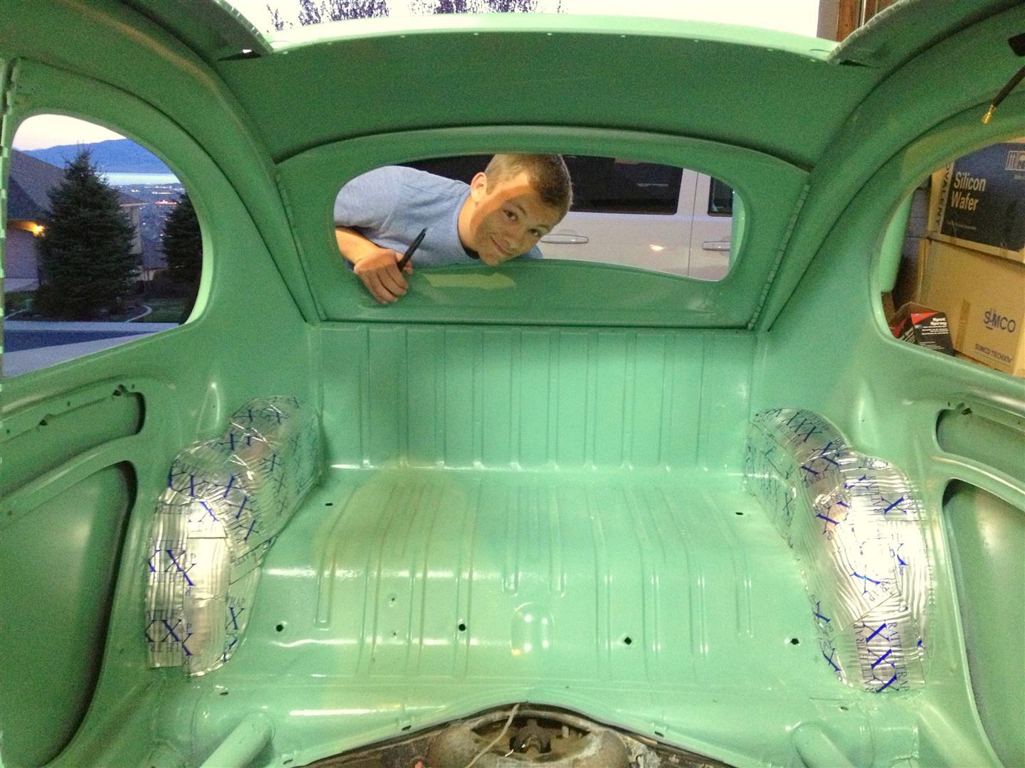

We final prepped the chassis & body by adding the pan gasket, installing rattle trap on the chassis tunnel and body, installing front seat belts, and adding new tar board to the engine firewall.
