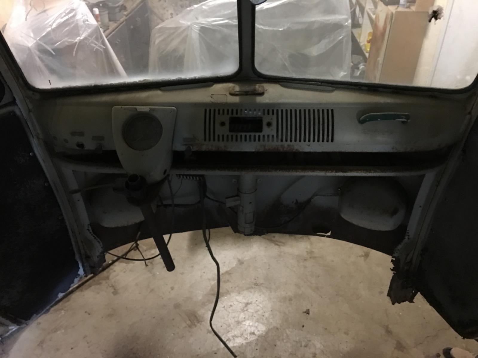

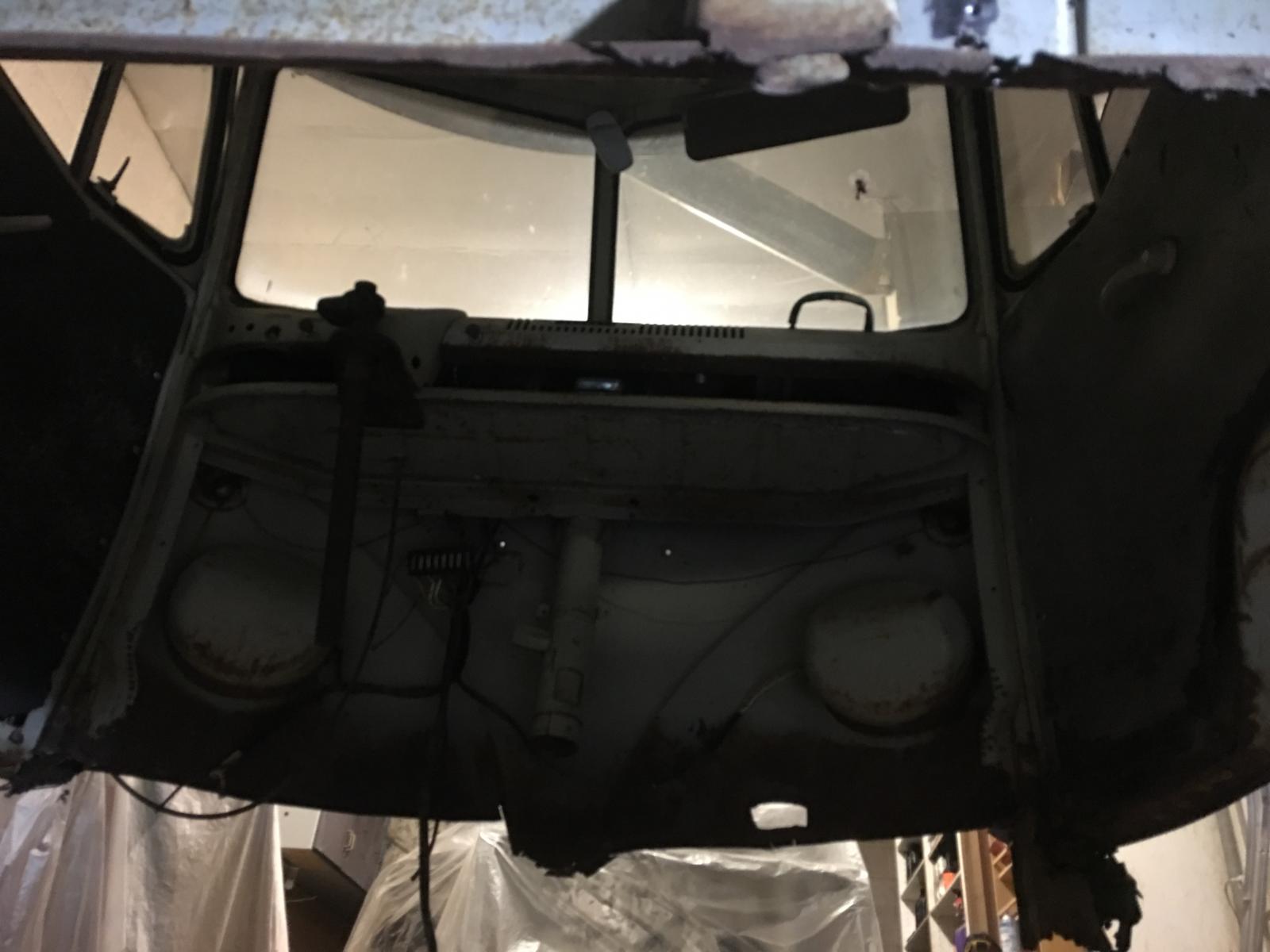

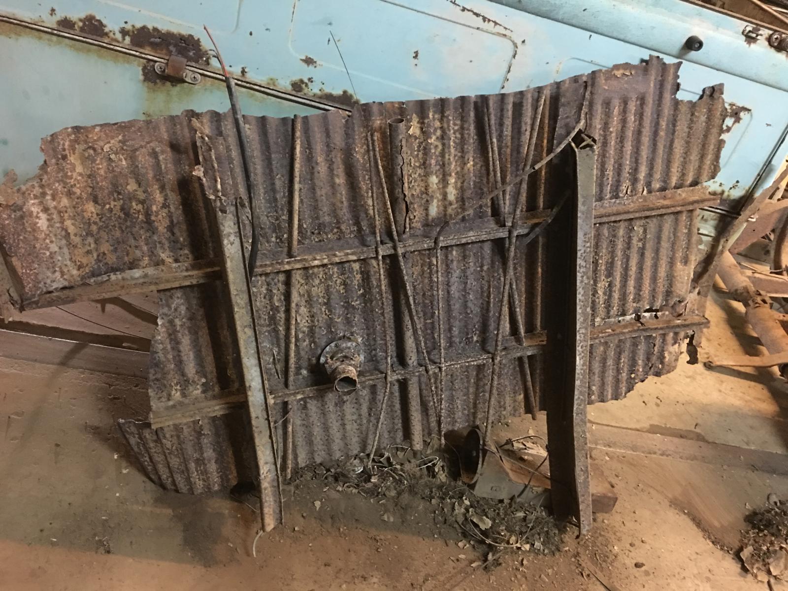

Last month I bought a 1961 double cab out of Iowa, she's really rusty and will need a new frame and much more.
So I found a 1960 bus that was laid on its side for the donor bus to save the double cab.. Let's see how this goes!!!

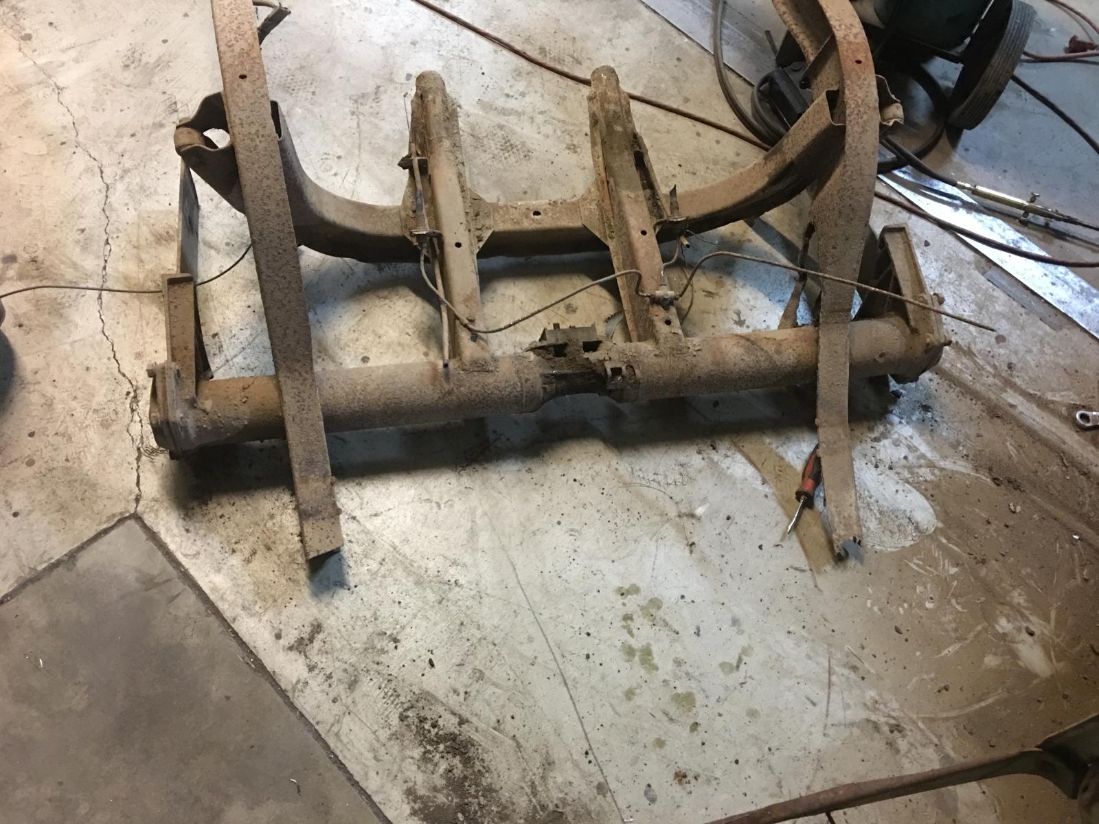

Cool, I want to see some frame photos!

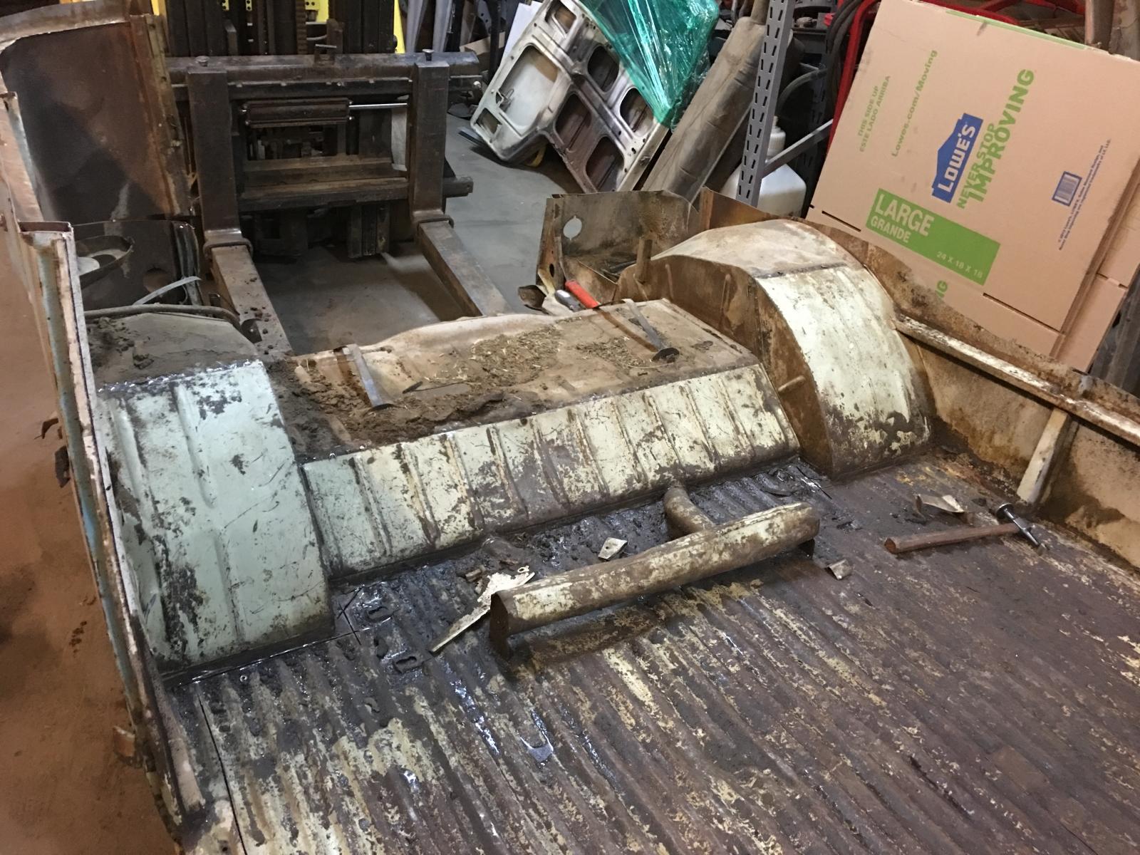

PostPosted: Mon Nov 21, 2016 1:01 am    Post subject: Re: 1961 double cab pulled out of Iowa Reply with quote
billiejohnson
Joined: July 26, 2011
Posts: 66
Location: denver co,
billiejohnson is offline
PostPosted: Mon Nov 21, 2016 1:05 am    Post subject: Re: 1961 double cab pulled out of Iowa Reply with quote

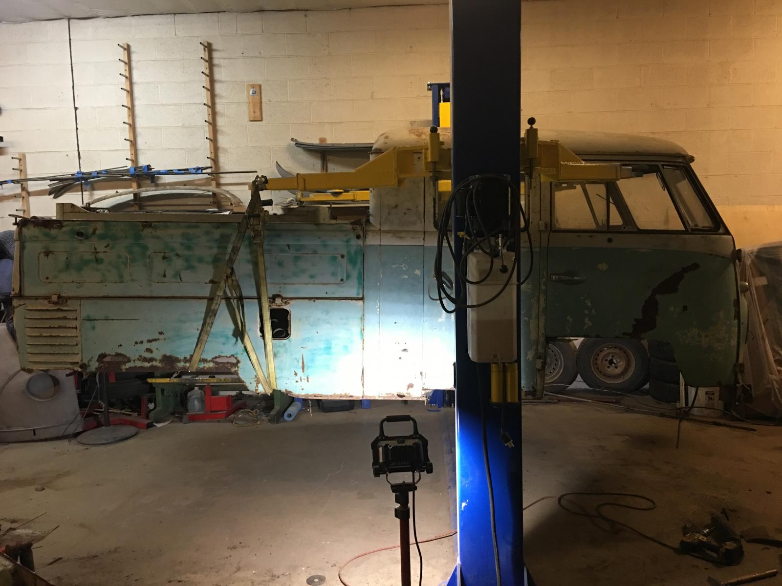

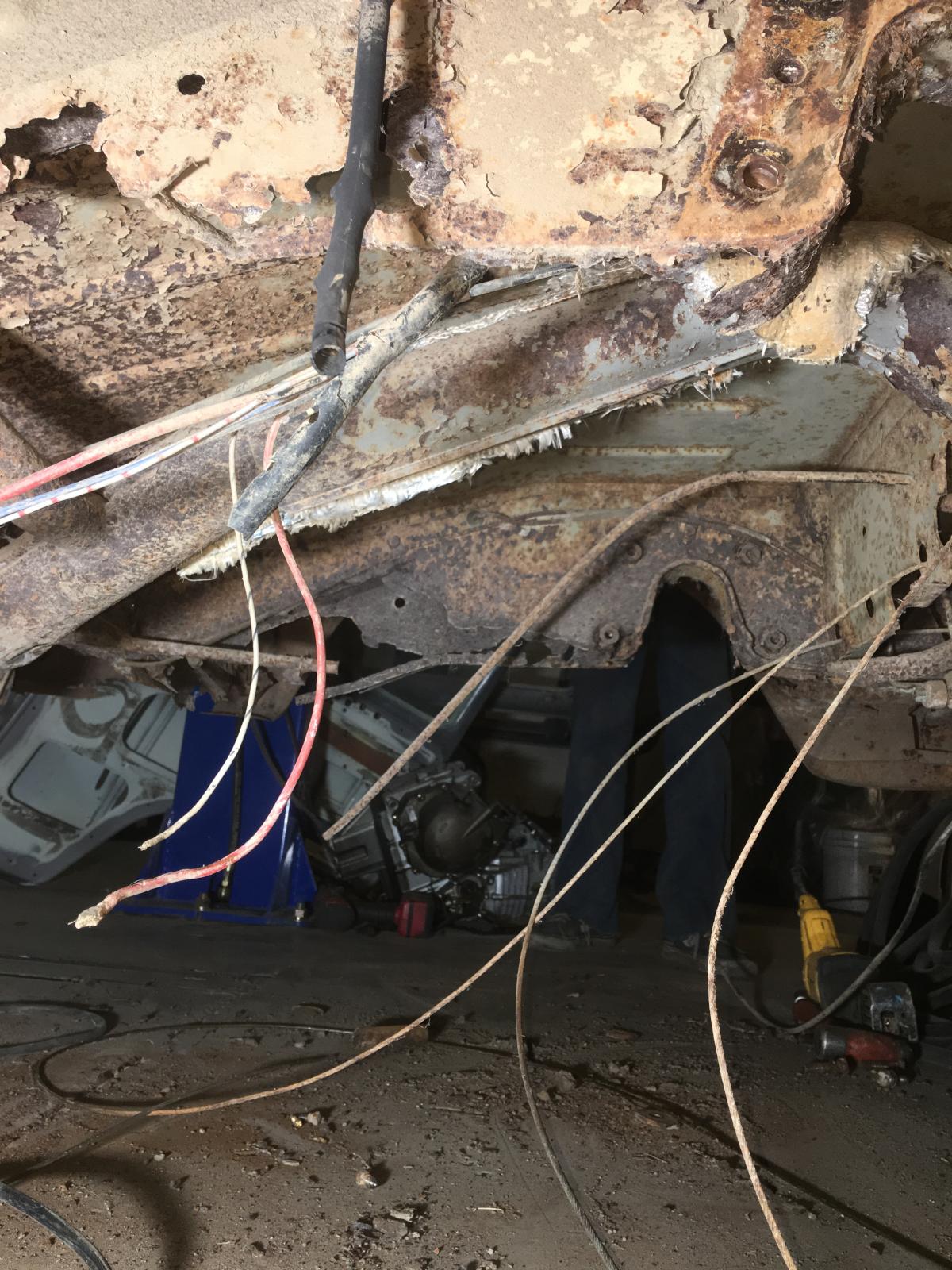

So far so good, got the body on jack stands, body is holding together good so far. I should have the new from under her next Sunday if all goes well.

You never know what another person's definition of rusty is, but those frame pics tell the tale.
Bullet/seamed gate d/c is a good candidate for a "frame-off" restoration. Hopefully the parts bus you picked up will have most of the metal you need. Look foward to seeing your progress.
Here is a good way to brace up the cab to keep it structurally stable. If you position your bracing just right, you can replace the dog legs and fit doors w/o interference. I replaced a frame section on this bus and when I made my final cut through the frame, there was no tension released and everything stayed lined up; worked great.

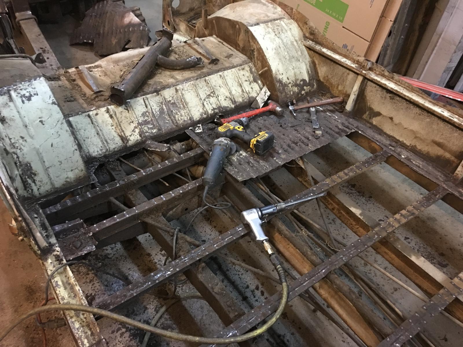

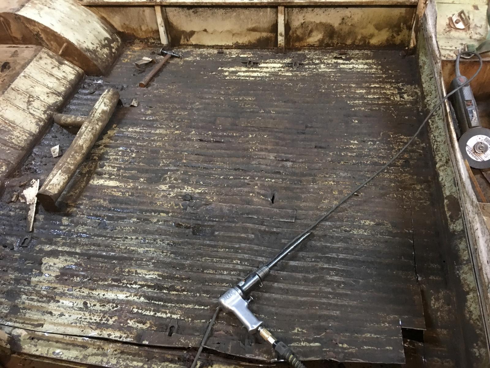

I got a ton knocked out late tonight. This weekend I'll be able to get the frame finished and ready for the swap, then tons of bracing on the double cab and get it swapped over:)

Excellent job of harvesting sections. You will succeed in your endeavors.
Fat chick owner/operator
billiejohnson
Posts: 66
PostPosted: Tue Nov 22, 2016 8:31 am    Post subject: Re: 1961 double cab pulled out of Iowa Reply with quote
Thanks, I don't like wasting good metal, especially original metal.

Finally got everything out of the way and was able to get the frame in place
Now to order metal and start the long process of making it look good again.
