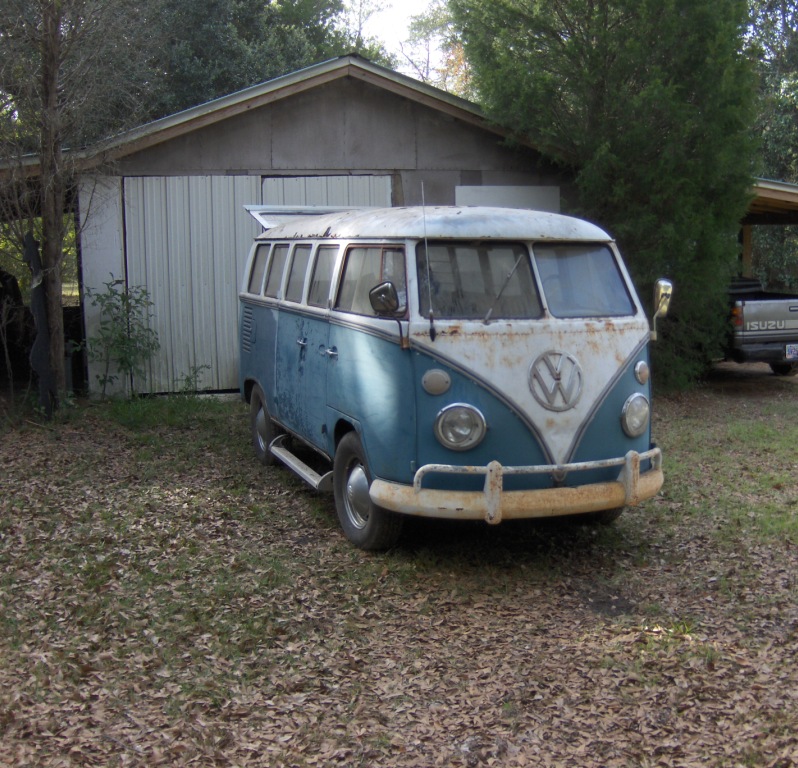

I was able to buy this bus from a guy who actually lives less than four miles away from my house. It is a 1966 deluxe.
It has all of the seat frames and springs, front, full middle seat with movable backrest. Most of the parts are present, original motor, interior panels. I will need to hunt down the correct deluxe rear bumper, and the deluxe beltline trim and a few other things. But, all things considering, I am pretty happy that I was able to pick it up with many of the key parts, especially the seats. I am so excited it even has the dash clock.
There are two small areas of concern in the front floor and along the cargo door floor area, but not too far in, maybe only 3-4 inches. I am thinking the rocker panel on the door side will need some attention down the road.
There are a few dings here and there but nothing too major.
It will have to sit for a while, but I plan to slowly but surely get it road worthy again and then I will decide what I want to do long term with the bus.
This is my first bus, and my first aircolled VW, so I am sure I am going to have a million questions, once I tear into it....Hopefully the bad picture from tonight shows up. more pictures to come later.

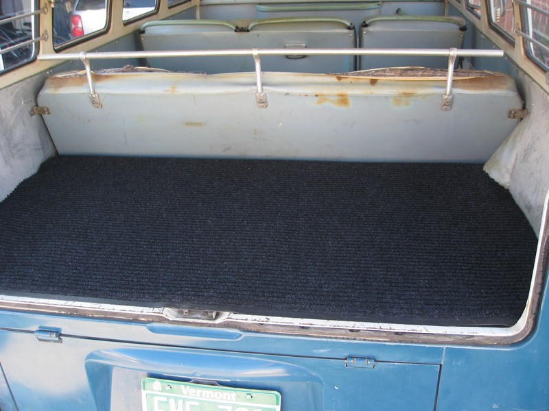

I cleaned the trunk area today. The sound deadening material was all dry, crusty, and sticky. I plan to put something back in way down the line.
What do you recommend?
It was nice to get it clean. Now that all that stuff is gone, it will be easier to sand when I actually get to that stage.

I bought a piece of rubber backed carpet from Home Depot and cut it to fit. I wouldn't stick any Dynamat on it or anything of that nature. Below is a pic of what I did......it was cheap too.

Although not "correct", WW sells rear luggage area mats. Very heavy and nice quality.

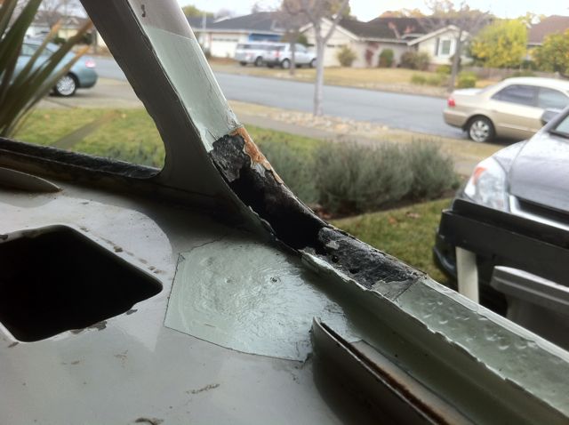

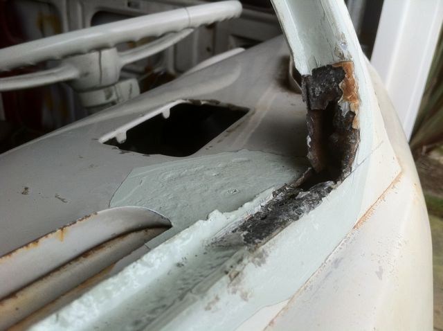

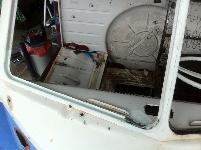

I started the tear down process of my bus on Sunday. I was aware of the rust issues on the bus when I bought it. That said, the rust in the front window area caught me off guard. I’m hoping this is not a continuing theme. I’m sure I will learn many lessons with this first bus.
Below are a few pictures of the front window frames. I know KF and AC sell replacement panels for the window section. I have read the forms about the two companies. Any suggestions which ones I should buy?
Also, I am a bit concerned about the inside section of the window frame, the cab-side. Specifically, the lip of metal that comes up from the dash that fits up against the actual window frame. I know the actual window pane will sit in the new section installed from the outside of the bus. What happens on the inside? Will I need to get a donor dash, or do I just treat it and seal off the rust? I do not want to see a jagged edge, but the lip appears to be very small. Will that small bit of metal actually get covered by a new rubber seal. I really want to fix it, but don’t exactly know how. Any suggestions? Does a new dash take care of that problem? What would you do? I want to fix it and make it right, and not do a crappy job.
Also, I knew that the front floor needed attention. I know that floor panels are available. My question is that the passenger side front floor, I think will clean up nicely and the new piece will be ok to weld to the wall that buts up against the back side of the floor.
However, the drivers side floor has a few more issues. Where the floor buts up against the wall on the back portion of the floor, there is some rust. Does anyone sell metal replacement that can be used for that section? Clearly, I will not be able to just cut out the floor and weld in the new piece, like I will be able to do on the passenger side floor. Will I need to simply fabricate that section out of some sheet metal? Does anyone make that section?
I took the front bumper off to examine the front end a bit. The front valance looks pretty solid. There does appear to be a small amount of rust bubbles on the surface. I took off the bumper mounts and looked inside that section, it only appears to be surface rust. I could only see what can be viewed through the small slots.
If I have the front section sandblasted/media blasted to remove the rust and then have it sealed with epoxy primer, should I be ok?
When I was under the bus, there was a splash guard, that I still need to pull off, but the underside of the bus is really clean, minimal surface rust, no areas that have major rot. All of the frame support sections are solid. The wheel wells are really clean as well. It is so strange how once section has bad rust rot, and other sections are clean. I guess it has to do with water concentration because of bad rubber seals.
Lastly, the front end has a decent size dent. Do I have it pulled out by the body shop, or do I replace that section with a new partial panel? I do not want a bus full of bondo, but the dent looks like it could be re-worked by a pro?
Thank you for any and all of your answers. This is a major undertaking for myself. I’m excited to learn about the best options from all of you.

Gerson has all the metal you need to fix the windshield area. The Gasket does overlap the inner lip, but I would imagine if it is nearly gone it woudl leak.
If that is all you find you are in great shape!

You can make that trailing edge of wheel tub out of a piece of scrap. Cut it, fit it and weld it in. Then your new floor pieces will have something to attach to.
