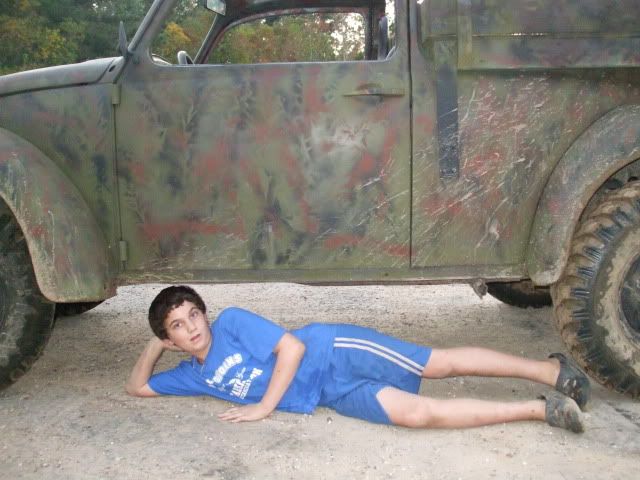

my truggy has 18 inches of ground clearance. cut and turned frontend and reindexed rear. 700x15s all around.

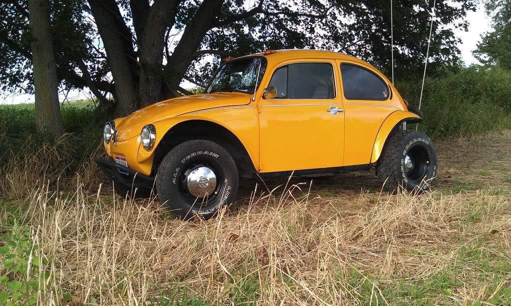

PostPosted: Mon Sep 12, 2011 5:54 pm    Post subject: Reply with quote
adjusters on front, reindexed rear. spring plates aren't notched so no need for new cv's.
This was the best pic I could find of the clearance, haven't actually measured but I very rarely hit the ground
Shocks don't provide lift, they're only for a smooth ride, like parfree said. Cut and turn + reindex is a virtually free lift

PostPosted: Tue Sep 13, 2011 8:39 am    Post subject: Reply with quote
poomwah wrote:
I wish I knew how you guys were getting that much lift. mine is almost hitting the stops and this is all I've got
i ain't giving up nothing. just kidding. after my truggy went into service at the lease things have changed and settled. add lots of mud, hunting gear, feed corn and dead things along the way and the suspension settles a lot. i ended up putting baja fenders on the rear and trimming the front fenders up because of rub in funny positions. my rear springplates sit on the stops when it is empty but loaded down they are about 1/4 inch off. i know running the 700x15's give the height but you loose turning radius which is not so good for a DD. i also have the 1/2 cut and turn in the front which gives a inch but is a rough ride.
before i trimmed.
