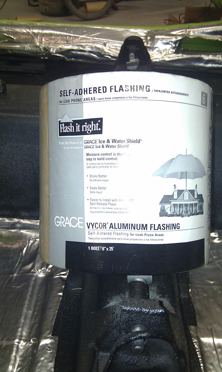

try this stuff. I picked it up at Lowe's. 2 rolls should be more than enough to do the whole car if ur doing the floor boards too. if just the doors than 1 roll. |

Do a search for sound proofing - lots a good threads. I use "Quik Roof" from Home Depot. _________________ D-Dubya Manx clone 1914. Ex wifes car.

hello, You can go to home depot and buy quick roof in the roofing dept or lowes roofing called peel and stick, also buy 1/4 inch carpet pad to put over the roofing material for added deadening. They are both good and have the peel and stick option...they come in 6 or 8"x25' rolls Good luck let us know what you've done and how it works, thanks _________________ Kusten Kruezers VW club, Fort Walton Beach,Fl |

The stuff at Lowes is considerably thinner than Quik Roof (Home depot) and doesnt bond as well....... Ask me know I know. :oops: [/quote] |

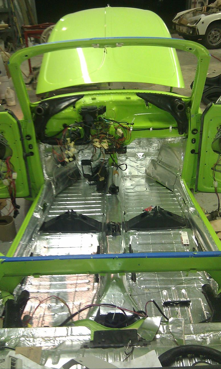

Here is what I used. It came from Lowes and is about $16 per roll. It took six rolls. I am planning on adding sound deadening material that is about 1/2" on top of this before carpet goes in

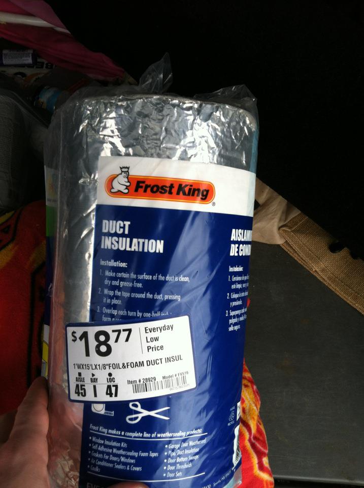

Just read up. None of the stuff from Lowe's or Home Depot is sound deadening material. You get what you pay for. If you're OK with roofing flashing then go for it. Some swear there is no difference of don't care due to price. As they say, it's your car, do what you want and can afford. _________________ John

Quick comment on the Lowes product - The stuff that I had that I didnt like was not foil backed. Looks like they handle something different now. There's 2 threads running right now on this topic by the way - different OPs. _________________ D-Dubya Manx clone 1914. Ex wifes car.
