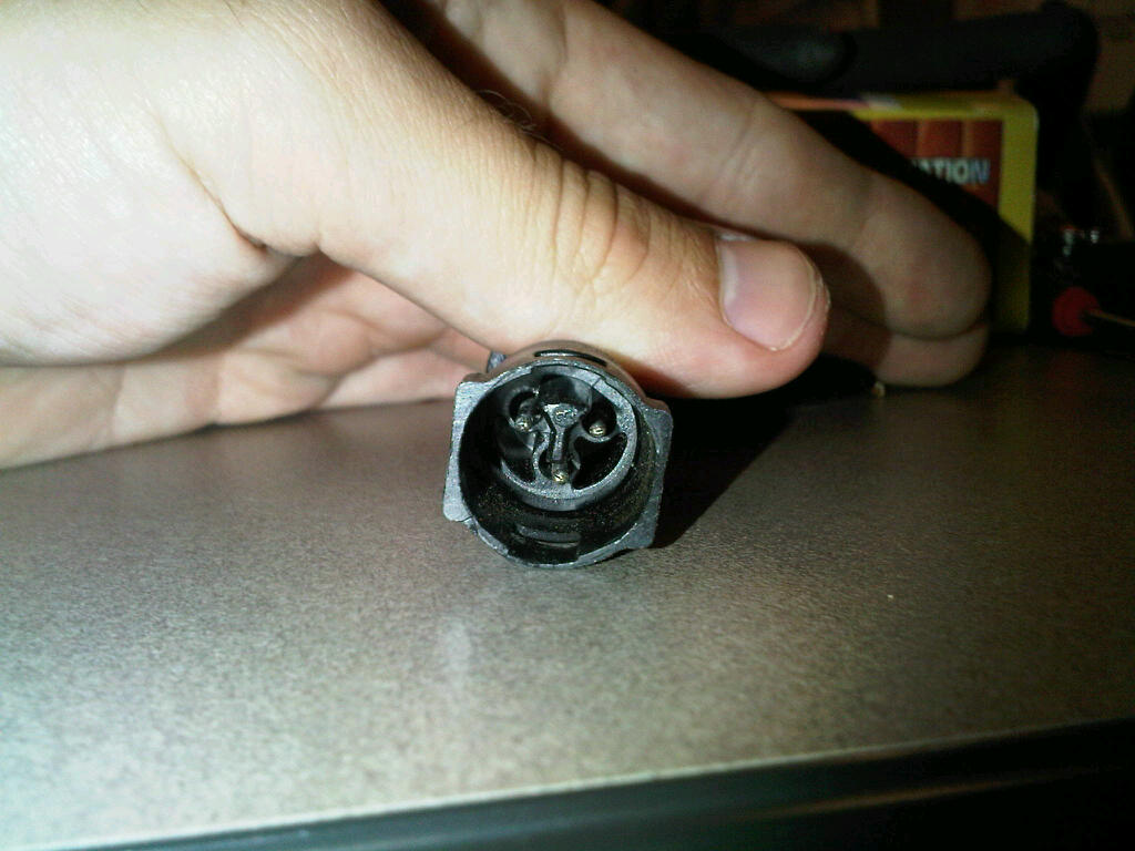

3 It has a single wire O2 sensor but I found a black wire with a 3 pin connecter
that looks like it could be an O2 connecter. It comes from the right front of engine and reaches over to were the O2 sensor is. Would a 1985 have a heated O2 sensor?

PostPosted: Wed Oct 03, 2012 10:46 am    Post subject: Reply with quote
What is this for?

redlinedave wrote:
What is this for?
Looks like the diagnostic plug I mentioned. Never found a use for it myself.

PostPosted: Wed Oct 03, 2012 3:56 pm    Post subject: Reply with quote
That plug looks kind of like what connects into the idle stablizer for the 1.9L. But the edges seem a bit more rounded on yours.
Check if there is female plug hanging around they can both plug into each other but should generally be plugged into that little box on the side of the firewall. I think I see it behind the fuse box in your picture. Do you already have two plugs in there?
