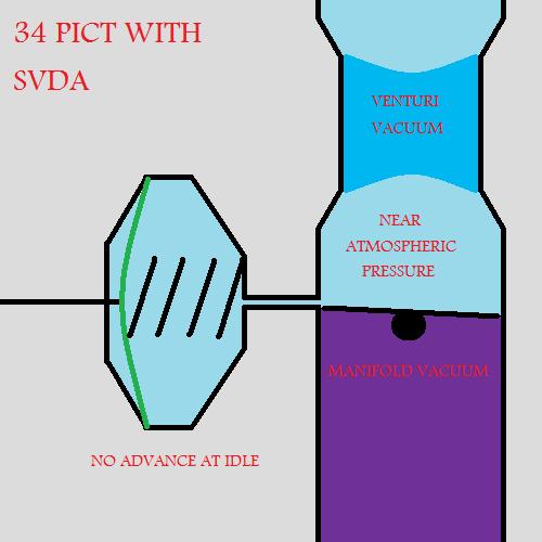

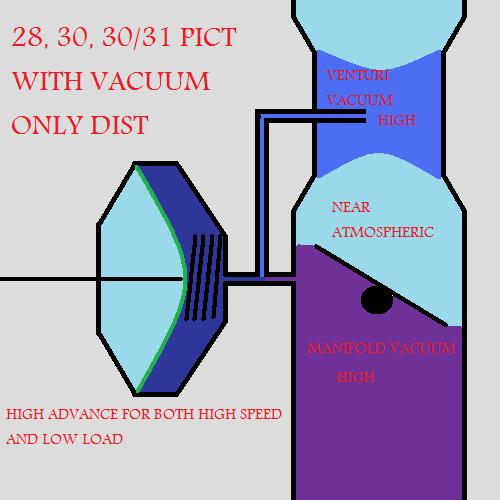

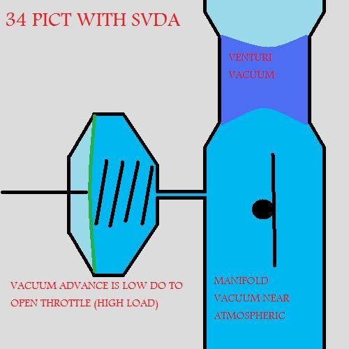

PostPosted: Mon Mar 19, 2012 10:49 pm    Post subject: Reply with quote
Here are some diagrams I drew. They are not to scale but serve the purpose of depicting how these systems work.
First is a 34 PICT although the 31 PICT and fuel injected modles work the same. Notice how the vacuum advance does not respond directly to engine speed. It's sole purpose is to provide vacuum advance in compensation for low load. The centrifugal mechanisms in the SVDA and DVDA do all the compensation for engine speed.
When idling and starting the vacuum advance mechanism does not advance. In fact with the DVDA it even retards it a bit more. This is mainly for emissions but also helps the vehicle start. All gasoline engines start better when the ignition is close to 0 degrees TDC since there is less back pressure during the end of the compression stroke that could stop the engine. For this reason the port (or ports) are located just above the closed throttle plate. This provides atmospheric presure that can't advance the distributor.
Next is the 34 PICT while you are just lightly cruising along. The low load on the motor can withstand much more ignition advancement, perhaps as much as 45 degrees, to produce more power with less fuel. For this reason the design of the carburetor causes the port to pass onto the manifold side of the throttle valve once it is open. Now the distributor can "tell" how much load is being put on the engine and compensate so that it advances with the lower load. The restriction of the throttle plate causes the vacuum that lets less fuel and air enter the engine and therefore lowers the load on the engine.
Now let's see what happens when you floor it. The engine would ping or even knock if it were as advanced as the part throttle position above. But the open throttle reduces the vacuum being fed to the diaphragm. Remember that the mechanical advance in the SVDA and DVDA is still advancing the ignition at the same time, but only in relation with engine speed. The vacuum advance is strickly for load compensation.
Now as you can see this has been the part that those mechanical advance only distributors, like the 009, don't accomplish. They are like an SVDA that is stuck in the high throttle or idle possition. Both 009's and SVDA's have mechanical advance. But only the SVDA has the vacuum part of it too. Sure they run, but they are less efficient unless you have to drive around at full throttle anyway.
Now let us look at the pre 1971 carburetors and distributors. They are different for the fact that they don't have mechanical advance. The whole system works on vacuum, both for speed and load compensation.
These carburetors when at idle are much like the SVDA and DVDA in one respect, they are not advanced.
Now when you step a little on that accelerator the same thing happens as with the SVDA and DVDA's, the port is now on the manifold vacuum side and so advances the distributor. But wait. The engine is not at high RPM's at the moment. This causes a low vacuum in the venturi. The combination of high and low vacuum cause the distributor to find its happy spot.
Now what happens as you pick up speed. The combination of a low load and higher RPM's will allow for even more avancement. Since there is no mechanical part of the distributor to do this it must do this by adding more vacuum. Since the speed is even higher the venturi is going to be causing a lot more suction. The high vacuum with high vacuum causes... well... high vacuum.
Now what would happen if you floored it at these high engine speeds. Although it would need some advancement for the higher RPM's it wouldn't need so much for the quicker flame caused by the higher load, that is the open throttle. Now we have a combination of low and high vacuum so now the timing finds itself somewhere in between again.
Now last but not least what happens if you lug the engine? Your engine speed is low and your load is high causing a high flame speed. You don't need very much advancement at all. But these two conditions conveniently cause two low vacuum signals. Walah! very little, if any, advancement.

Where they fall short are in the other aspects of combustion WRT ignition timing.
1) a hot engine will have faster combustion than a slow one. This is seen with an engine that only pings when it's hot. The timing is fine for a cooler engine, but is excessive for hot engines.
2) combustion speed also depends on LOAD. Load is "how full the cylinder is with air and fuel). WOT (full load) requires less timing, since a full cylinder has more pressure (HEAT) when compressed.
For example, at idle the throttle is closed. The only air being admitted into the air is via the idle circuit, a puny passage in the carb, and what is bleeding around the throttle plate. While the compression RATIO is unchanged, the actual amount of air being compressed is very small. So "Pressure" is low (relatively), and combustion speed is slow.
But as the throttle is opened, more air (and fuel) is entering the cylinder. This is being compressed the same amount, and temps rise. The more air the more pressure, which means more temp (pre combustion, NOT engine temperature). The more temp, the faster the combustion process (it's actually an oxydizing process for you chemistry geeks). Basic chemistry teaches that every 20C increase in temp (of reactants), doubles the speed of the reaction.. The faster the reaction, THE LESS IGNITION TIMING THAT IS NEEDED. Looked at another way, MORE IGNITION TIMING IS NEEDED UNDER LIGHT LOADS.
Centrifugal Only distributors only change timing based on RPM, they have no load sensing capability. Vac advance senses load, and load timing changes.
Right here you should understand that cruising at light throttle will require more timing than driving WOT. So where does this extra timing come from? If you have a 009/010/019 or other centrifugal only distributor, you are SOL! So the best distributor will change timing on RPM AND LOADS!!!!!
Where people get further confused, is because IF you are running a centrifugal only distributor, you time it for "worst case", which is WOT. If you go more than this is may run great at part throttle, and maybe even WOT when not hot, but at some point the engine will have too much timing for how much air is being let in, and how hot the engine is, and it will ping. Eventually it will be damaged. So the rule of thumb is to time these for "worst case", which is full throttle, which is the LEAST TIMING. That's where the 28-32 "rule" comes in. That rule always applies, even if you have vacuum advance. But the rule does NOT apply to part throttle, which is where the additional timing of vacuum advance will actually kick in. This is because at Full Throttle there is no manifold vacuum to pull any advance in anyways! So vacuum advance has the additional benefit of "load sensed timing adjustment" that is not possible with centrifugal only distributors.
if some asshat is timing, or telling you to time, a vac advance distributor to 28-32 total timing, they have no clue what they are doing and you need to find another "mechanic", because we have no idea what other false information they are working on your car with!!!!!
PS: Combustion speed is also why engines that are "rich" need more timing than engines that are leaner (leanER, not LEAN). Rich A/F's are very cool (pre combustion), and flame front propagation is relatively slow, so the engine needs more timing to get out of it's own way).
