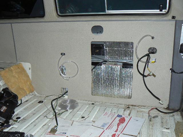

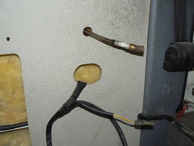

Here are some pics for the next person that may be helpful showing how the lines are routed. I agree the clips are not a big deal, if you even remove the cabinet, you can secure and clean up everything behind there.
The one caution, though is be prepared to break the faucet in the process. The plastic is brittle with age and the pvc hose hardens with age and mine broke. That's o.k. though, then you can get a new upgraded faucet with a variable flow.
